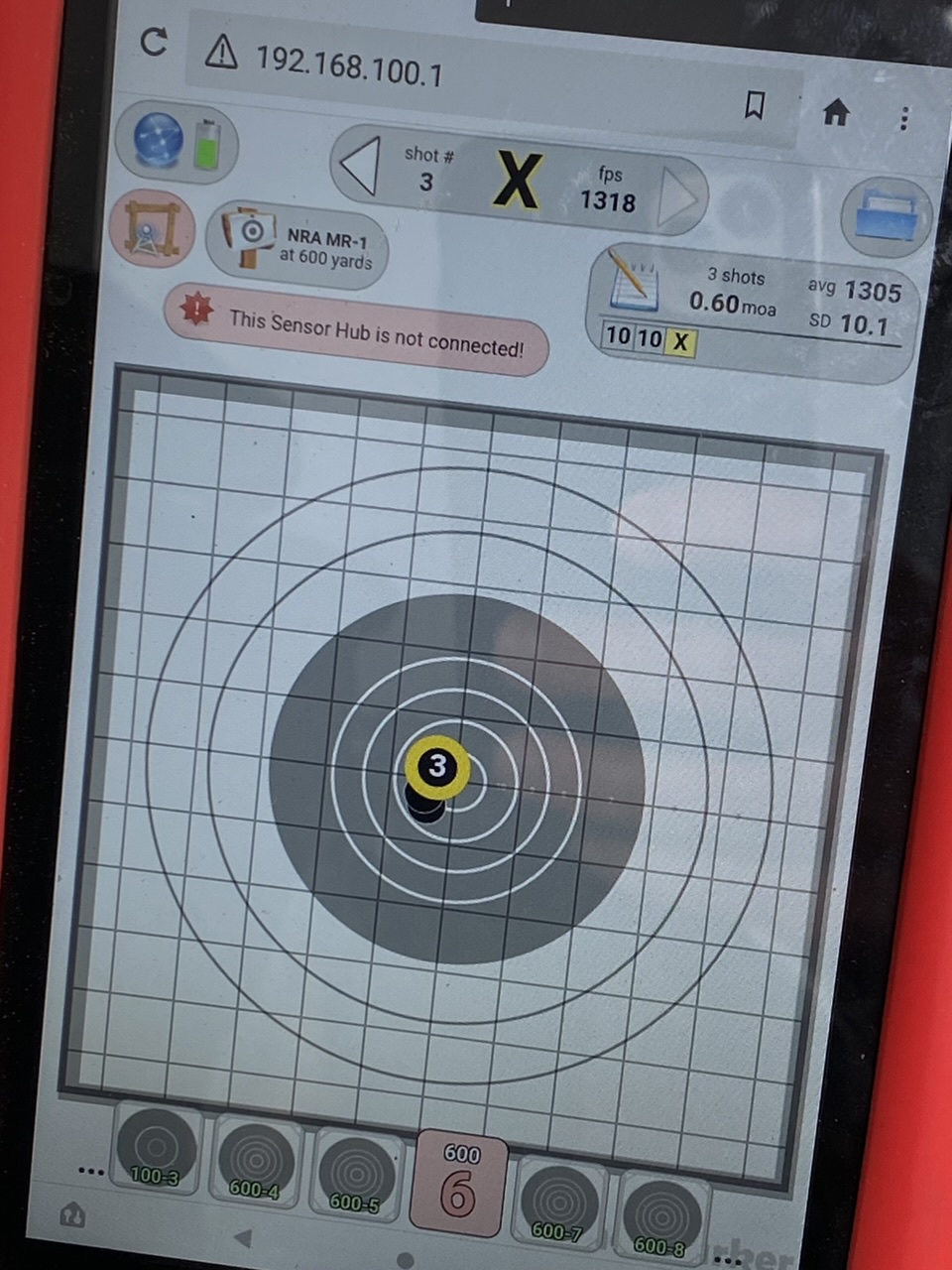

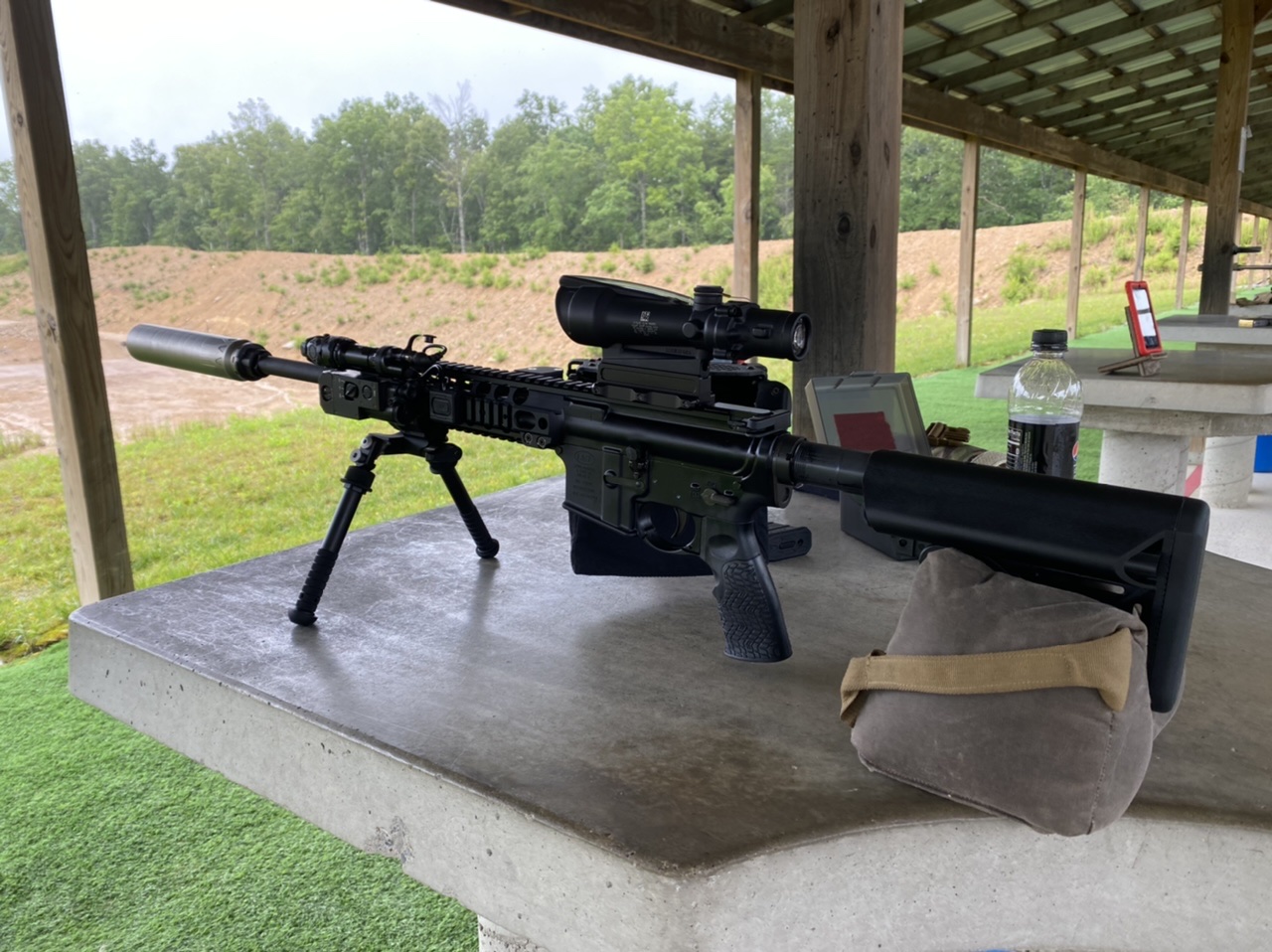

I'm running StaBall Match, Lake City Brass, CCI primers, and 77 SMKs to 870 consistently with my Mk12 mod 0. My buddy is doing the same with 77 Noslers.
