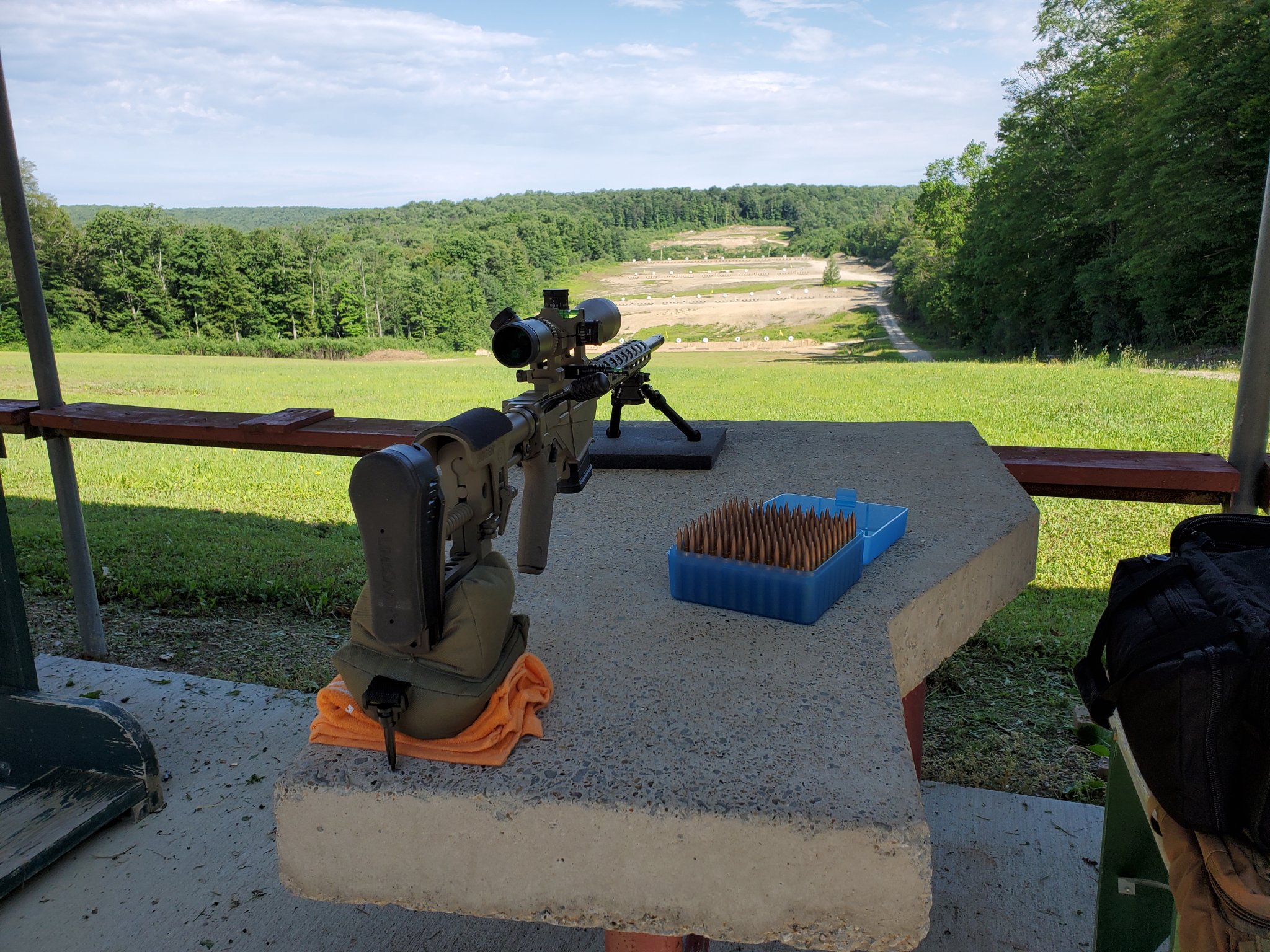

    Just got back from Ridgway PA. My Vortex Viper worked just fine and I had no issue seeing / tagging iron coyotes at 1000 at less than 24x magnification. I shoot a local benchrest league and that extra magnification comes in handy.

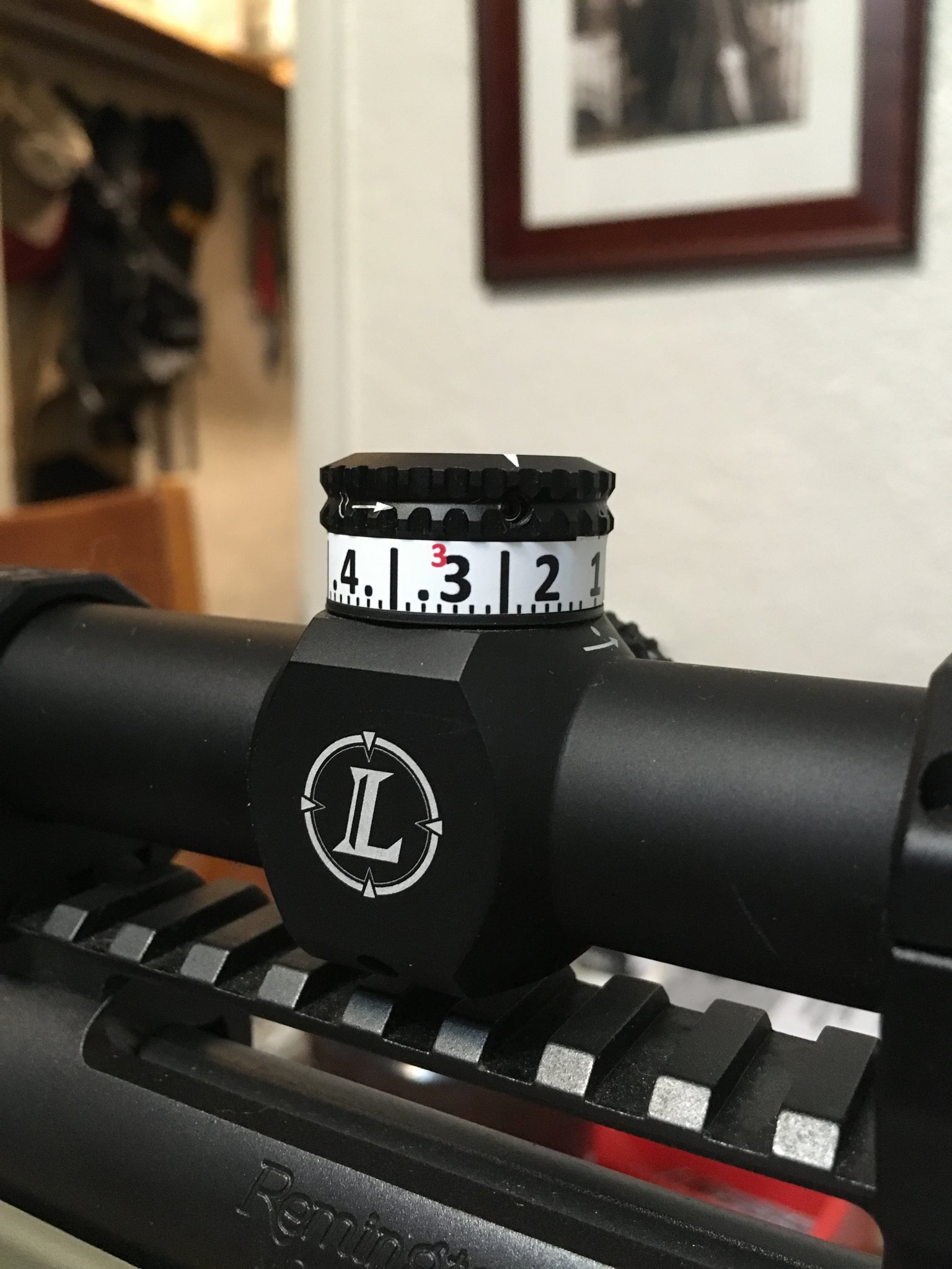

    On my hunting rifle I use a label that is black numbering on a white background from https://customturretsystems.com/
    The difference in ability to see black on white is outstanding. The labels are great qualty and outstandingly accurate. You’ll forget its a label. I am planning on doing the same on my PST Gen 2 but just mimicking the mil graduation as apposed to yardage on my hunting scope.

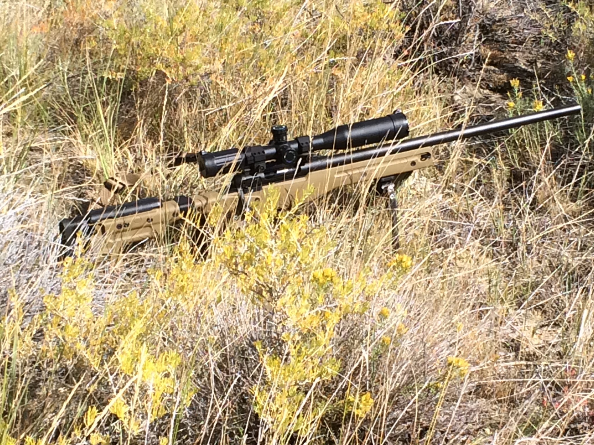

    Mine was mounted on my "that gun shouldn't shoot that good".... super classy Sáváge 10FP, 26" in a Bell & Carlson Medalist Tactical stock. That rifle could do no wrong with 175 Matchkings just off the lands and IMR 4064.
    Mine was a Savage 10fp 24” shooting 155 Lapua Scenars at 2902 fps. In the end it was in an AI chassis with a Razor Gen 2. Smoked the barrel around 5k rnds and went to 6.5 cm.

    Working with a budget, but get you all the features you are needing, except FFP, I would highly recommend an Arken Optics 6-24x50mm MOA to you. They can be had for $449!!
    My understanding, they have those in stock right now. I have the 4-16 version, and it is simply badass!!
