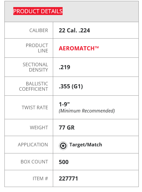

I believe the Hornady bullets are the newer "Aeromatch" line. This is for the cannelure version.
Screenshot 2025-06-11 at 11-49-50 22 Cal .224 77 gr HPBT AEROMATCH™ ‑ Hornady Manufacturing Inc.png
Reactions: Whitlock
Interesting. If that's the case then it would seem the BC is different from what Black Hills told me at .361
Now it's possible that Hornady is making a 77gr SMK clone specifically for Black Hills and that it's slightly different from the Aeromatch line. Maybe we need to give Hornady a call and see what they say about it...

For the .224 Aeromatch bullets we make cannelured and non-cannelured versions of 69 and 77gr. That is all. Published G1 BC's are always to be taken with a grain of salt. .355 vs .361 is within external factor variation (i.e. what barrel they're shot out of or what powder is used even).
