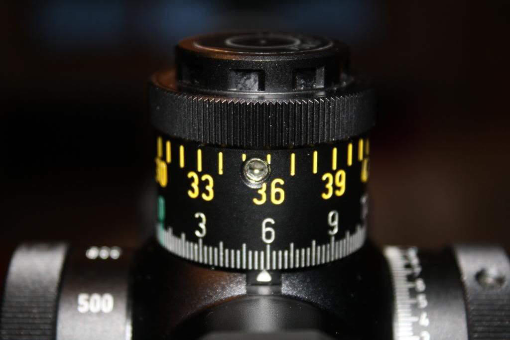

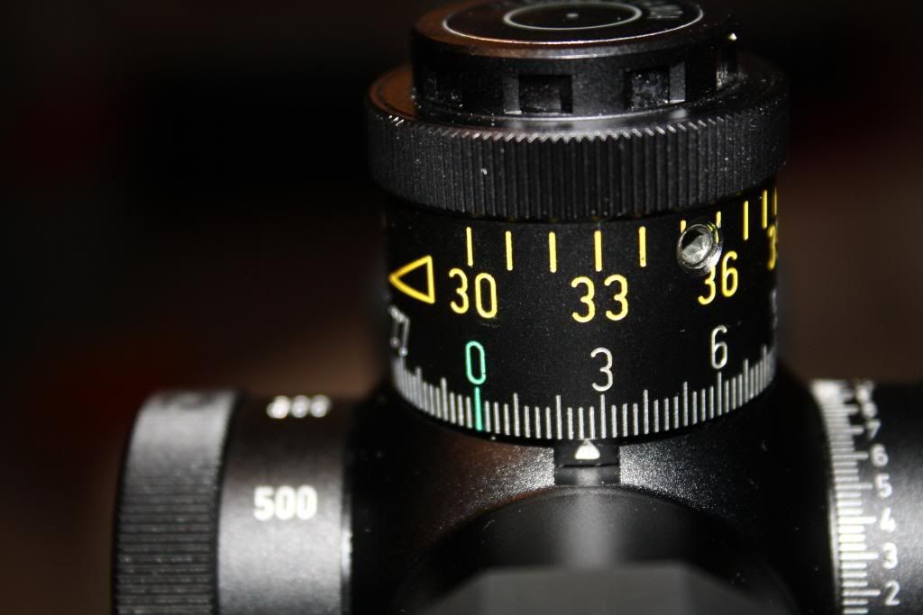

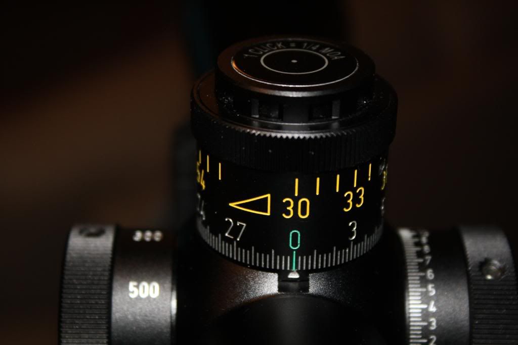

I have had a few guys respond and no one has figured this out. This is my final attempt before sending this off to Schmitt and Bender. I went to the range and zeroed this scope. I then dialed 6.75 moa into the elevation knob so I could hit my 500 yard target. I hit high. This is unheard of considering I have tested this rifle and it’s a 1/2moa gun. I then counted the clicks to get to 6.75moa. Instead of 27 clicks I had 32. See picture. If I dial 4 clicks or 1 moa I am only showing .75 moa and so on. For some reason the knobs don’t match the click values. This is on elevation and windage. I spoke to the last owner and he said he hasn’t had any issues.
I have had a couple guys pm me thinking that I somehow got a mrad scope with moa knobs so I set it up on my counter and put the cross hairs on the hill side. I dialed 14 clicks or 3.5 moa and the mildot covered spot that was originally covered by the crosshair. I then dialed 7.25 and the second mil covered the spot that was covered by the cross hair. I know this isn’t exact but I would believe that the scope is traveling in moa. I also adjusted the scope all over and returned to different numbers and the repeatability was there. Check the picture and see if any of you know what’s going on.
this is where i started
this is what it looks like when i count 12 clicks or what should be 3moa
this is 8 clicks or what sould be 2moa
this is what i have to dial to move my zero from 100 to 500 this should be 6.75 moa as you can see its not following the turrit.

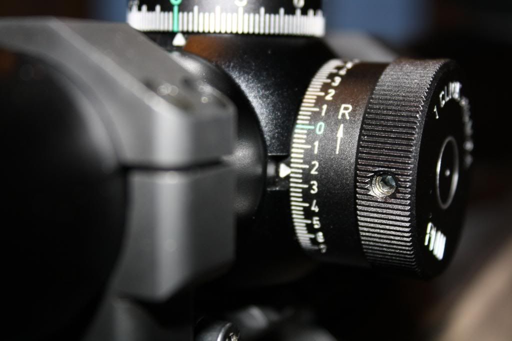

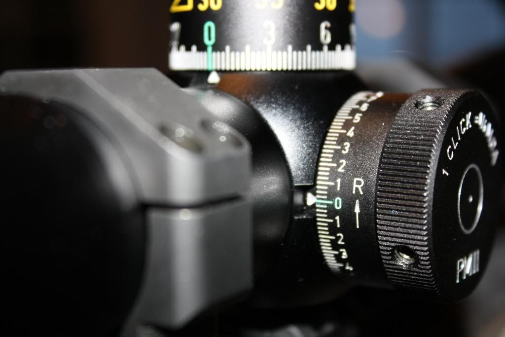

i also checked the windage and heres what i got
this is where it started
here is what i got when i actually dial in 8 clicks or what is supposed to be 2 moa

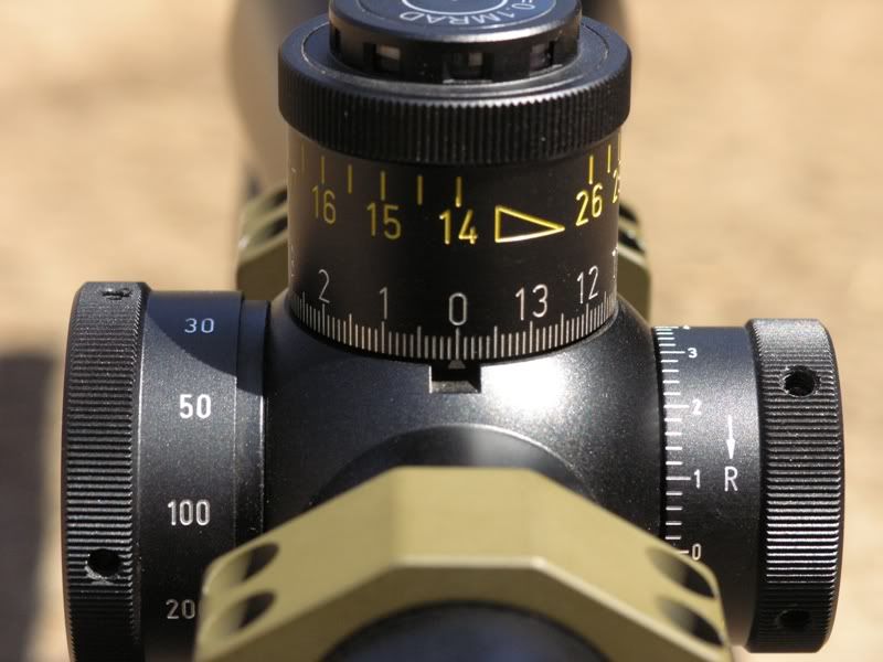

If it helps the OP any, here is a visual comparison of MIl vs MOA at the dial, disregard the CW CCW. Sounds like you do have Mil click spacing under MOA caps.

If you've got the patience, count your elevation clicks per one revolution. 140 clicks for the Mil, 120 for the MOA, or 70 & 60 at your 15 MOA indication.

My guess is "You have MOA caps on metric turrets." While your cap values are in MOA, your "click" values are in 1 cm at 100 meter units. If you do the math you'll see why you are shooting high.

If you reticle is in mils (does S&B even make a moa ret?) and they find out the turret internals are mil also, just have them put mil knobs on it and send it back, instant mil/mil!

The OP has MOA turrets that aren't jviving with the clicks, and the supposition is that he got MOA knobs on Mil turrets.
