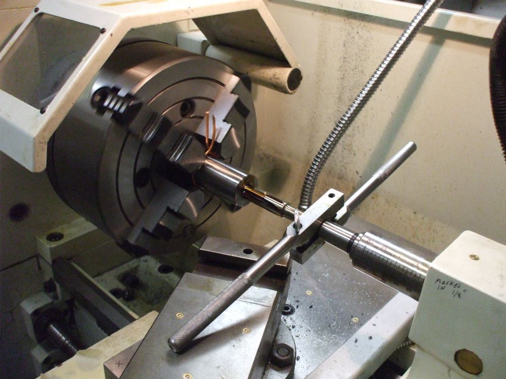

Lathe Lothar Walther barrel 7mmMag reamer held with tap wrench and Sulfered cutting oil on reame.jpg
I use a home made tap holder that rides on a low compliance surface, the compound [to prevent chattering], but I lift it up occasionally with my finger to verify the toque is low [to prevent dulling and eccentricity] as a feedback loop on how fast I can advance the tailstock. I push the reamer with a modified #3 Morse taper arbor.
I learned the torque part from the late gunsmith Randy Ketchum, who had a 12' lathe. His lathe was so big he put a piece of shotgun barrel over the tap handle and ran it along the ways. Then he lifted the barrel every few seconds for a moment to feel that the torque was still low. Randy could communicate with some great gunsmith like Beginski, or some putz like me. He is missed.
I learned the modified #3 morse taper pusher from Mike Bryant's web site ~ 2002.
