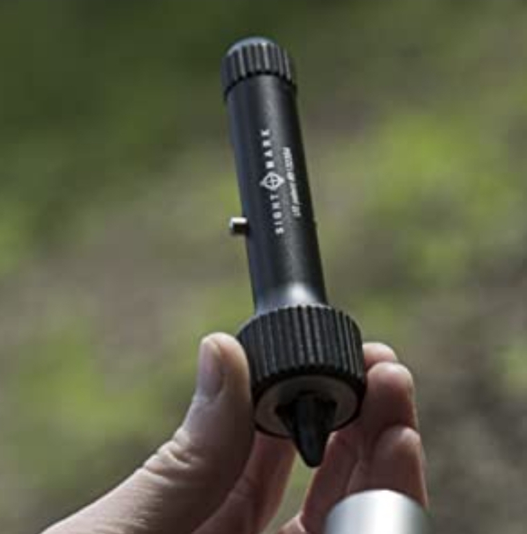

Sightmark universal boresight.
Wait until dark and with the lights out in the garage sight it in on tree down the block. Gets within 12".
i have one of these and it has worked for a variety of guns where you cannot "look through the barrel".
