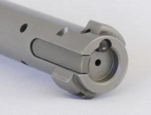

I am looking into the new 224 Valkyrie in a bolt rifle. Not many available here in Norway so far....
I do notice that the Howa Mini-action in 6.5 Grendel might be a good choise for a build.
The 6.5 Grendel cartridge has a rim diameter of 11.2mm (0.440"), the 224 Valkyrie has 10.72mm (0.422").
So cartridge body diameter is only 0.5mm (0.0197") smaller in the Valkyrie, I think it will fit in the Howa magazine, and feed properly.... hopefully....
Also, the 6.5 Grendel extractor will most likely grip and extract the 0.25mm (0.0098") smaller (radius) case rim of the Valkyrie round.
The bolt face cutout diameter (in the mini-action 6.5 grendel bolt) for the case head is 0.5mm (0.0197") too large for the 224 Valkyrie case, but as the sideways support for the case head in the bolt is not the main task of the bolt cutout (only headspace is), it should not be an issue as far as i can tell......
I measured the cutout in my Bergara HMR in 6.5 Creedmoor, and the cutout diameter in the bolt face measured 12.25mm (0.311") and the case head rim is 11.97mm (0.471"), so it indicates that sideways support of the case head is not the purpose of the bolt face, only headspace is.
I will ask a smith about this, but as long as headspace is set up properly in a new barrel, and the rear end of the case is supported properly by the chamber, I believe this can work just fine.

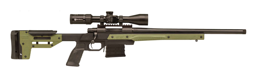

I have found the MDT Oryx chassis will fit perfectly. It is available for the Howa Mini Action:
Barrel: I am looking to have a smith fabricate and install a Lothar Walther 24" barrel with 1:7" twist.
You may want to consider opening a .223 boltface to the proper diameter. You're going to have extraction issues with the larger bolt face.
The easiest answer is a savage rifle if available, purchase a 6.8 bolt head.
Other option is a remington plus an aftermarket bolt. ITAR difficulties apply.
Third option is to skip the valkyrie and build a 6mm ARC off the howa.
Yes, you might be right. All though the spring loaded ejector is pushing against the case bottom, the case might slide sideways out of the extractor when the case is extracted out an inch or so. The 224 Valkyrie case is pretty cylindrical, but it might slide sideways out of the extractor grip......
It is probably wiser to use a 223REM Mini Action as a base and open the bolt face. If the extractor on the 223 bolt is different than on the 6.5 grendel version, one might grind down the tip of the 223 extractor or buy a new extractor used on the 6.5 grendel bolt. One probably needs a new magazine for the MDT Oryx chassis anyhow.....
I did find a picture online of the Mini Action Bolt Face, it is of the 223REM version I believe:
