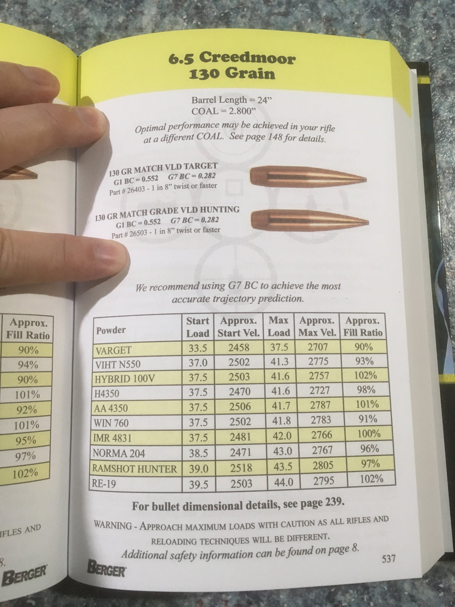

According to Berger, the max charge for this bullet is 41.6 grains of H4350. By all indications, that load was developed by them in Hornady brass, not Lapua. Lapua is thicker and less roomy than Hornady, so that max load would be slightly less still.
According to Berger, you are almost 2 grains over max.

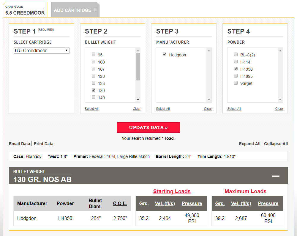

Any chance you could send me where you found that data? Everywhere I look (Nosler, Sierra) says that 43 grains is the max load for a 130gr bullet.
Thanks!
http://www.hodgdonreloading.com/data/rifle
7063604
Its a different bullet and they are usually semi conservative but I have also had them be pretty damn spot on more times than not.
