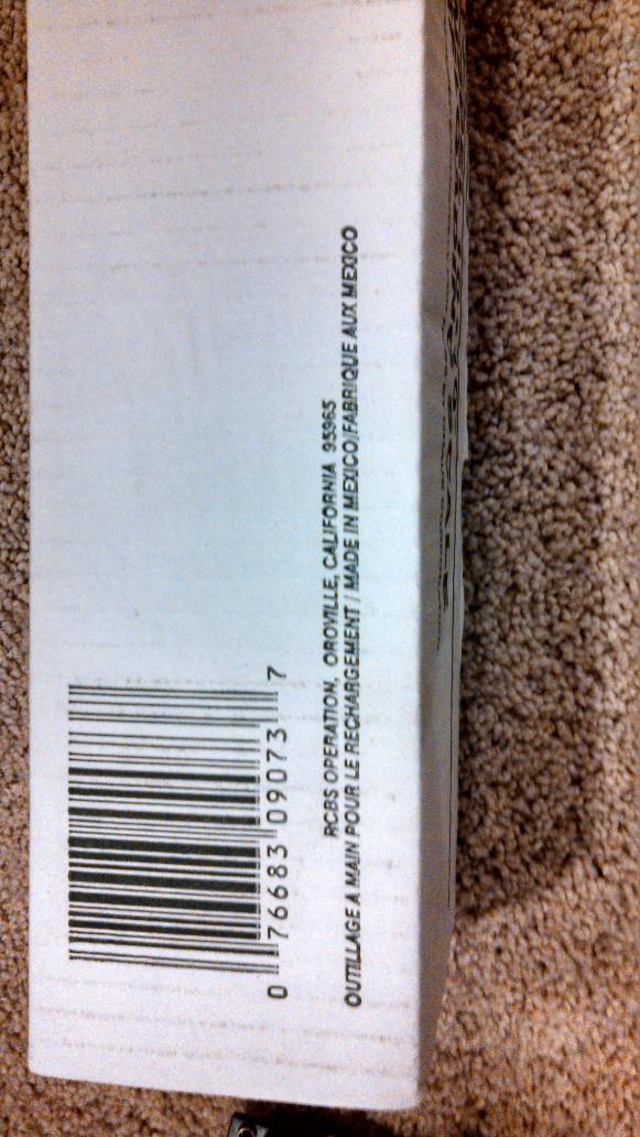

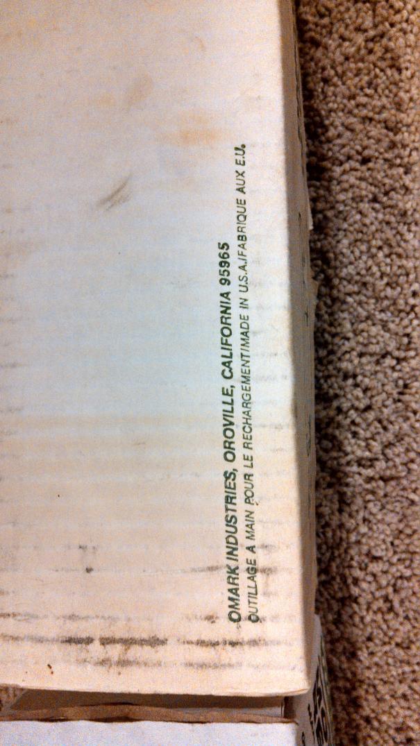

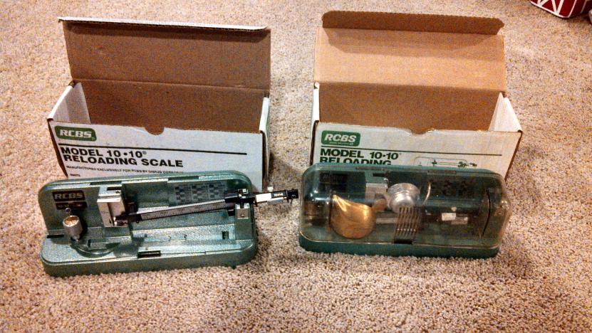

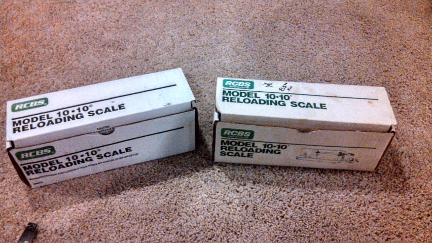

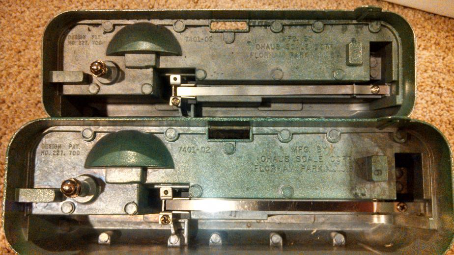

Wrong, at least on according to my two 10-10s, the photo loaded below is exactly what my 10-10 says the was ordered from midway, but the factory box it shipped in read made in mexico, my other 10-10 reads the same stamping on the scale itself, but the box says made in USA, id be happy to upload pictures if anyone would like them for a reference.
I guess I can upload pictures from my cell, sorry for poor quality. If you can see, both the stampings are the same for each scale.

Has anyone confirmed with RCBS? Considering the base says MFG by, not MFG in. The only places I see the made in Mex is on the box and printed in Mex in the instruction manual.

I sent RCBS an e-mail a while back and they responded that the 10-10 scales were made in Mexico for a while but are being made in China now. It is my understanding that this happened after 2000 but I can not confirm the date for sure. I do know that if it is stamped on the bottom of the scale manufactured by Ohaus Scale Corp Florham Park N.J. U.S.A. It was made here in the States if it was prior to 2000. Stingrayguy, did you purchase both scales new? If not this may explain the "box" situation.
