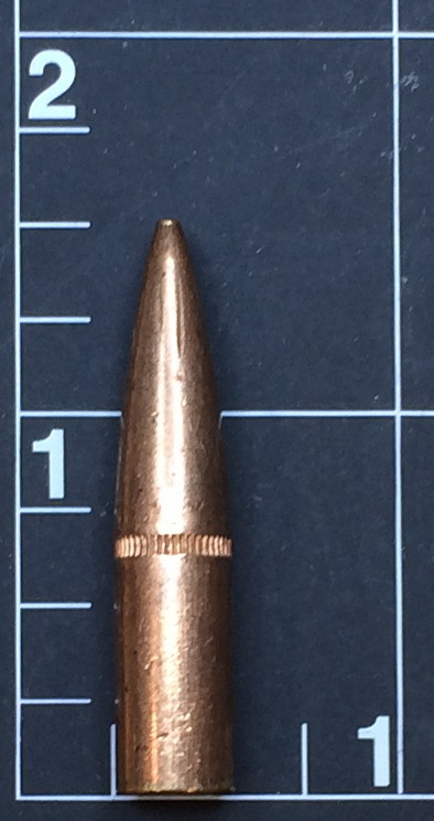

I've been using 220gr OTFB bullets (attached) for subsonics and (not surprisingly) they're just as accurate as premium BTHP pills. But I can't figure out what mil-spec cartridge they might have been pulled from: AFAIK, .30-06 never used open-tips and .300WM was always loaded with boat-tails. Anyone know what might have used these OTFBs?

This ^^^^^^^^^^^^^^^^^^^ Take a look at the cannelure. That will tell you what it came from. See if it fits OAL for a .300 Blackout. It probably does.

Ah ha: Good finds! I don't doubt that for subsonics the flat base doesn't hurt ballistics significantly, but it doesn't help, and it's still an open-tip bullet. Is it so much more expensive to put a boat-tail on such a bullet that it could be cheaper to produce flat bases (even given that the 220gr open-tip boat-tails are produced in large quantity)? Or could there be some other benefit to the flat base in 300BLK? (For subs it's not a powder volume problem: there is room to spare even with a BTHP seated to just 2.15".
Flat base is shorter. A flat base would be easier to stabilize vs a boat tail.

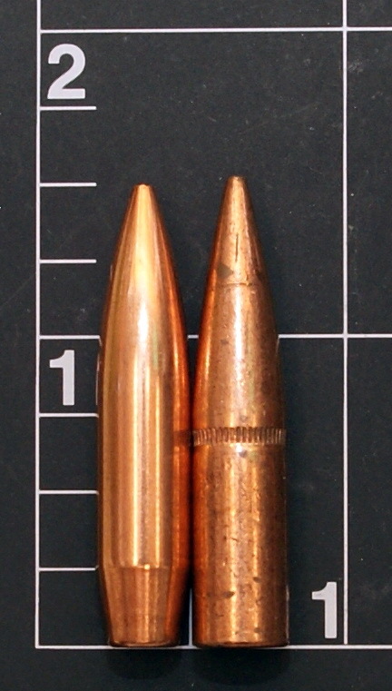

Would make sense, except it's the same length as a 220gr SMK (see photo here).
I do believe it's from a subsonic 300BLK run: Seating to the cannelure results in COAL of about 2.15", which was Remington's preferred subsonic length.
Still curious what possible advantage the flat base provides....
