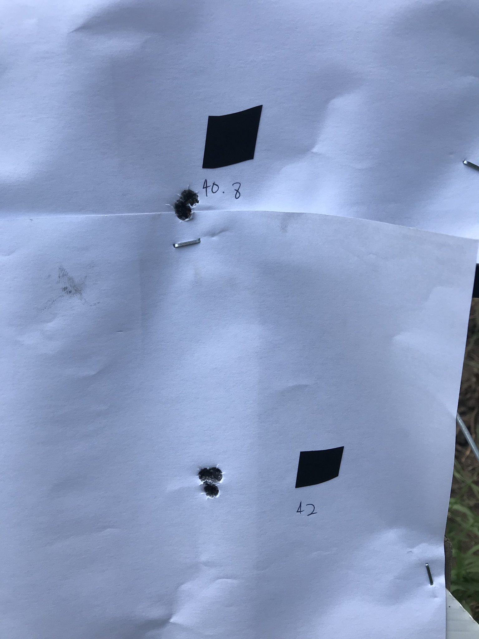

@Potss not a PVA but I have a Tikka with a Bartlein in an XRay. Got it in a trade while i wait for my nucleus and origin. Thing flat out shoots. Super smooth especially when you figure the price. Never have an issue with feeding or extraction. Super accurate. Chassis is great I expect bravo to be the same. Trigger with a yodave is great.
No groups to show. Rifle has never shot a 100y group but it performs in matches even if I can't.

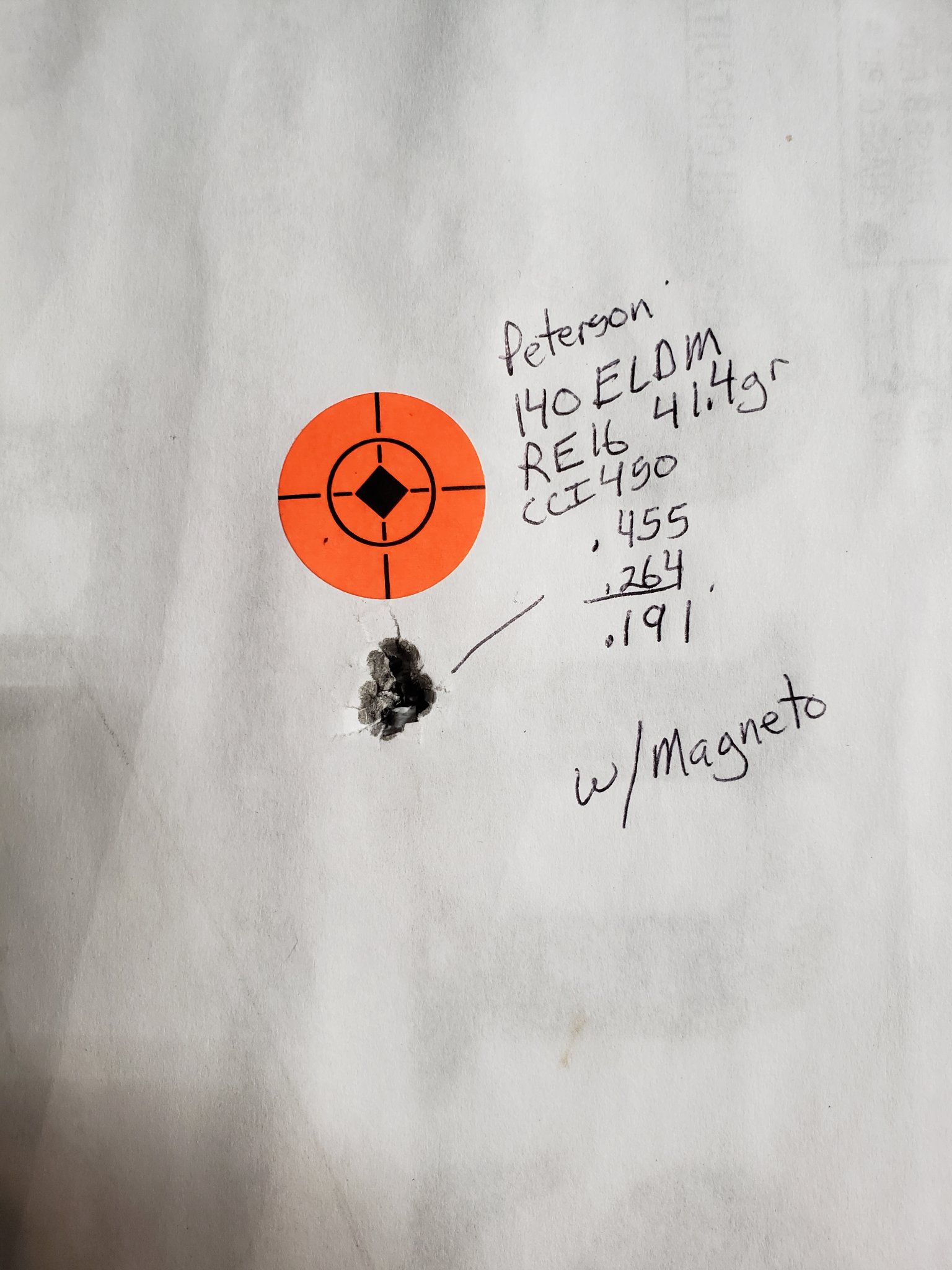

This is a CTR with a Bugholes prototype 23.5" Bartlein in a German Gun Stock Predator. I was testing the 140 ELDM over my 140 RDF load. 2858 fps, SD 6, 5 shots. I think I found my load. Factory trigger is 1 lb 10 oz and I picked up 2 used magazines for $60 and $70 each shipped. If I were starting now, I would seriously consider a Bravo.
I also have a .223 Varmint using CDI bottom metal and MDT mags. I am shooting 75 grain ELDM's 2995 with H4895. The factory trigger with the Yo Dave spring is very similar to the CTR trigger.
