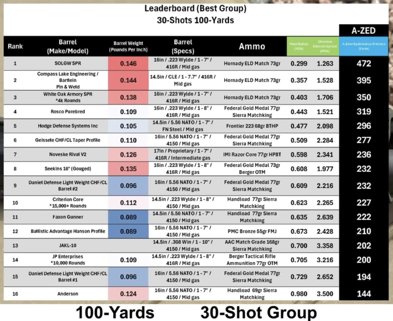

I agree…but SOLGW def has some special sauce for their SPR barrels. 0.3” mean radius with a 30 round group with factory ammo is pretty insane for a gas gun. Beat out bartlein, criterion, etc by a wide margin.
Reactions: Redlion
This is from that guy, Preston something or other, right? Yeah, I like the guy's videos, but take his leader board with a grain of salt. Each barrel is a sample size of one. I suspect that if you based the board on the average of ten of each barrel, the results would be different.

Not crapping on SOLGW at all. Apparently they make good stuff...but sample size of one. Some guys have even got good Faxons over the years...
I've tried a lot of different barrels over the years and have found that, usually, if you go with quality you usually get what you want. Pick one and go with it. No matter what you get, you will always run the risk of getting a dude.
100% agree. Prestons work just gives you a semblance of a baseline between barrels. No one is lemon proof. Im currently working through a 16” criterion core that just refuses to shoot the components i have the most of (77smk + tac), at best its like 1.5” in 10 shot groups (my geissele chf 14.5 hammers with this combo around 1” all day). I will def try different bullets, powders, etc bc sometimes barrels just dont like a particular combo but im damn frustrated lol! Im also putting it on a different upper/handguard combo (vltor + solgw m89 rail) to see if that helps (it didn’t shoot well on bcm demo upper + KAK handguard). When I really want to test it I will load up some berger 77 otm and n140 and if it can’t shoot that then I will prob reach out to criterion
