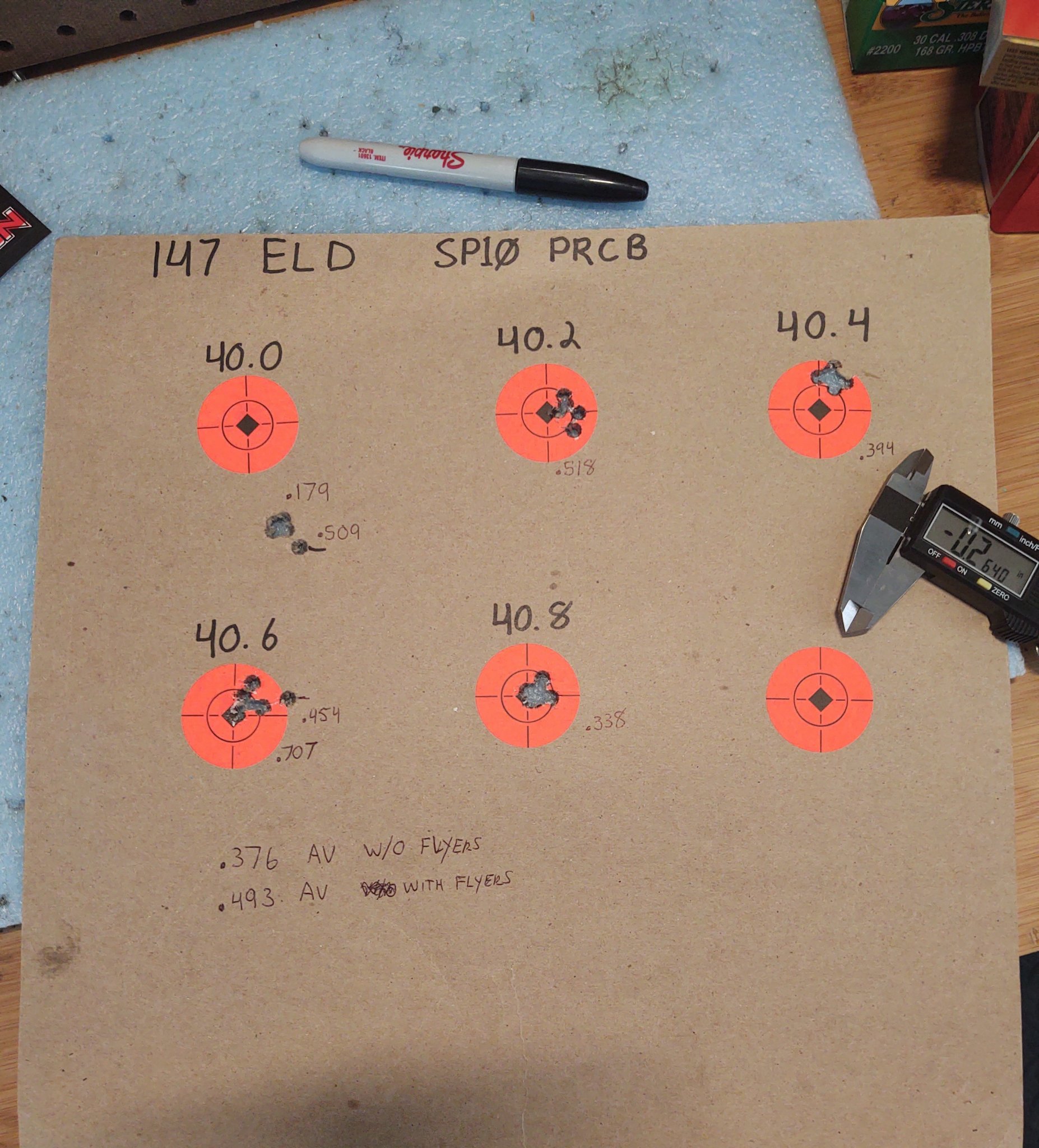

This is from my SP10 with a Proof Research 24" 6.5CM CF Barrel..
It averaged Sub Half MOA during fucking load development..
Reactions: sethrrows
Can't speak to RA but both my Proof barrels will shoot .5-.7 5 shot groups consistently with a couple factory ammo options provided I don't fuck it up.
