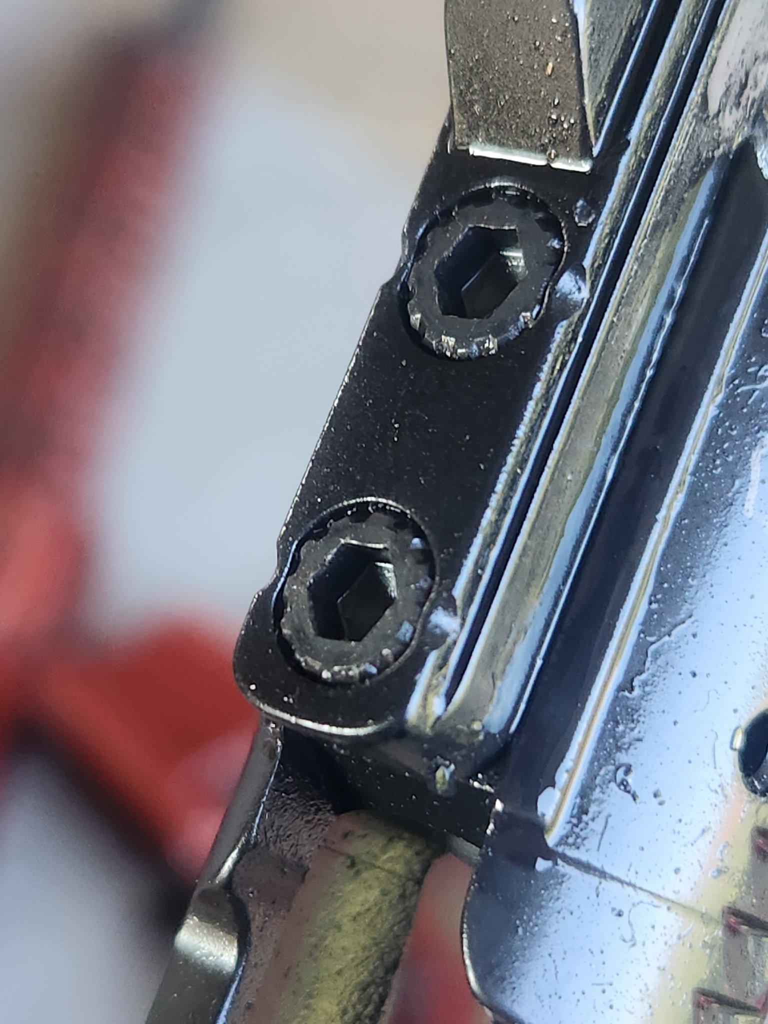

My Seekins Select AGB came pre-stripped/cross-threaded from the factory.
Well the good news is this thread reminded to call seekins about that and after a 5 min call I've got two rebuild kits heading my way. Great customer service but I'll probably still make the switch to SA

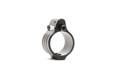

If you were looking for .750 adjustable gas block you missed out on the best one..
I have been running these in some light weight large frame builds and these little fuckers are awesome!! And you can adjust how much tension you want on the Detent clicker as well and they have a super slim low profile.
After hundreds of rounds and zero maintenance in .308 and 6.5CM they have NOT carbon locked at all.

Interesting. I didn’t know about these. Good price too. I’m curious how they avoid carbon locking without routine cleaning since it looks like a pretty standard design, similar to the Odin Works blocks but slimmer.
They aren’t on Foxtrot Mike’s website either and only AR15 Discounts seems to have these in stock. I wonder if FM discontinued them.

There's actually quite a few retailers that have them on hand I found three today just doing a Google search.

Would you choose the Foxtrot Mike gas block over the Superlative Arms blocks? How easy is it to disassemble the FM for cleaning?

Yes Id go with the FM over the SLR for a .750 AGB any day, especially since you can buy two FM AGB's and tubes for the price of one SLR.
When I first get any AGBs I usually clean and disassemble them and add some anti-seize to the moving parts, the simplicity of the FM is what makes it so reliable.
To disassemble all you do is remove the detent set screw, spring and detent then just back out the adjustment screw and that's it. I have yet to need to clean or do maintenance on any of my FM AGB's.
I know in your head you think the SLR is super easy to maintain but in real life it's actually a pain in the ass. The leaf style detent spring gets quickly packed with carbon rendering it ineffective to a point you can't even feel the clicks, it is also exposed to the outside elements like dust, dirt and sand. Once the GB becomes fouled you have to disassemble and use a dental pick to scrape out all the carbon, dirt and grime, then lube and Loctite everything back together.
The SLR is also just a restrictive Style AGB, and offers nothing over the FM which has clearly already demonstrated itself to be a more reliable and effective design and a better value, at least with the SA ABG you get a secondary bleed off feature.

I’m definitely tempted to try out the FM gas block after you explained it’s benefits.
I also reached out the FM about it and I learned that they don’t actually manufacture it. It’s made by a company called Icarus Products and is just distributed by Foxtrot Mike.
I wasn’t able to find out anything about the company itself but the FM rep said they have some kind of patent on the detent mechanism.
What interests me the most is the number of adjustment clicks. 24 is quite a bit more than most detent gas blocks. I’m curious how they get so many clicks on such a short screw.
Also, what antiseize compound do you use when you rebuild your blocks? That sounds like a really good idea.
