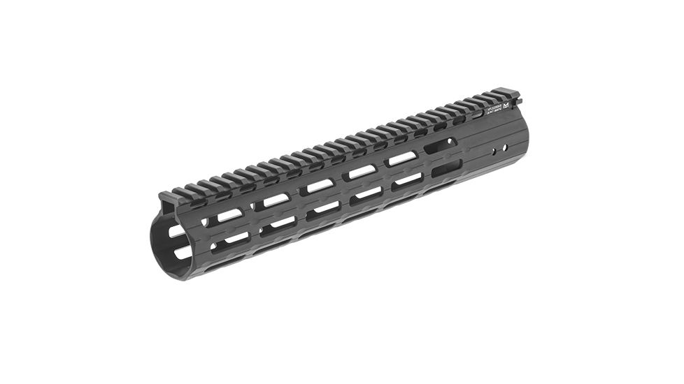

This will bring out the operators and the haters, but UTG Pro makes a surprisingly stout 308 handguard. Some seem to complain about clocking the nut with the bolt on styles, but it will eliminate any rotation issue. As for the Atlas, I've never had a rotation issue with my S-ONE.
