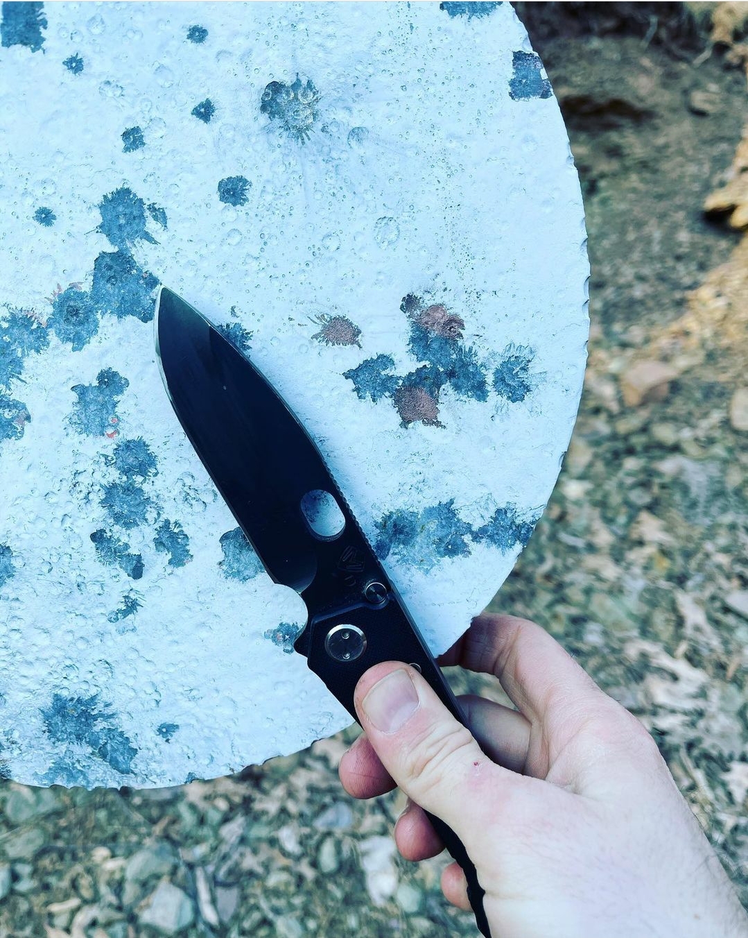

Here's a barrel I cut for a test on a new bullet design.
The barrel had 13 rounds down it when I shot this group with a prototype bullet. No load development, no break in, no nothing. 265 yards
I am sure with even the slightest effort it will shoot even better. This is one of my button barrels
