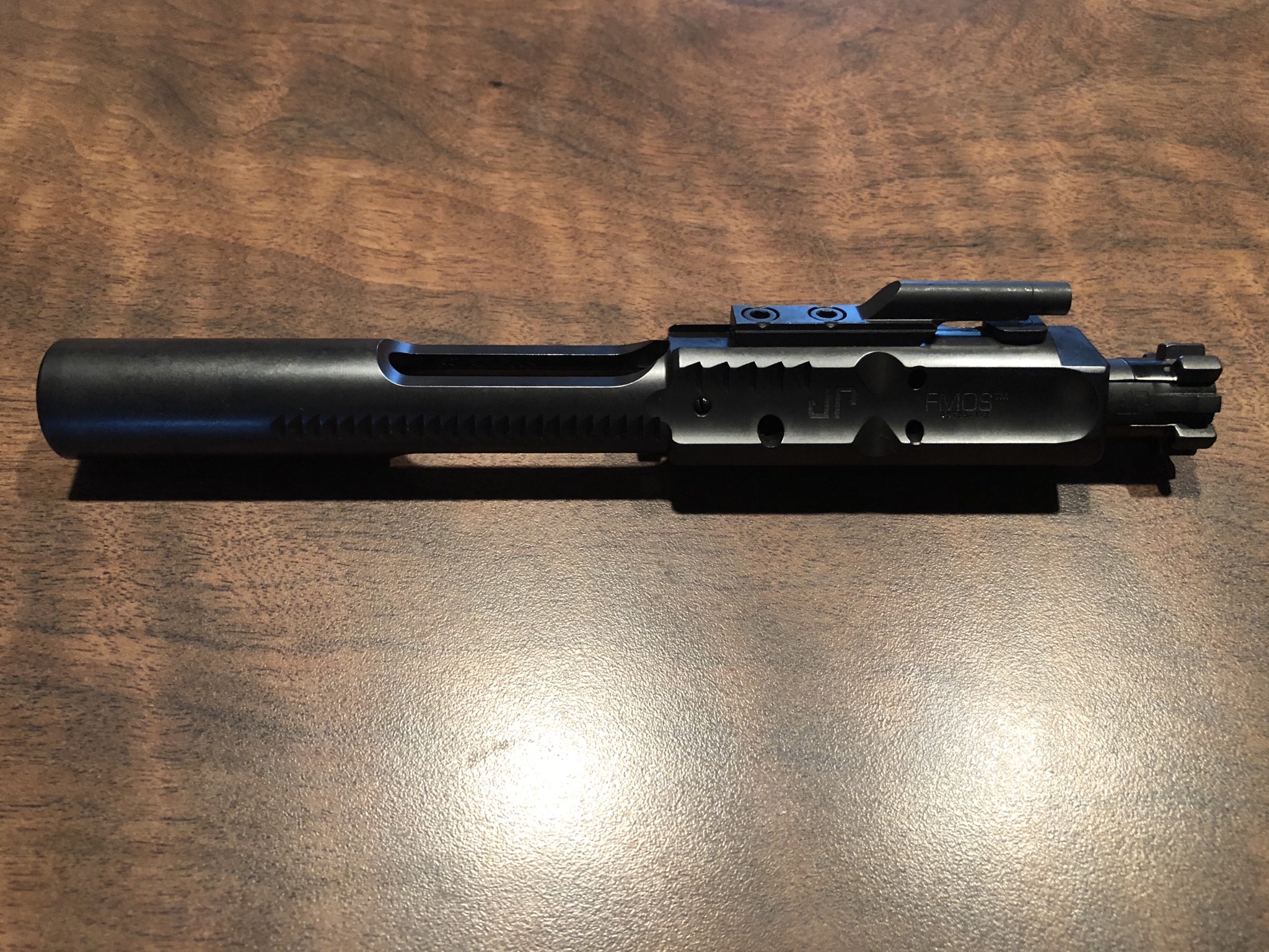

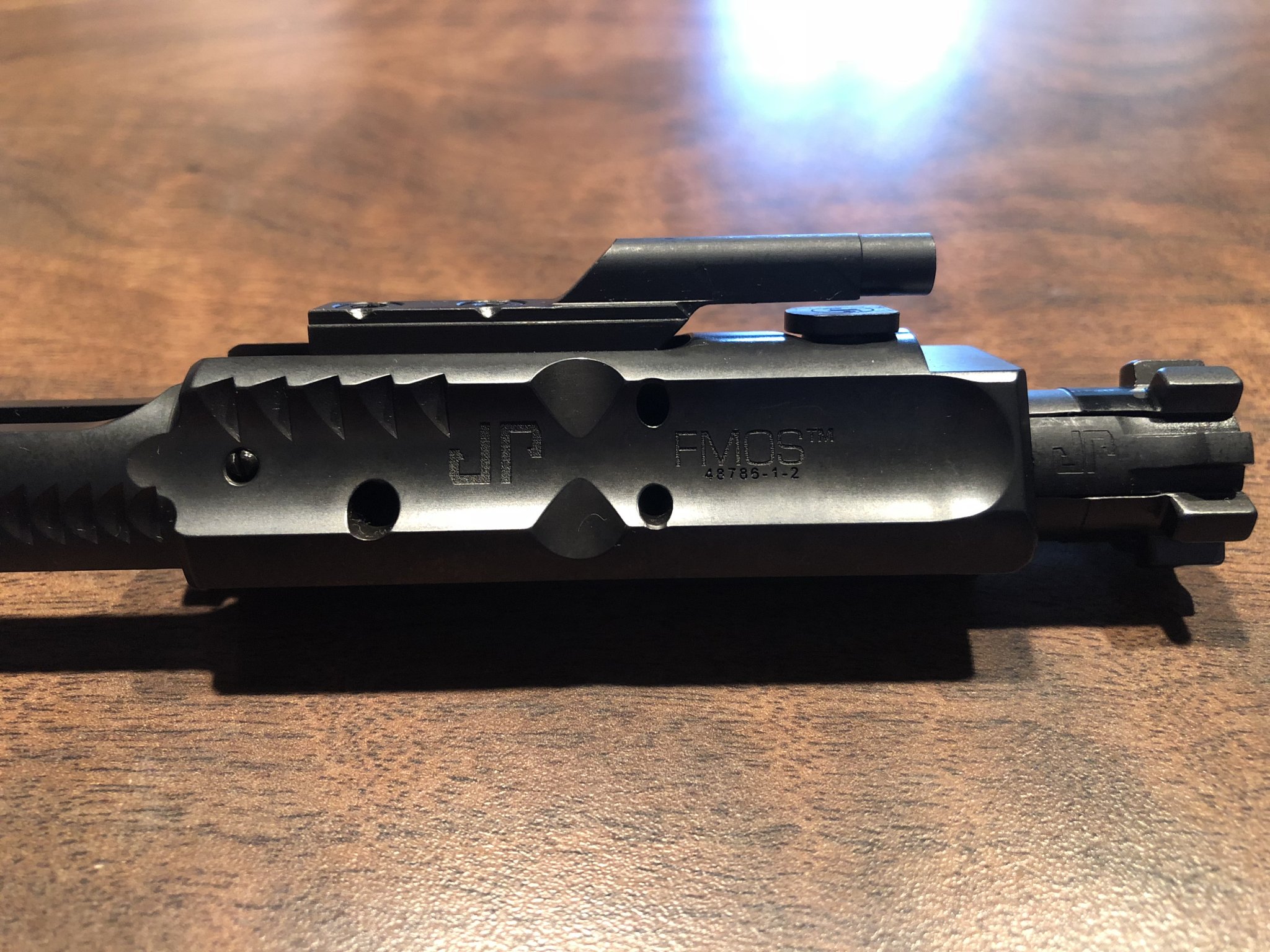

Just do it! ?

You'll be hard pressed to beat these prices on top tier Toolcraft BCG.

You could try a lantac bcg. They advertise it as enhanced but I believe it's also lightened. I have the JP FMOS bcg in my 308 and it does an excellant job. But not sure if it's "enhanced" or not. That wasn't important to me when I bought it.
JP FMOS is the magic in my builds. Doesn't do much for accuracy though a lot of quality barrel mfg.'s like Krieger use JP enhanced bolts for headspacing... They do, however, add to the reliability of the weapon. These things are so slick they'll function dirty and dry, no lie. Best carrier IMO, total reliability.
