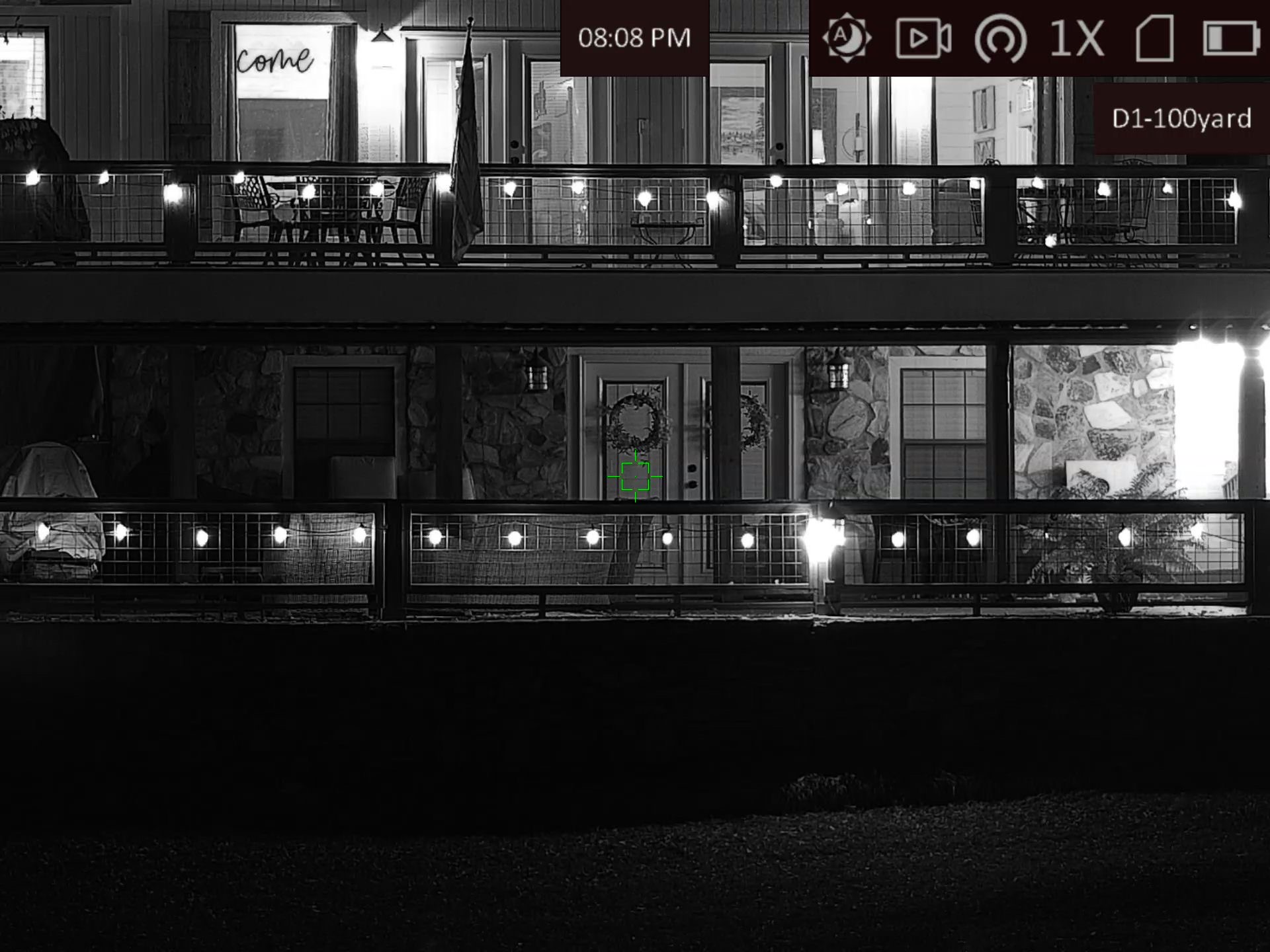

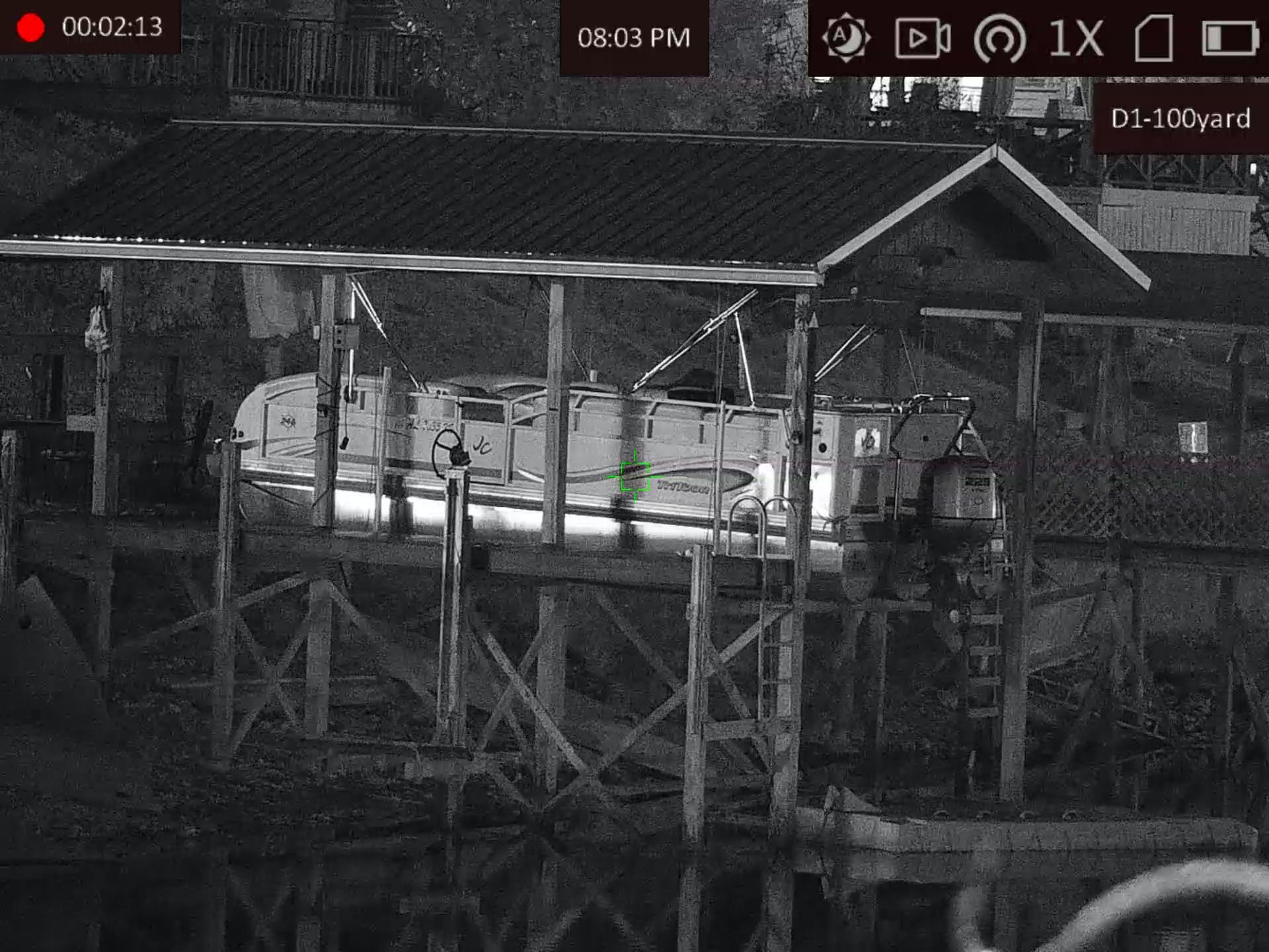

I canceled the Arken order for several reasons, and bought the new AGM Neith DS32-4MP instead. Very happy with my purchase. Higher resolution than the Arken, and made in the USA. 👍🏼
They’re sold out at Midway USA, which is where I got mine, but B&H Photo has them in stock for the same price.
For reference, the pontoon boat is about 200 yards away, the house is about 100 yards away.

View attachment 8296328View attachment 8296326View attachment 8296327
View attachment 8296329View attachment 8296330

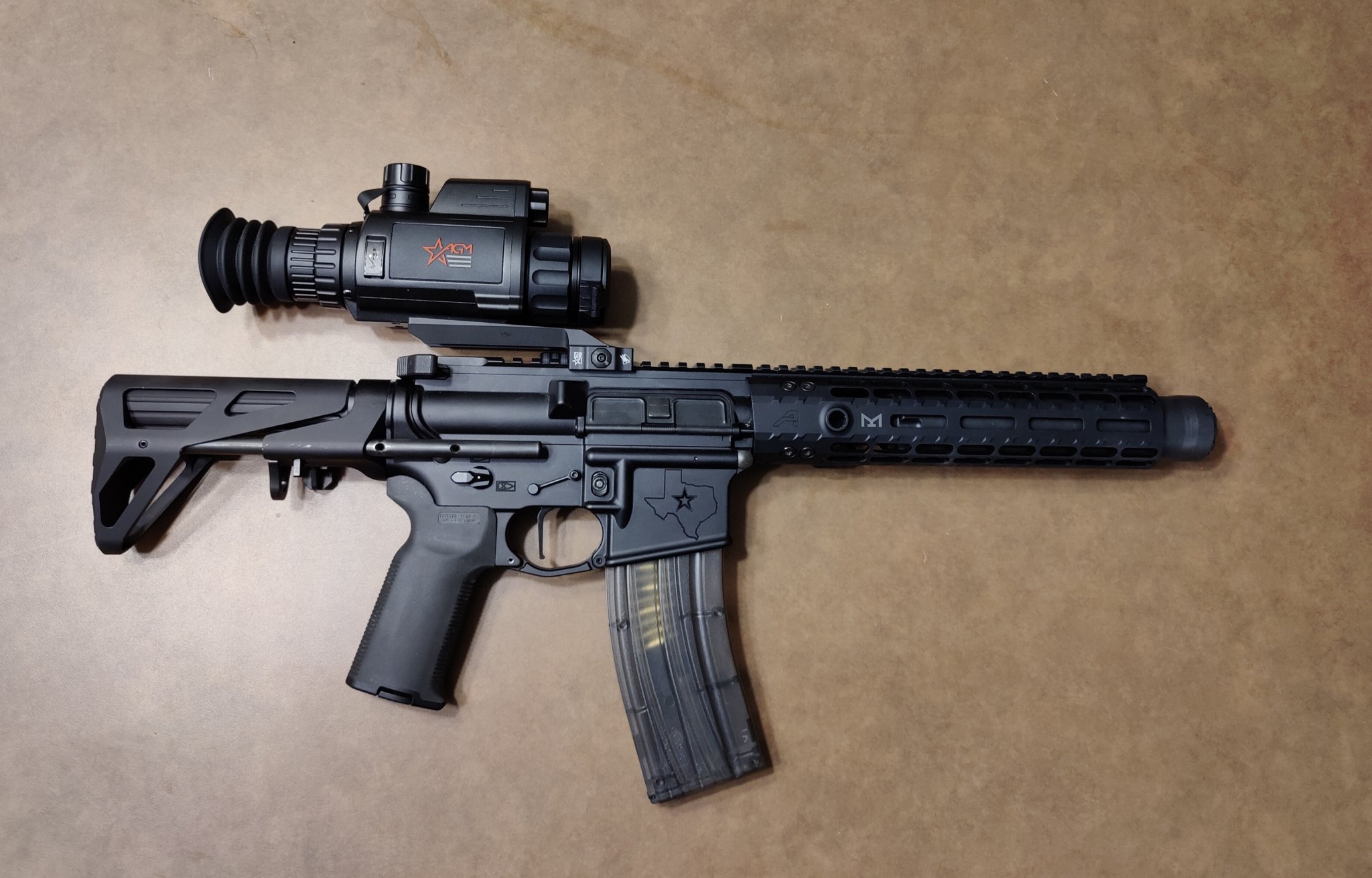

What kind of life do you expect from that thing on a 556 gun(I’m ASSuming)?
I’ve got a 10.5 inch 22 mag I hope to make a critter gitter alongside my 5.7 bolt gun. I’ve got a C35 and pvs 14s with an IR, but something cheap enough that might last a while would be fun as an extra
That’s a 16” .300 BLK shooting 220 subs. So, should hold up fine. I think it’s rated to handle stuff like .308 Win, maybe larger. 🤷🏼 Call them and find out for sure, but 5.56 shouldn’t be an issue at all.

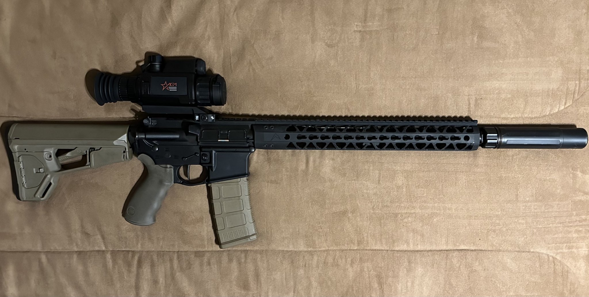

I ended up buying the AGM Neith. Currently on my 22lr upper and I'm loving it. For the money I'm very happy with my purchase. I was going to move it to my .308 AR-10, but I'm concerned the recoil may effect the long term reliability so I'm probably going to end up putting it on my 300blk upper.
If money was no object I would've gone thermal, but for my intended purpose and current budget it's worked out great.
