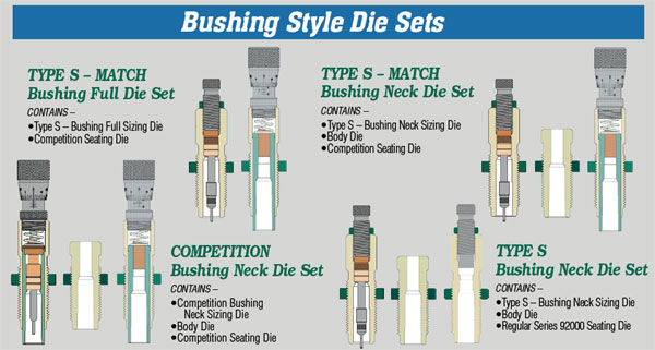

    I am going to get a bushing type die to try with my 243 ackley.
    I see Redding makes a full length and neck bushing die?
    Which is the one to get? I have been using Redding full length dies (regular die without the bushing) to bump the shoulders back a hair.
    I am more of a hunter and just love reloading and want to load the best rounds I can. I use lapua brass, anneal, and use Redding competition seating dies if this info helps.

    There is both a type S full length and a type S neck. He listed both but didnt specify but I got the impression that he was going with full length.
    I would go full length every time.
    Yes, my bias is from the standpoint that I do not shoot factory ammo, at all. All my chambers are minimum/Match. I rarely shoulder bump and even less frequently F/L/R. For all intents and purposes, I neck size only. I prep my brass to stay with a given rifle/chamber (.223, 6x47L and .308W).
    I may not be the best opinion to listen to, as there are differences between what I do in reloading, vs what the OP wants/needs to do for reloading for hunting.
    I run a Redding type s full length for my bolt action. One thing I do is size to the chamber by backing out the die until the bolt closes snug/semi-tight. I also don't use the expander and just size it down by .001. The nice thing with only one rifle to caliber is the die can be "custom" sized to the rifle for tightest tolerances you want.
