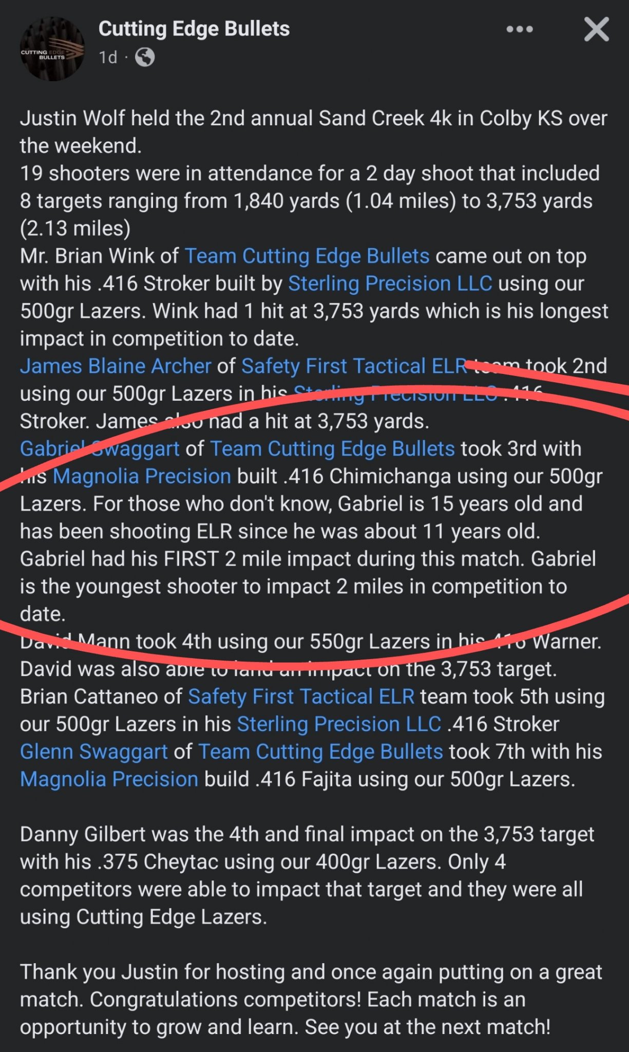

Obviously you need to start somewhere...so your goals aren't exactly outlandish.
This isn't 4-5 miles...but it's the type of shooting you'll need to do, just to dip your toe in.
