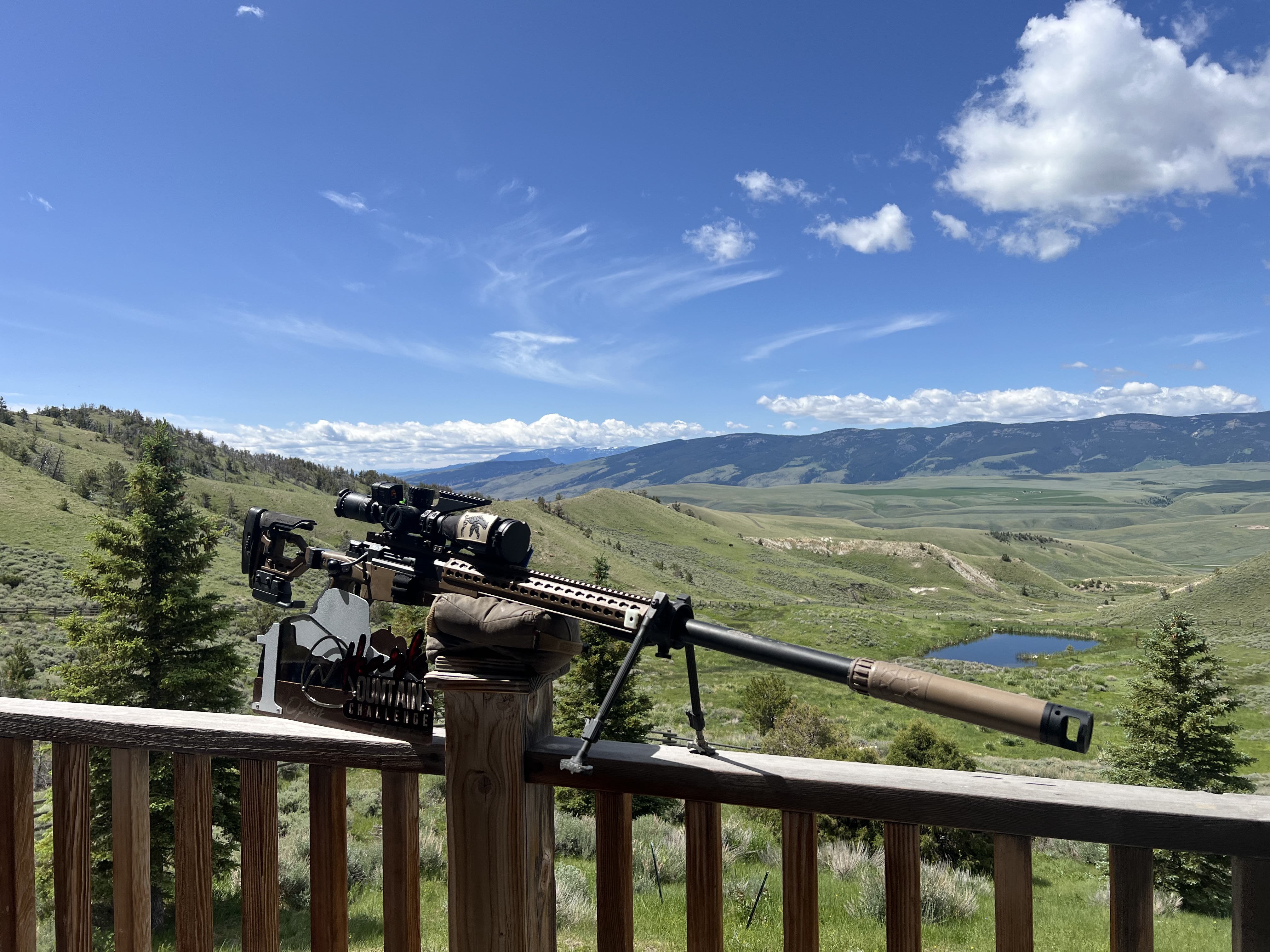

Take a look at the HuxWrx Flow Range 36. Can use it on everything up to 9mm and works great on my ARs from .223 to .308 and 9mm PCC.

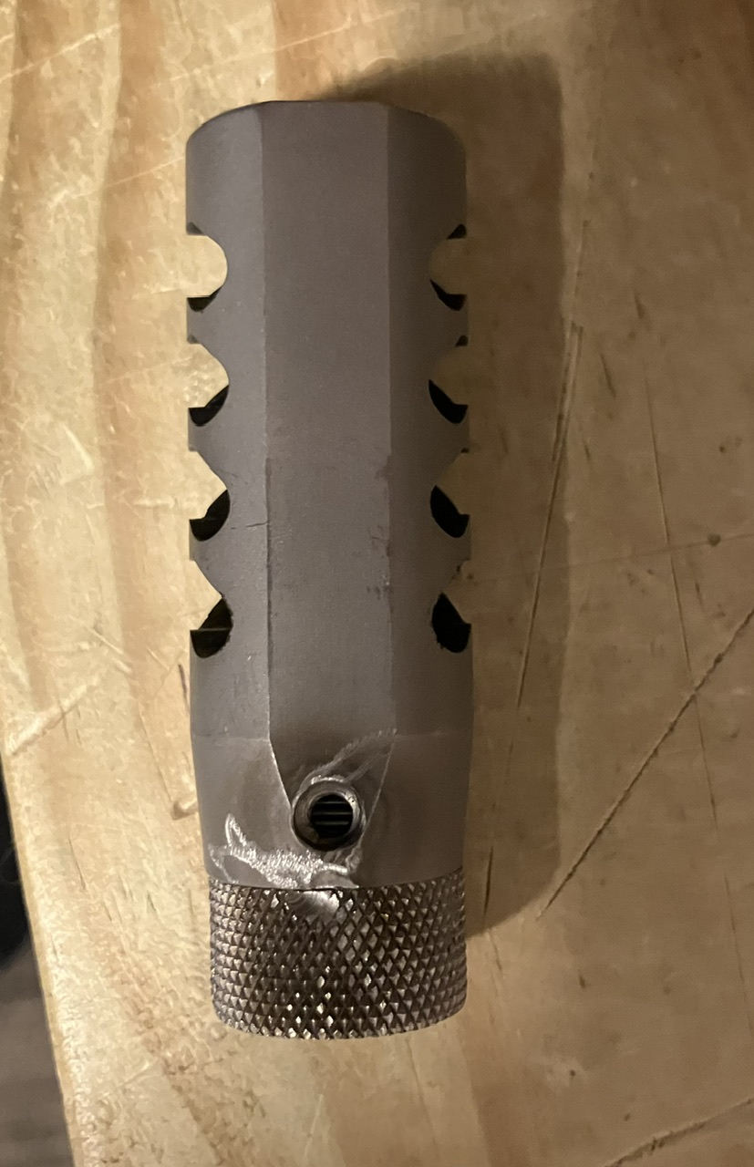

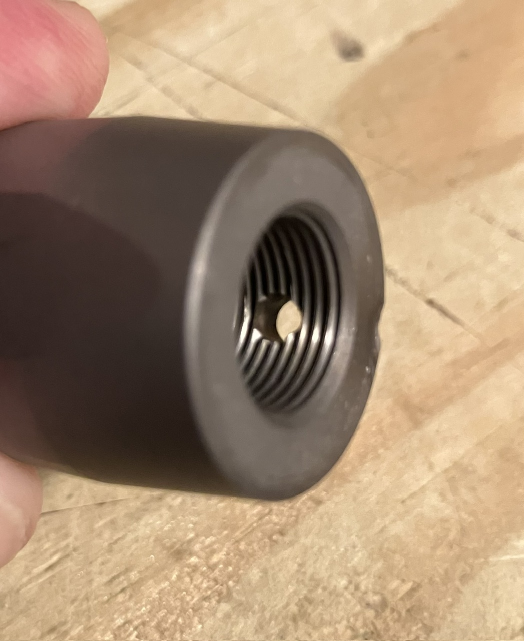

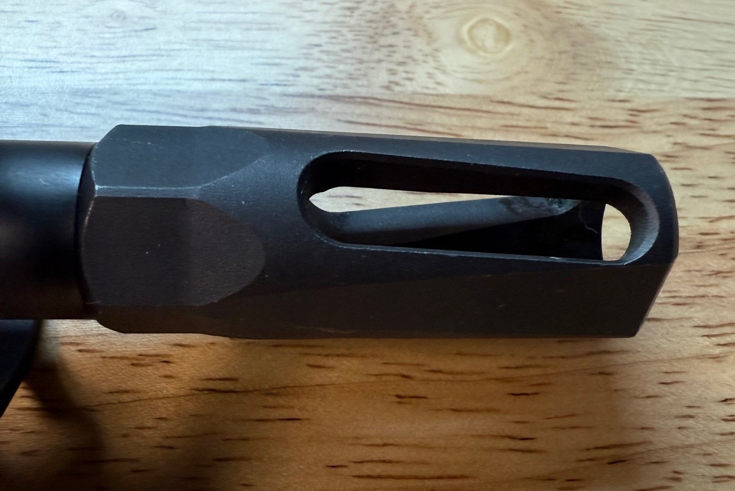

Hmmmmm, take a DeWalt to my JP huh?
I did it to a Seekins and a POF. You just have to drill through the weld over the pin area.

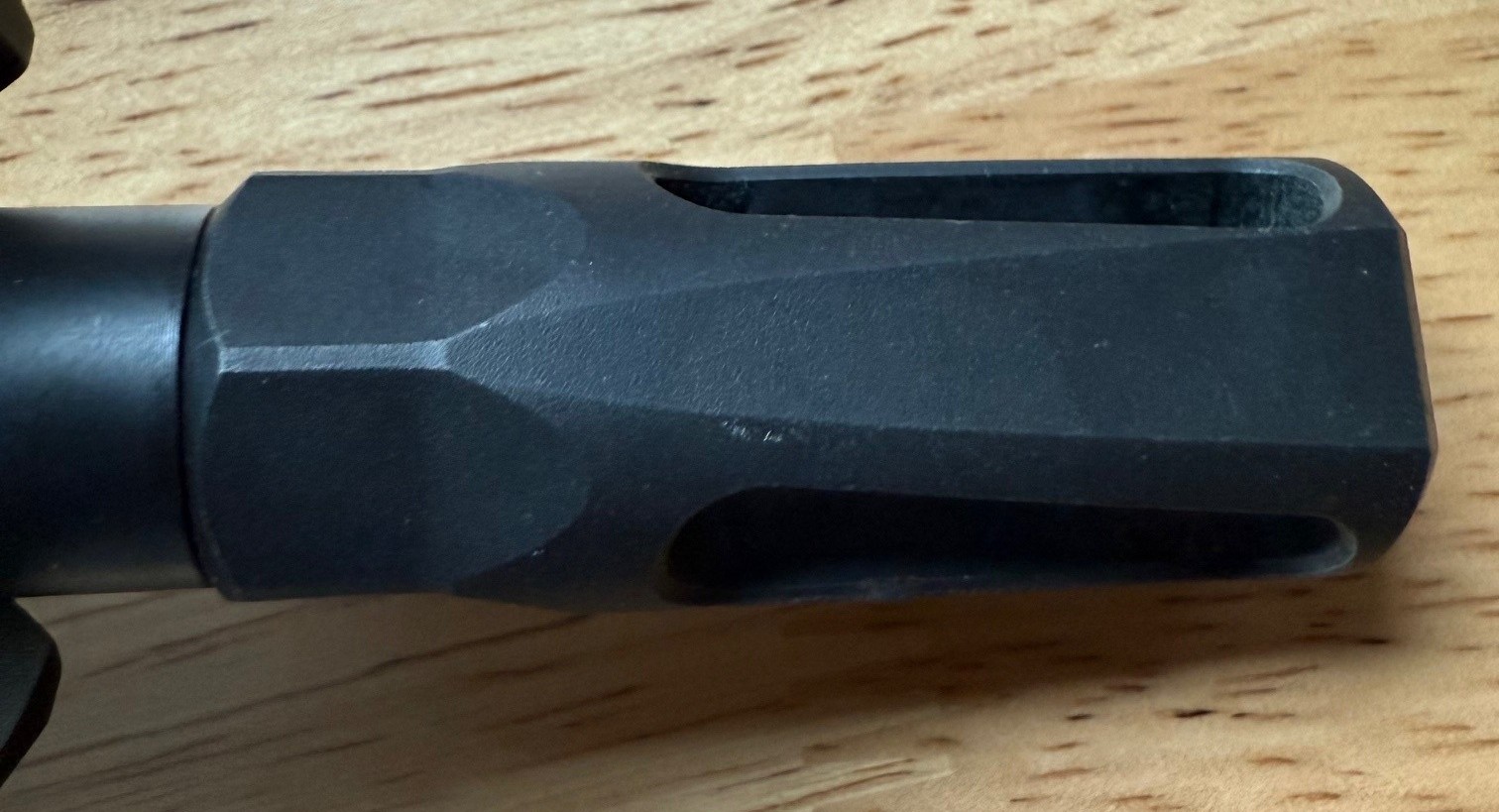

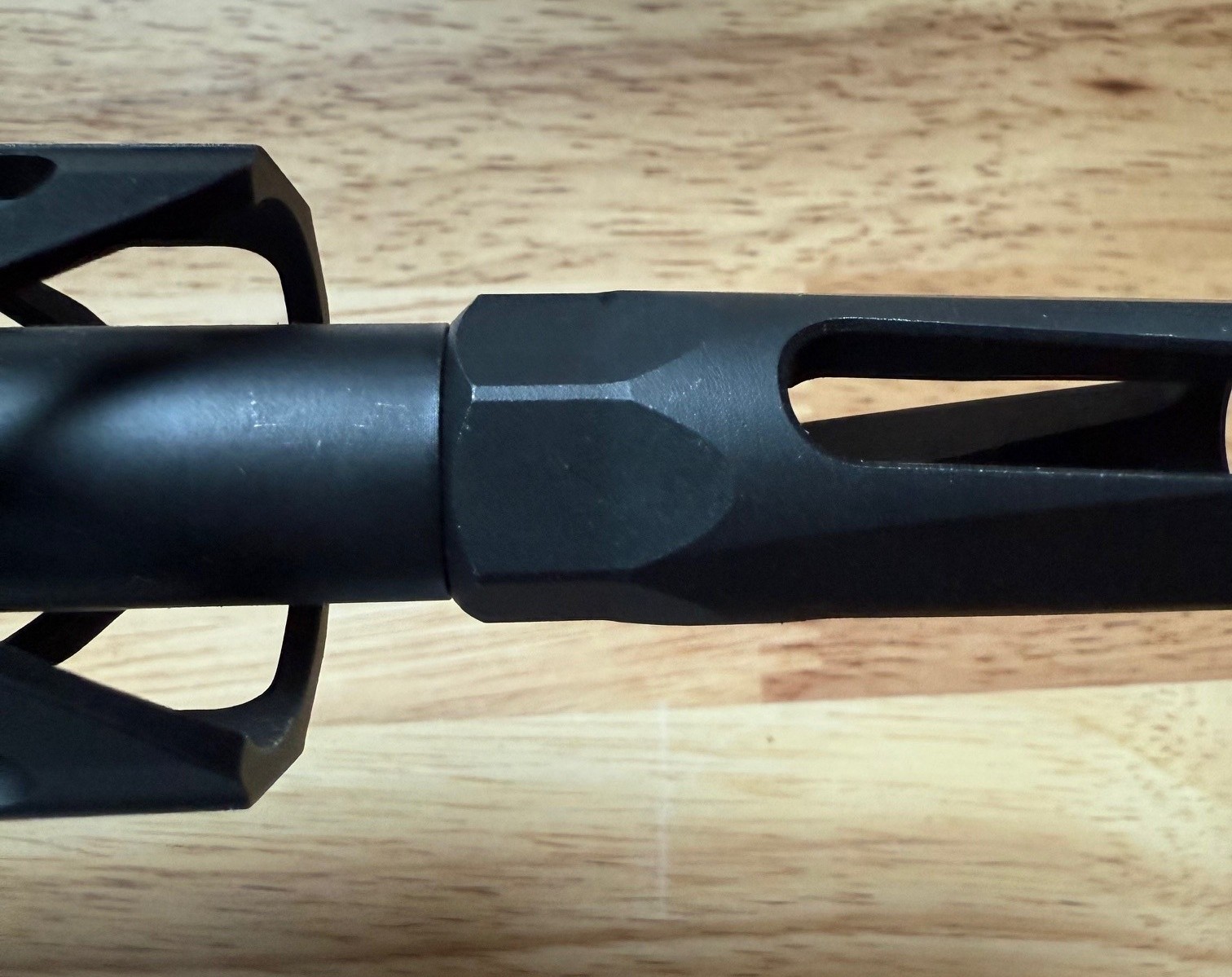

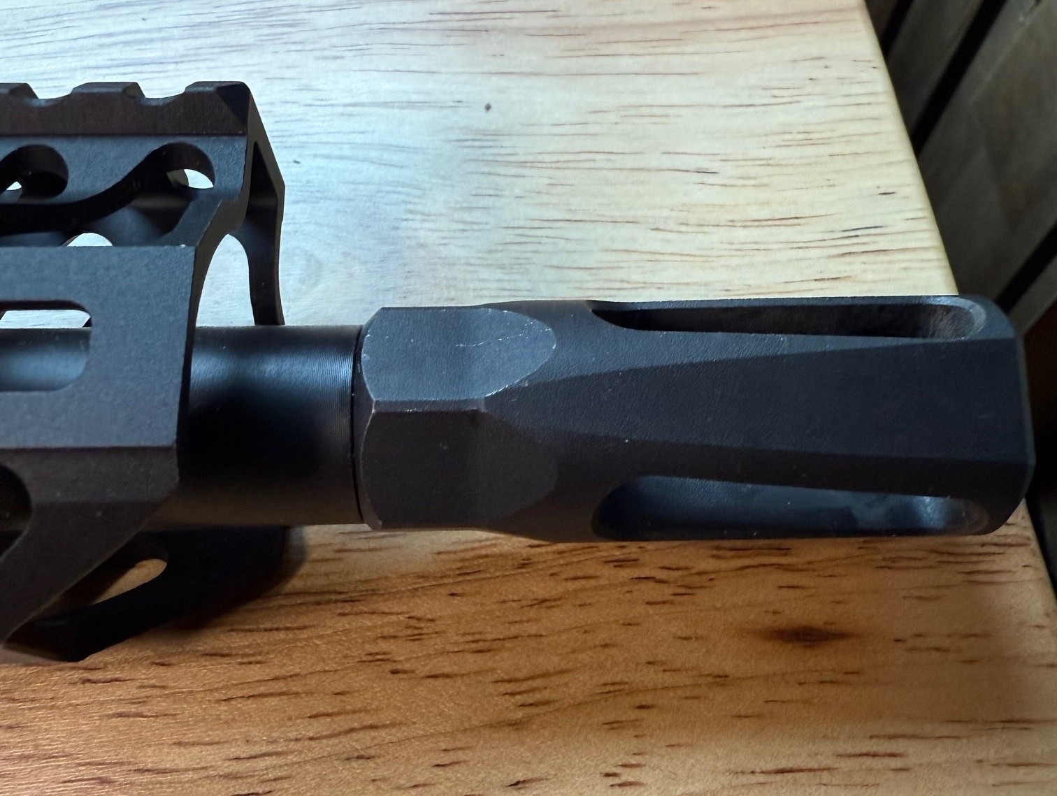

Yeah that doesn’t look like a pin welded flash hider. Who told you it was? Have you tried to spin it off?
It might not be, I just assumed (yes I know) I would have ordered the shortest barrel they would send me, and thought it would be pinned. I did try and spin it off but it didn't budge. Got the upper from Seekins before they stopped selling direct. I can try heating it up. I tinker with bolt guns. not so much with ARs.
Do you have a reaction rod for the upper so you can really spin it?
Also if rocksett you can soak it in some hot water and it loosens it up. Might be a good idea to give Seekins a call and see what they did to them.
If you ever plan to pop apart ARs or even just to work on an upper it is nice to have one of the reaction rods. I bought one of the cheaper ones a few years back and it’s a nice tool to have.
I just watched a couple of videos I can see how it would be handy. The Midwest Industries URR is all steel and was recommended in one video $125.
