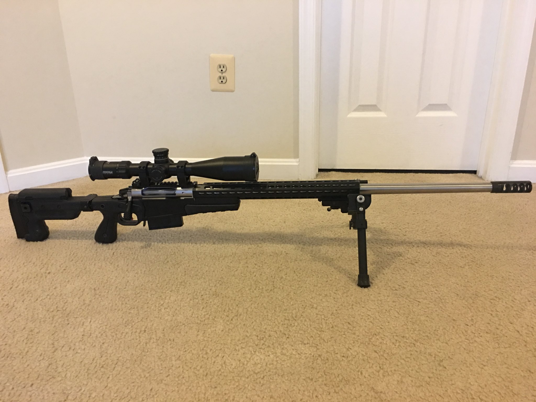

I'm building a 7mm Rem Mag right now around this bullet. I have part of the stock machined and am planning on chambering and threading the barrel this weekend.

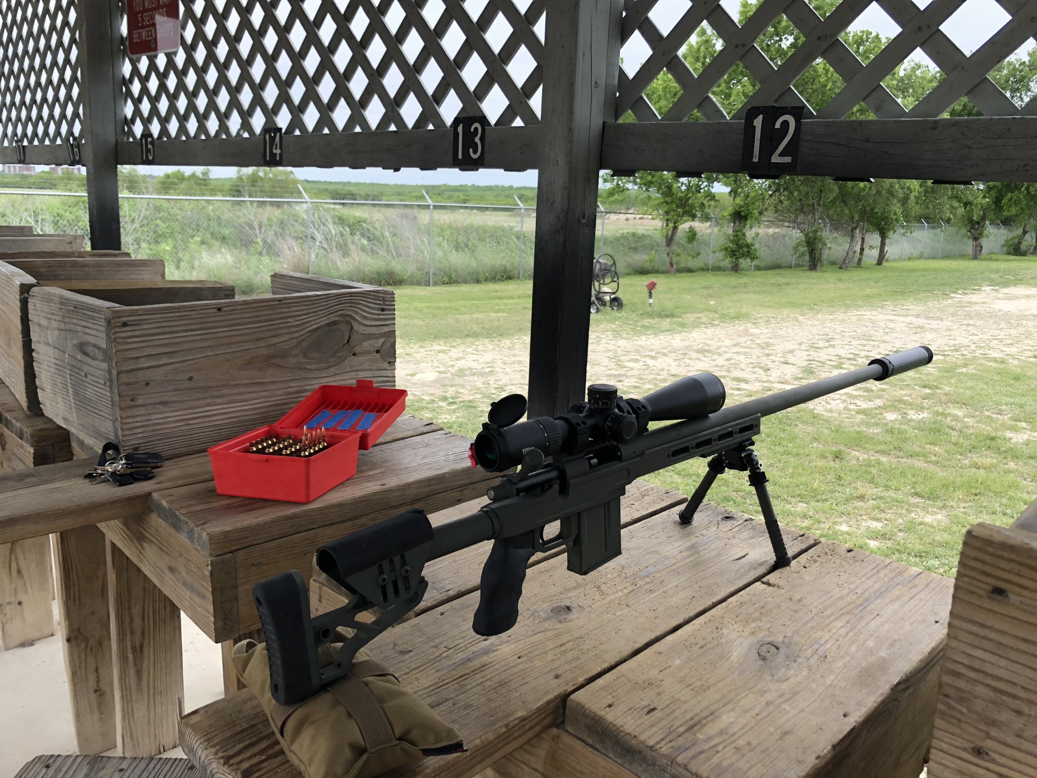

I am waiting on a new barrel for my 7RM now. The one that is still on it is a 28” Brux. I was running the 180 eld m at 3041 suppressed. I also lost the barrel in 1018 rounds
What was your load?
Mine is 71.9 of Retumbo.

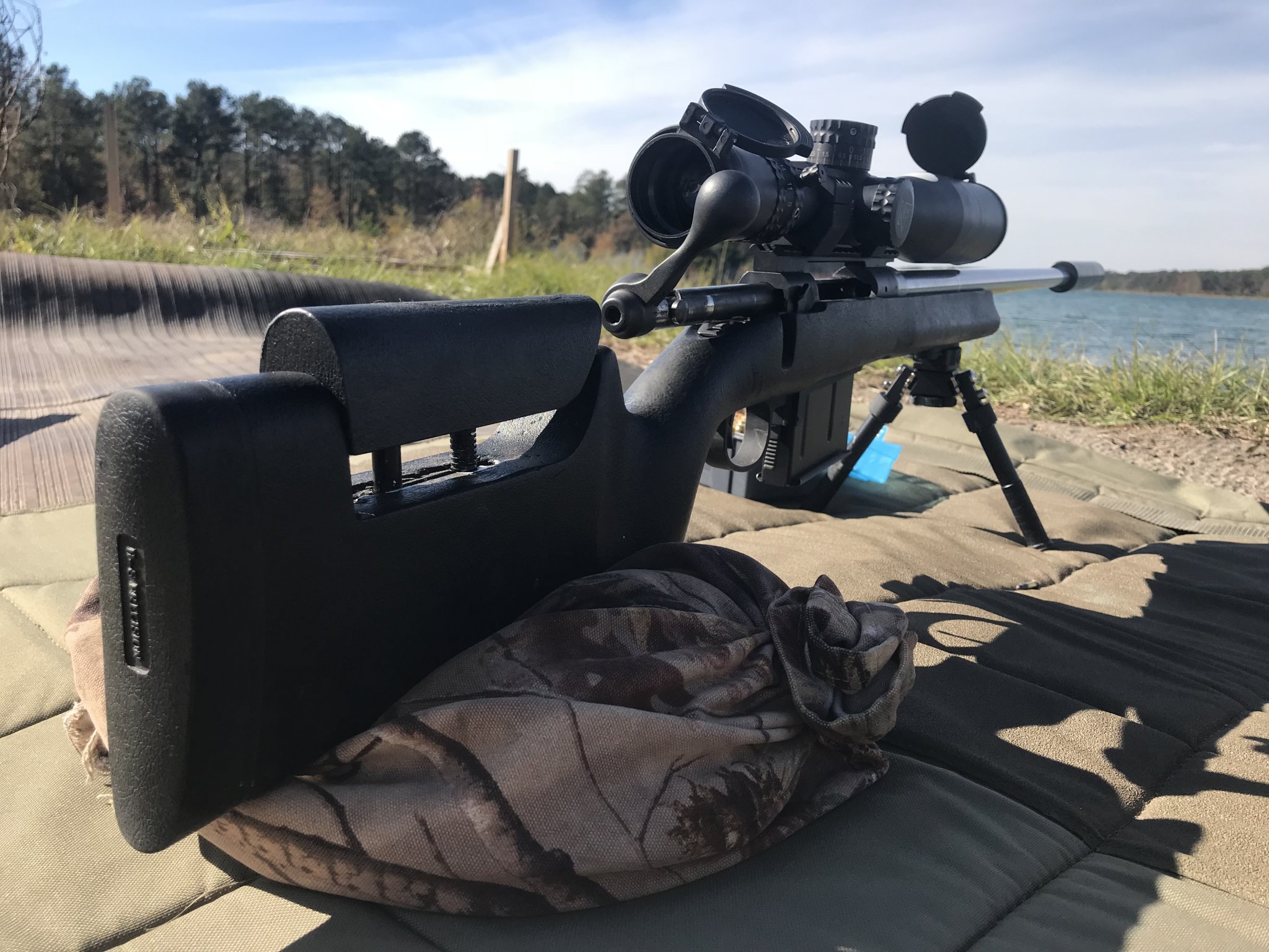

also using Win brass. I was using PPU brass which was outstanding but had terrible case capacity. I was at 2940 and almost compressed. I was around 63gr with the PPU. Went to Winchester brass and at 68.5 with no pressure signs and a little more room left in the case.
