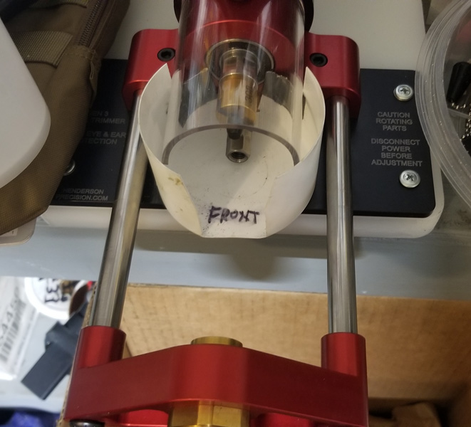

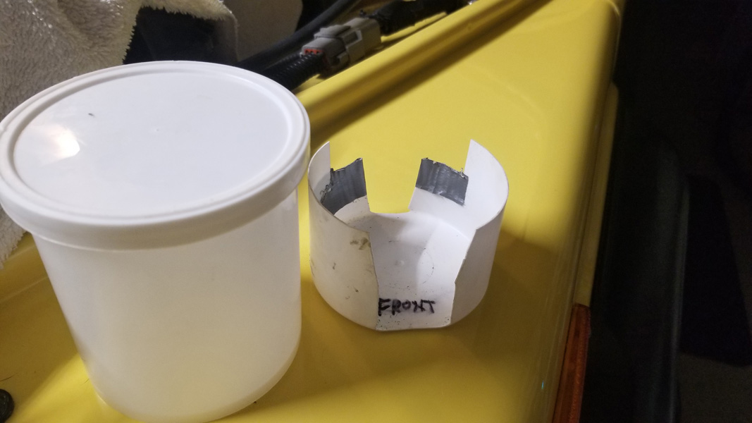

Brass "shaving" catcher made from plastic frosting jar (Pillsbury, Duncan Hines, ....etc). Catches 95% of shavings. Gen II model will work even better when the cut-outs get closer for a tighter fit. Future Gen II is on the left. This works for 308 Win family and up. Need to make one where the front is cut shorter for 300 Blackout trimming. Love the Henderson.
