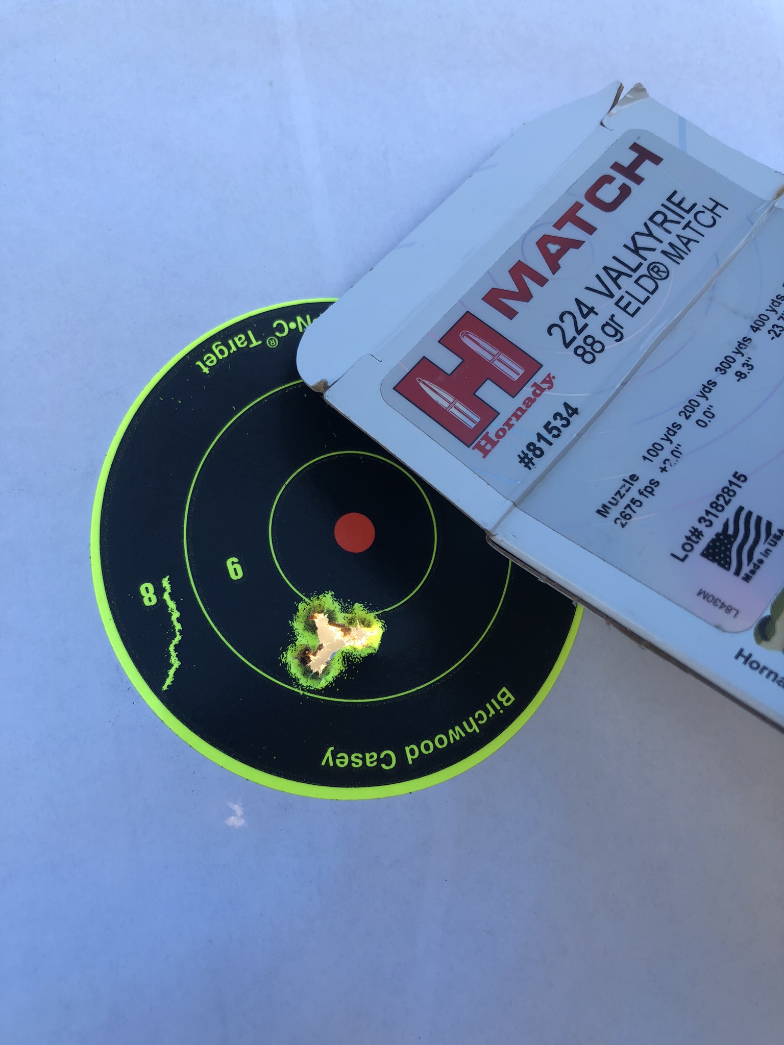

I’d say that mixed with the fact that a lot of people don’t have nearly good enough fundamentals to shoot a gas gun well left an impression that it was not an accurate cartridge. We put one together and it is pretty impressive. 1/2 Moa at 100, 13 mils and still (barely)supersonic at 1200yds AT SEA LEVEL, is pretty ok for a 22 cal gas gun.

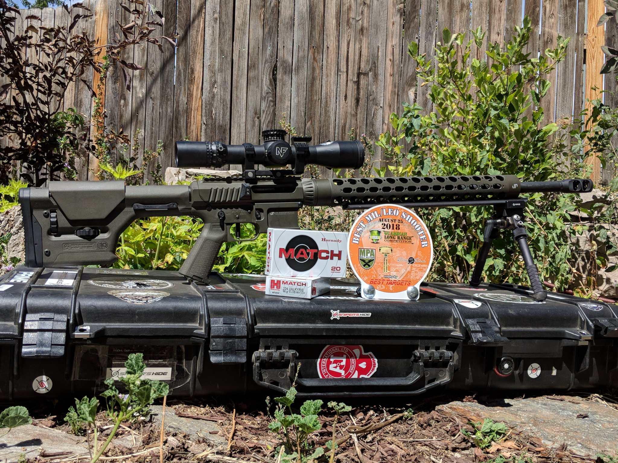

I used the Valkyrie twice in competition and did well in both
Came in 12th I believe it was at the Guardian, fun fact on this, I shot the 88s the same week they came out. no prep, I had to dope the ammo at the match the day before using 3 targets they provided.

I got lucky with both of mine. A Craddock barrel with a 6.7T Rock Creek cut rifled blank, and a LMT 20" CL barrel both liked the factory Federal stuff, and both were extremely easy to load for. There was one factory load that the LMT didn't like as much IIRC, I believe it was the varmint load but I could be mistaken. Both shot the 90gr SMK load about 1/2moa. The Craddock shot my 95gr SMK load consistently in the .2's and is by far the most accurate and consistent gas gun I have ever had or shot.
