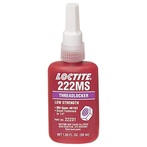

All of my guns get number 222 purple Loctite. Even it can be aggressive if you use too much on small screws.
