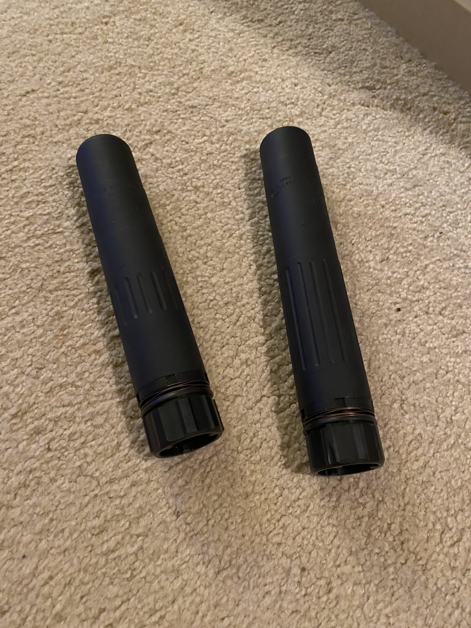

We have a couple of AAC sdn6 cans.
The 51-T flash hider mount sucks to shoot without the can in place.
The amount of muzzle flip it generates opens my groups.
If while shooting with the can on you get groups opening up it's a simple fix.
Clean the beveled mating surface in the can. And clean / lube the ratcheting lock mechanism.
On the adapter side clean / lap with fine emory cloth the mating beveled surface.
Put your barrel in a vice facing up to work on it. See if the can locks up with some force or there is play, like it wants to almost catch the next tooth.
When lapped in it will catch the next tooth and lock in with a distinct "TWANG".
Your can on accuracy will be great from that point forward .

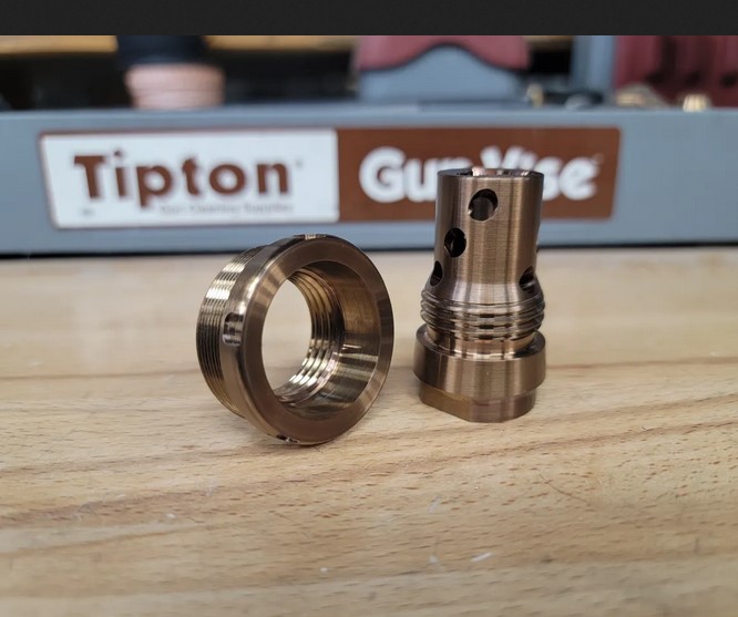

I had my SNd6 converted a few years ago. I went with just the 1.375x24 threads and switch the adapter between Plan B omega for a cherry bomb or the EA TBAC adapter for my CB brakes. The great thing about a 1.375x24 is you have a ton of mounting options to choose from

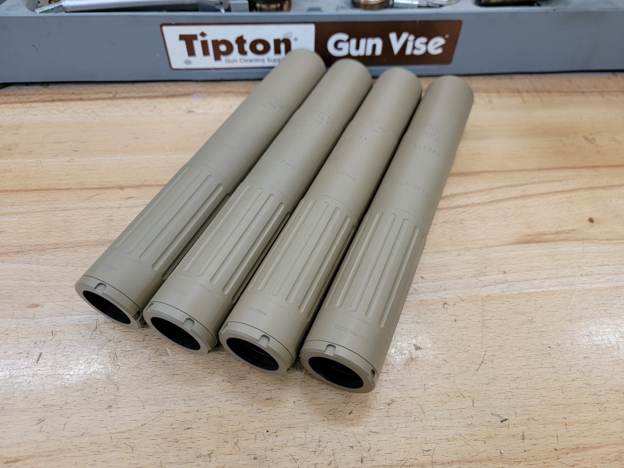

Just got my cans back from ECCO Machine two weeks ago and I absolutely cannot say enough about the quality of their work! I had them converted over to 1.375x24 Griffin Armament Plan-A taper mount adapters and cerakote finished in coyote tan. They look awesome and lock up solid on every barrel now. I got on the waiting list back in November 2021, had my number come up in May, and the cans back to me in about four or five weeks including shipping. Totally worth the wait! Like they're brand new all over again.
Are these SCAR-H?
