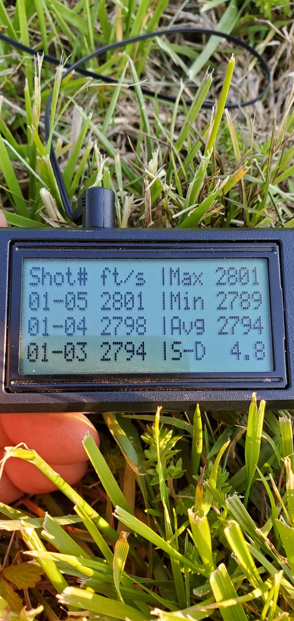

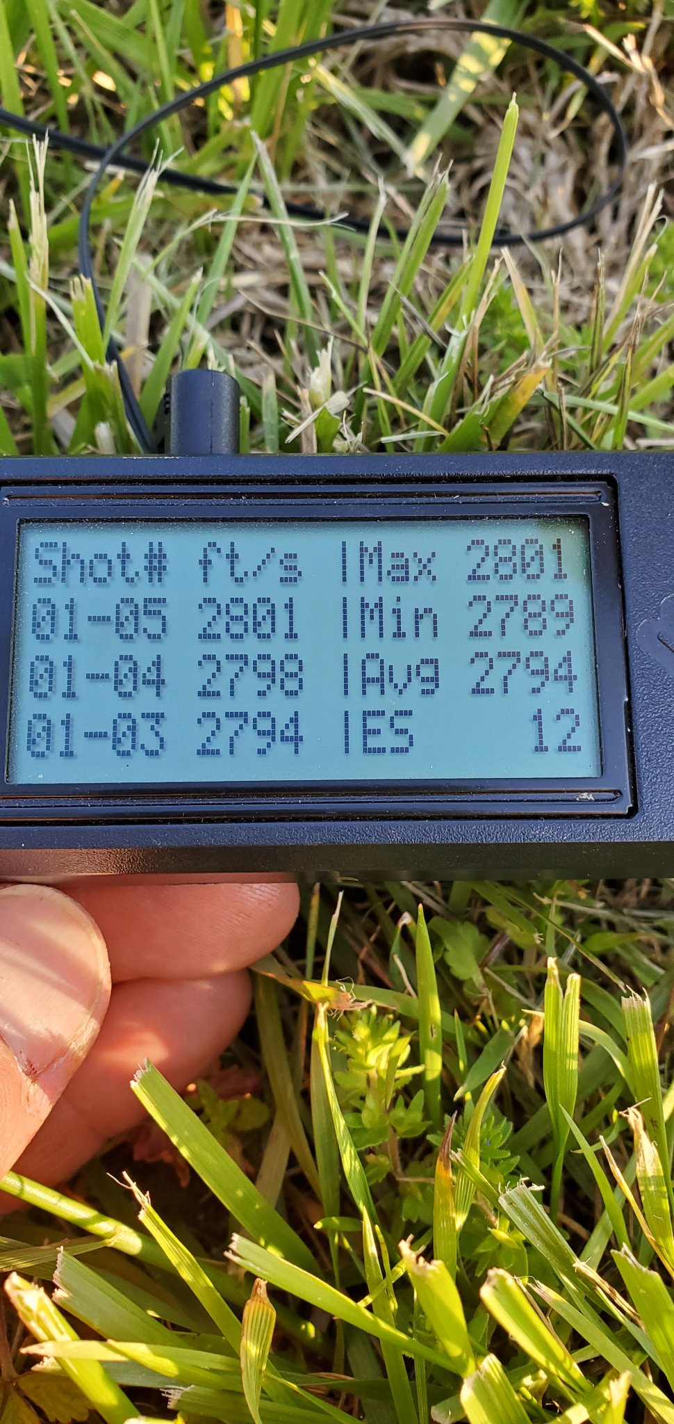

    Practice ammo....why is that any different than non practice ammo? Anyway, I do everything on a 650 and dualing chargemasters. Not sure how much better I need.
    Practice ammo....why is that any different than non practice ammo? Anyway, I do everything on a 650 and dualing chargemasters. Not sure how much better I need. View attachment 7325330View attachment 7325332
    Same reason 100yd benchrest use powder throws and not a fx120 or Prometheus. It doesn’t matter at that distance. My practice is 100-400 yds. I don’t care if I have a 50 ES or what my runout is.
    Relax, I know what it is. I get it. I may not place as high a dollar value on my time as some people but I'm always of the mind that if something is worth doing, it's worth doing right. I'm just trying to make the point that everyone talks about progressives like it has to be some sort of compromise or can only load second rate practice ammo, when clearly that isn't the case. You can get great numbers and a great load with a powder drop and do everything in one pass if you do it right for what most people practice with. Runout isn't an issue and a powder drop can be suprisiny accurate when you use a powder suited for it and work the dropper over to give the best results. If you don't care how shitty your practice ammo is, unless it's some off the wall caliber with no factory support like a dasher or something then why not just buy junk ammo and save the time and effort of buying a press, components and the time invested in loading. I know what practice ammo is, the concept is just stupid to me.
