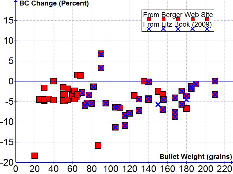

The attached figure shows changes in Berger's advertised ballistic coefficients between 20 October 2008 (when Berger was using a predictive model attributed to Bill Davis for their BCs) and 14 April 2010 (after Berger had purportedly updated their advertised BCs to "Bryan's fired numbers" (to quote Eric Stecker). In total (counting bullets with the same shape and BC only once), the BCs of 66 bullets were updated, and the percent differences in these new BCs are shown as red squares in the graph. However, comparing with Bryan's book, Applied Ballistics for Long Range Shooting (the blue Xs) shows only 35 of the new BCs can be attributed to Bryan's experimental measurements.
Where did the new BCs for the other 31 bullets come from? The most plausible explanation seems to be that Berger re-calculated these BCs based on an "improved" predictive model (or a similar predictive model) based on equation 17.1 of Bryan's 2009 book. This model purports to have a 95% confidence level of 4.2% for boat tail bullets, but predictions for flat base bullets would likely be much less accurate.
One reason I lean toward this possibility is because the 115 grain .257 VLD had its BC advertised at 0.479 at the Berger site on 6 February 2009, and I received two boxes of these bullets with this BC printed on them at about that time. However, in Bryan's 2009 book and later on the Berger site, the BC was revised to 0.466. When I asked him about these differences, Bryan explained that the BC value of 0.479 had been based on a predictive model and used temporarily until the BC could actually be measured with his method. I think several other bullets (like the 87 grain .257 bullet) whose advertised BCs were changed twice between 10/26/2008 and 2/6/2009 and 4/14/2010 may have also had the intermediate value based on a predictive model later changed to a model based on measurement. It is certainly possible that all 66 bullets were updated based on actual measured BCs, but it is also possible that some bullet BCs were updated based on a predictive model and have still not been updated based on real measurement results.
It may be notable that while most of the bullets whose revised BCs seem to be based on a predictive model have BC adjustments under 5%, 16 of the 35 or 36 bullets that seem to be based in actual firing measurements have been adjusted downward by over 5%. Other than a 17 cal bullet, the biggest downward adjustments were the 87 grain .257 (-15.85%), the 115 grain .257 (-10.9%), and the 105 grain .243 VLD (-11.33%).

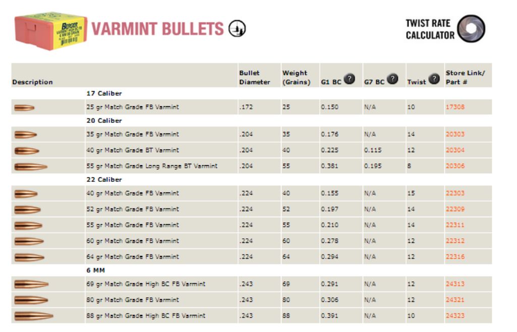

Berger's web site is claiming (as of 8/29/14) that the BCs of the varmint bullets are measured and that the measurements are accurate to 1%, as the attached screen shot and text from clicking on the BC ? button shows.
The BC's of Berger bullets are based on carefully controlled test firing. The BC's established by this method are accurate to within +/- 1%, whereas BC's predicted by computer programs can have as much as +/- 10% error.
Now, I don't know where you come from, but where I come from, when a company makes a claim in the process of selling something to customers, they owe it to their customers to make good on that claim.
Or is your version of America a place where companies can lie to customers, and customers have no right to ask for the promised information?

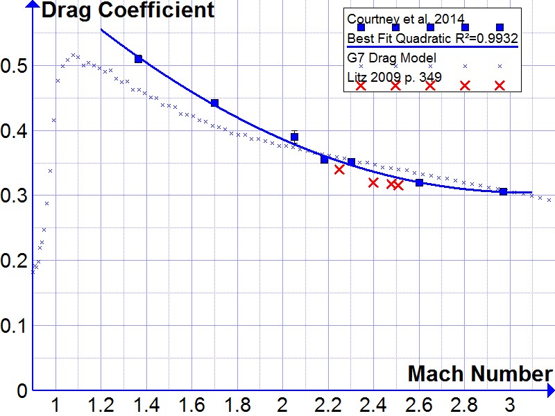

Many parties that express confidence in BCs published by one party over others fail to appreciate important subtleties in the way BCs are experimentally determined and the velocity ranges over which validity and accuracy are claimed. The attached figure is useful for discussion.
The red Xs in the figure are drag coefficient measurements taken from Bryan's book, "Applied Ballistics for Long Range Shooting." The blue squares are our original measurements over a much wider range of Mach numbers. Bryan's measurements represent 2-4 shots and a range from M2.25 to M2.52 or so. Our measurements represent 80 shots from M1.36 to M2.97. Each blue point is the mean of the Cds at a given Mach number, with 10-20 shots at each Mach number. In most cases, the error bars are less than 1% and covered by the data point itself.
No one should lose any sleep over the small vertical displacement between Bryan's data and ours given that the experiments were performed with different rifles, different twist rates, different boxes of bullets, different measurement systems under different atmospheric conditions. That the two data sets are so close is a testament to the care taken in both experiments.
The real issue is that Bryan claims in his book that his data over such a small range of Mach numbers is sufficient to accurately determine ballistic coefficients from 1500 fps (M1.34) to 3000 fps (M2.68). Since our original Cd data actually spans M1.36 to M2.97, we could easily compute G1 and G7 BCs over that range. At Mach numbers where the uncertainty in the Cd is 1%, the corresponding uncertainty in BC will also be 1%. Except for M2.05 (close to 2%), most of our uncertainties are close to 1%. However, it would be a significant mistake to extrapolate our data and claim to have determined similarly accurate Cds or BCs at Mach numbers below M1.36 or above M2.97. It is without doubt that our paper would not have passed peer review had we done this.
Likewise, there is very little reason to assign validity to Bryan's published BCs that are well outside of the range of Mach numbers where the drag coefficients were actually measured. In this case, accuracy is ascribed to the published BCs from 1500 fps (M1.34) to 3000 fps (M2.68) in a case where measurements were made from M2.25 to M2.52. Careful review of the data on pp. 332-521 of Litz (2009) shows that in the majority of cases, the actual range of Cd measurements is much narrower than the M1.34 to M2.68 range for which BCs are presented that are purported to be accurate.
This is not to say that these measurements are without value, but rather that some have ascribed overly optimistic levels of accuracy and validity. A BC determined over a limited range of Mach numbers is still much more valuable than BCs determined by model predictions with no measurements at all.
