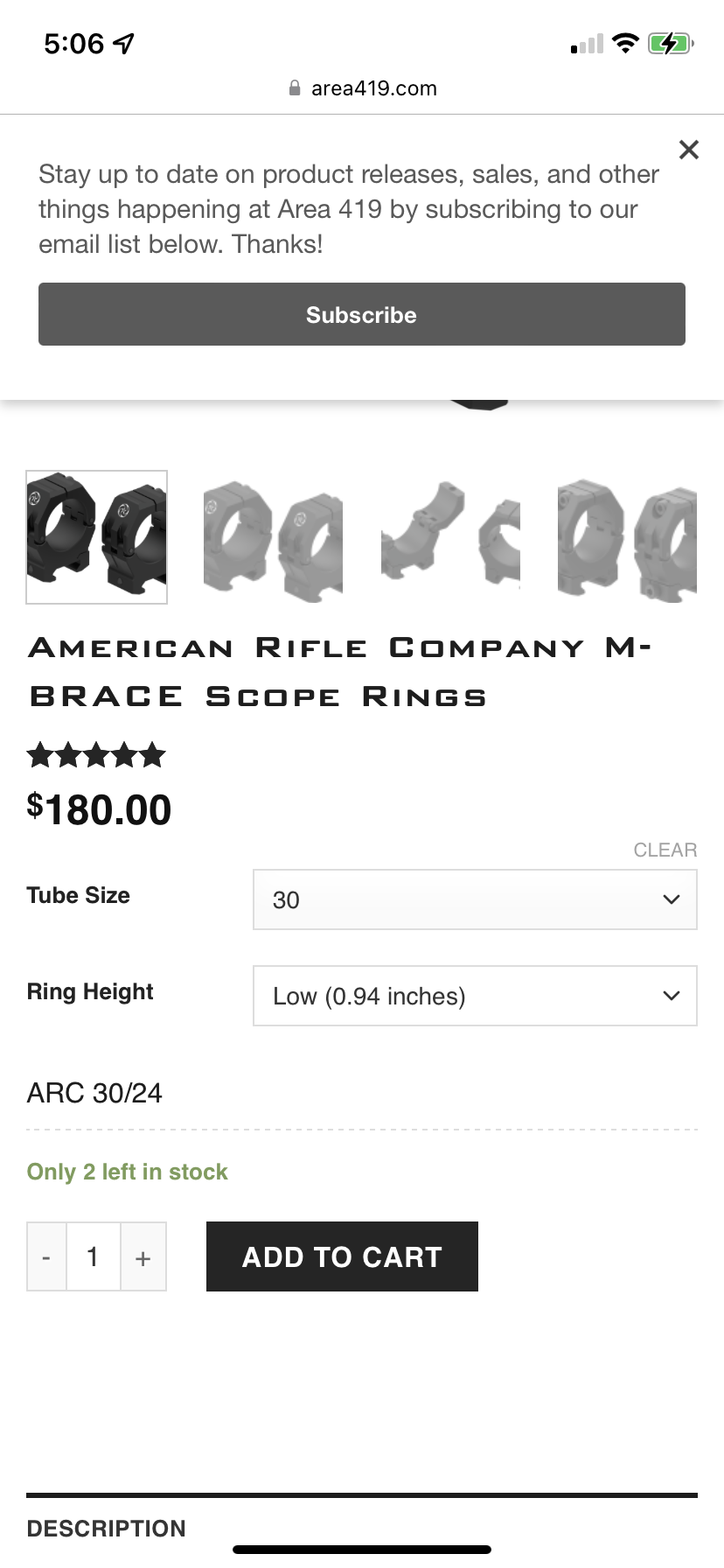

ARC does have a .94 ring. The picture is from area 419 website.

Yes, they have lower rings....I misunderstood and thought you wanted the one piece mount. I think Ted made a mistake by calling them "M-brace rings" and "M-brace mount". I rather think they should have diff nomenclature.
