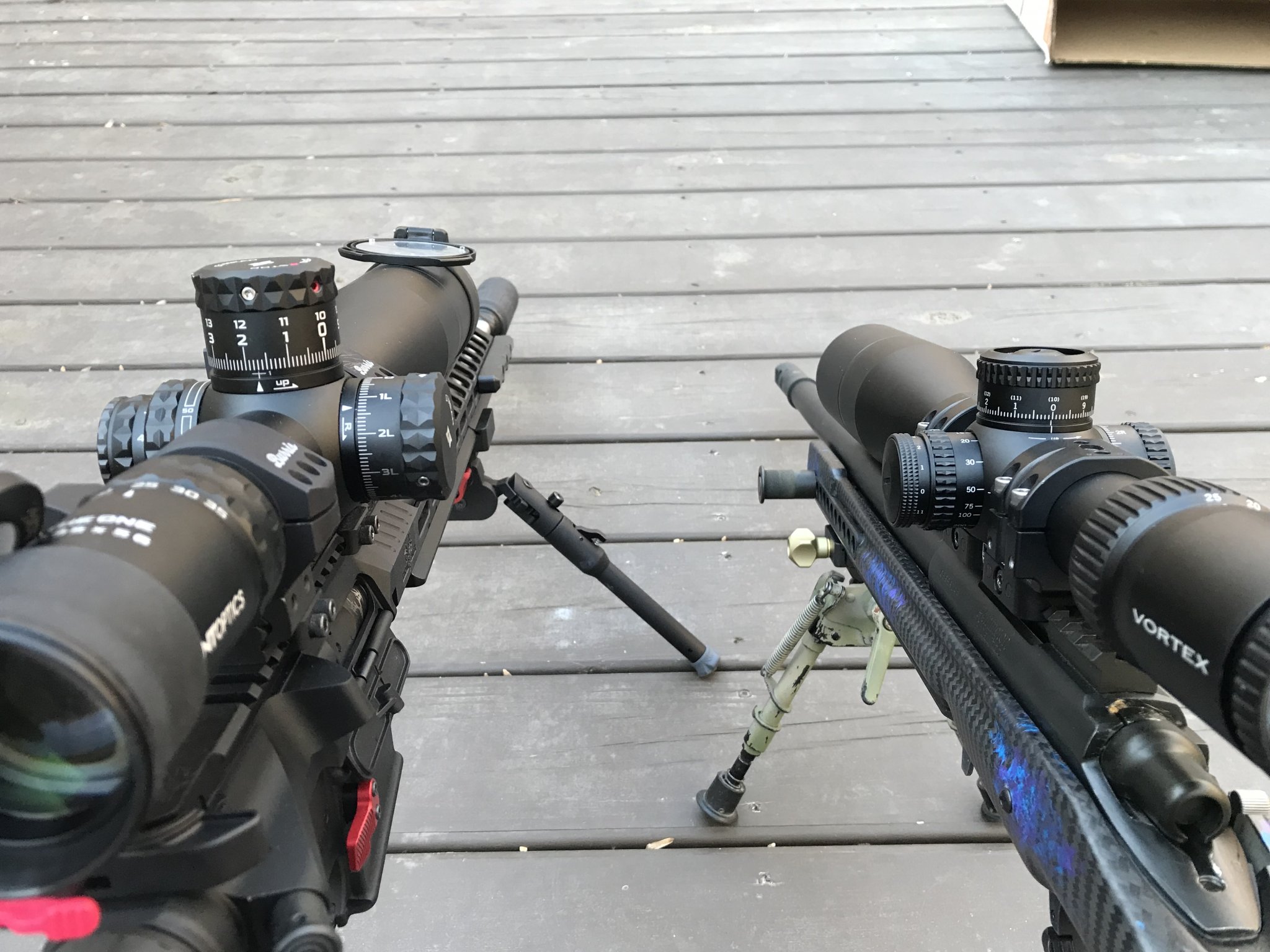

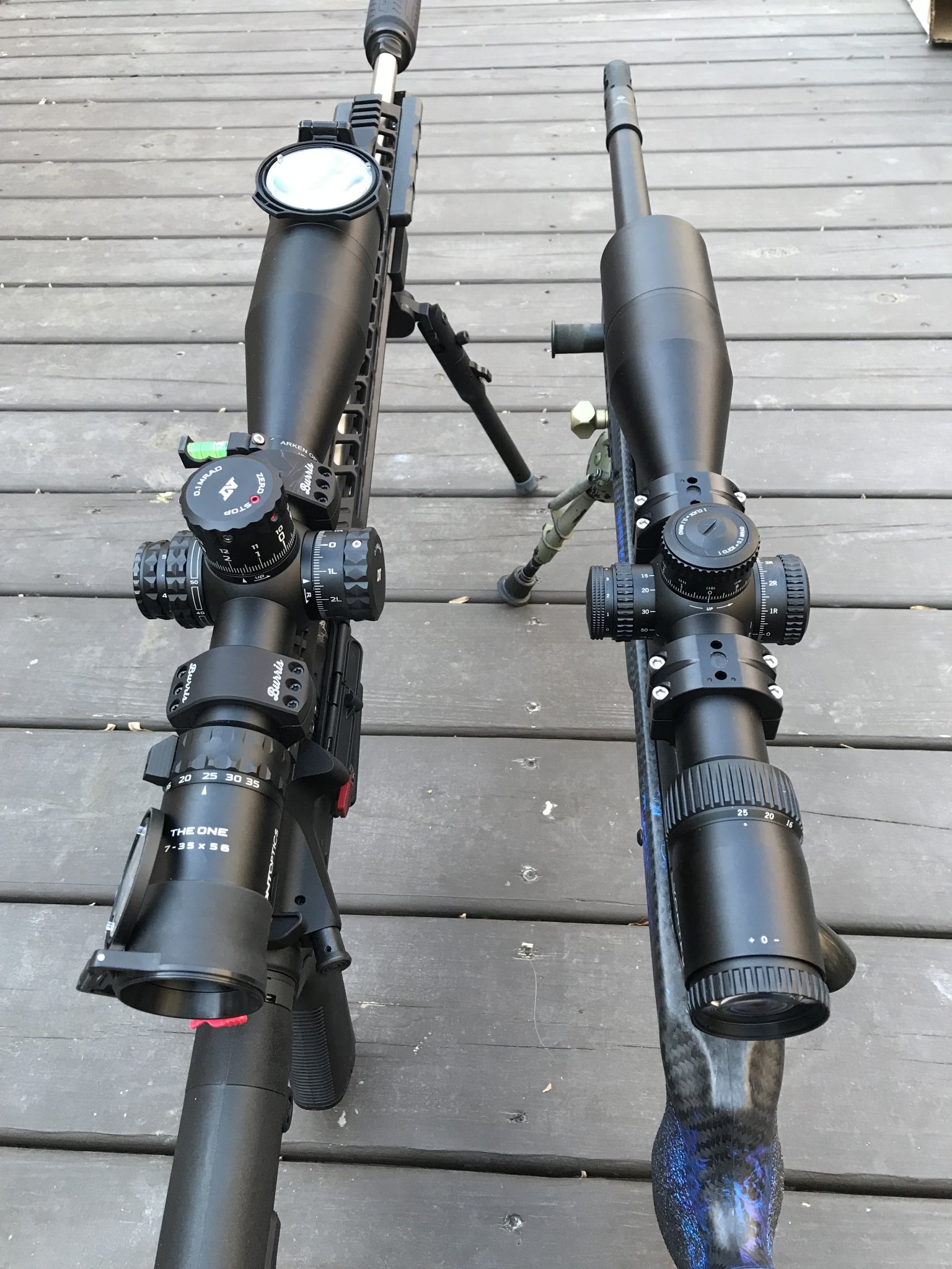

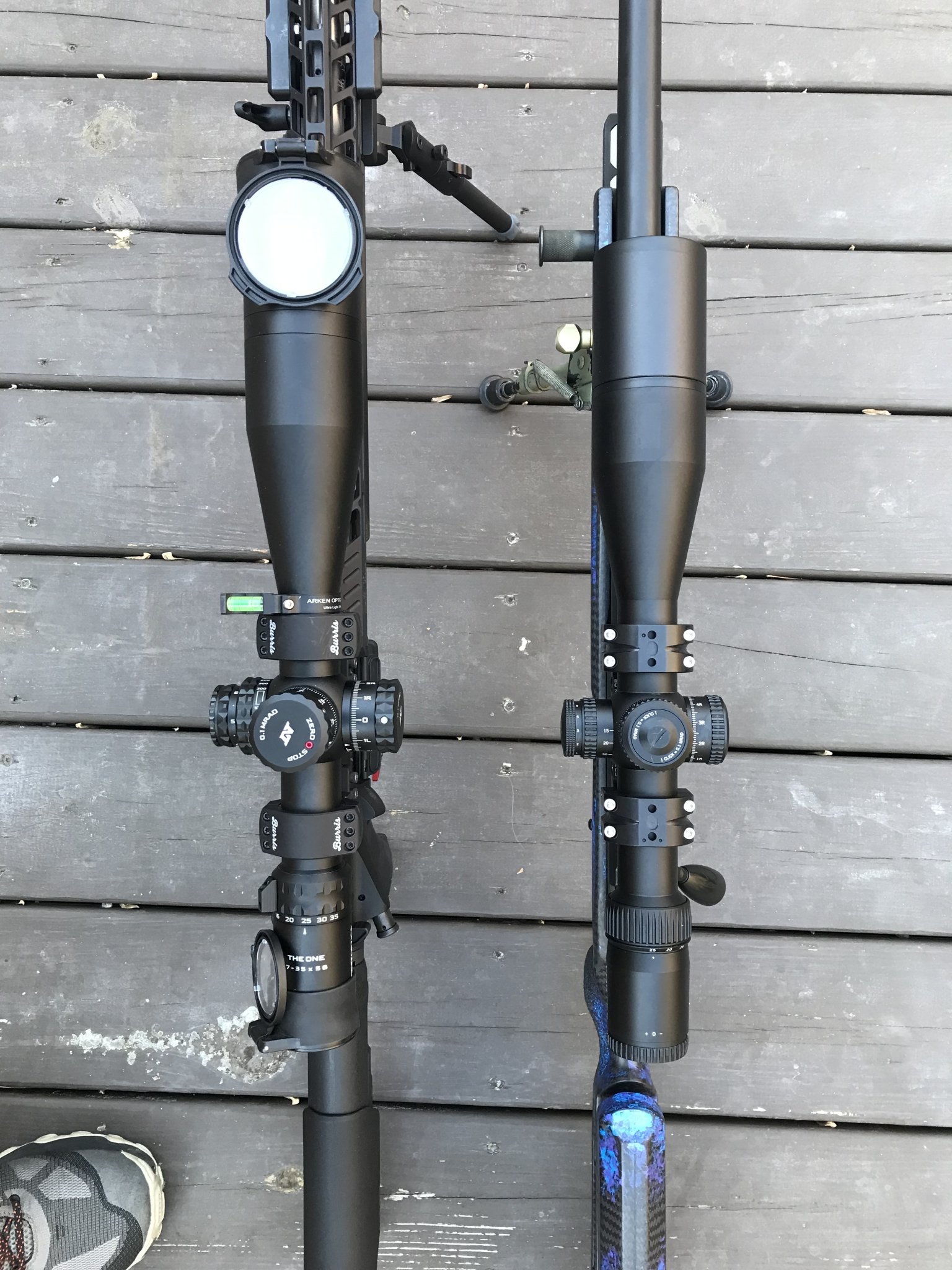

Well I got to do a side by side at the house when I got home and got the SE mounted up. I have about 80 yards into the woods and took looks through both at limbs and small objects. I will say both are better than the Bushnell. At 25x, the SE max, they both looked pretty much the same for clarity. I was actually surprised as I expected the SE to be a little behind being on its max and the DNT being a 35x and turned down to 25x.
As someone mentioned the Bushnell clicks are a little muffled but both these are better. The DNT is the louder of the two and I think that comes from the larger turret and the open area inside it. You can feel and hear both good though.
Something’s I did notice was the DNT had a little more black around the outside of the eye box than the SE. Nothing that is super bad like a 4.5-30 Tract but the eye is behind the SE was more scope glass and less ocular. I also looked at the FOV and the SE was about 8.5 mils and the DNT was about 7.8 mils so both have a good FOV at 25x.
Below are some side by side pics to give an idea of OAL and turret size. Honestly glass wise it’s pretty much a push and would come down to how much power you want to be usable in the scope. If 25x is enough than either but obviously if you want 35x then the DNT is the choice.
I am sure I missed something but that’s a little break down between the two.
