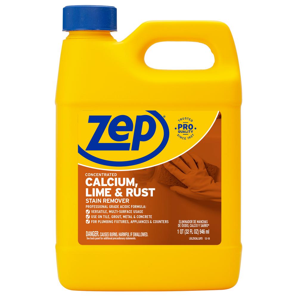

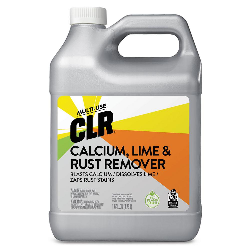

Guys,
Which version of CLR is the one recommended for cleaning suppressors?
I didn't realize there were two different products with essentially the same name until I went to pick up a jug.
Don't want to screw up by using the wrong one.
Even the generic store brand will be next to identical for you intended usage.
Check with the can manufacturer , all these chemicals are acid based and react differently with the different materials. CLR needs to be AVOIDED with aluminum and some stainless steels . All my cans are Ti and CLR is what is recommended by the manufacturer.

I'm doing this right now with a 30 cal can, alternating between both the name-brand and generic CLR. The generic works just as good.
