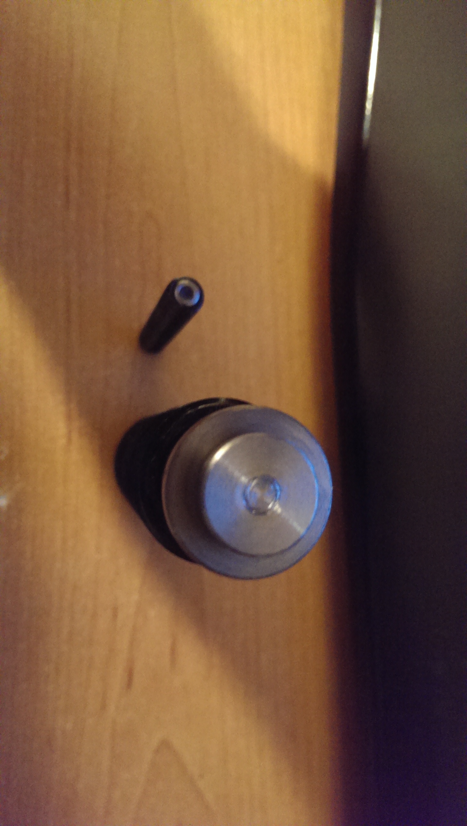

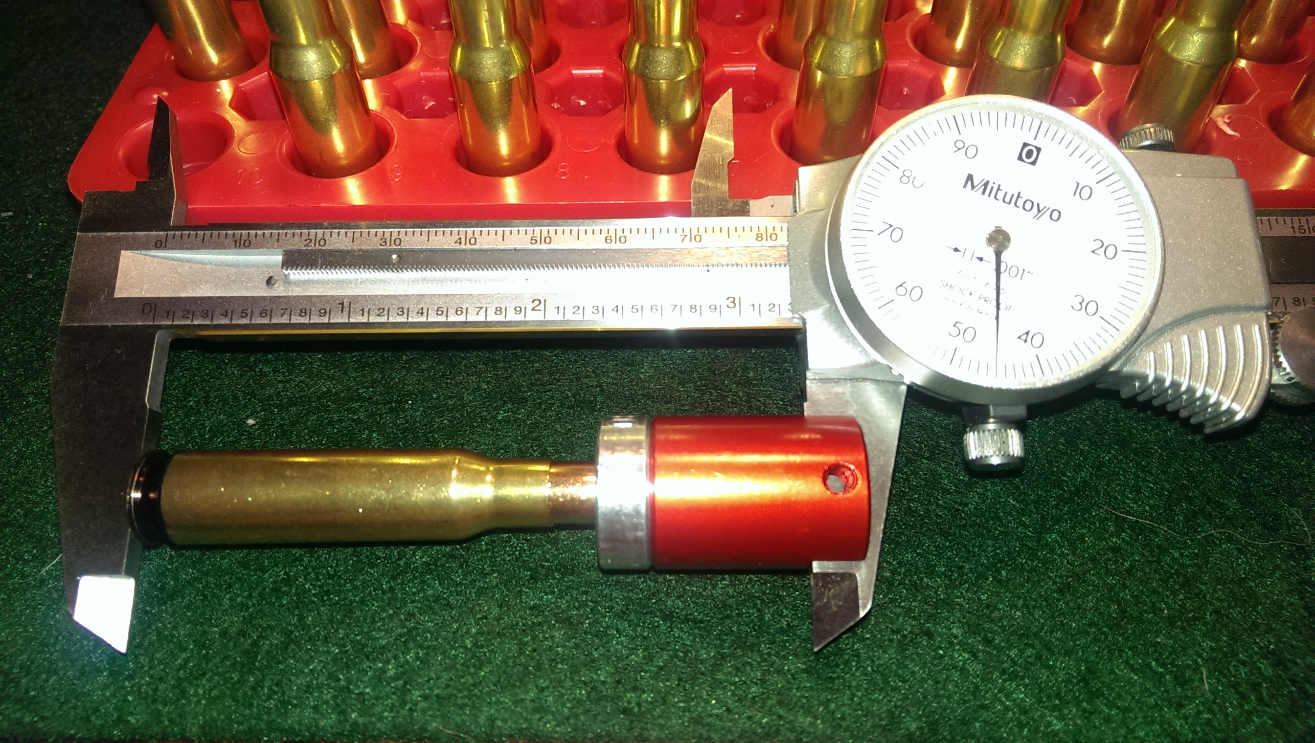

Received some goodies today! I already batch sized all of my match brass, so I haven't run anything through the sizing die yet. I did just load up 50 rounds, and I think I love the seating die. So far, it's loaded everything dead nutz to the depth I set. So far I'm super happy with my purchase, but we will see once I start sizing stuff in a week or so (waiting on my Bushy ERS to get cerakoted and shipped from CSTactical) :)
