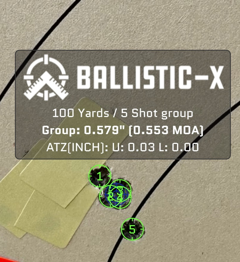

This is from Friday with my WOA 16” barrel testing 69 SMK’s with TAC
  • Ballistic-X-Export-2023-05-05 15:28:57.711970.jpeg

My 1st WOA barrel was a 16" and it did not do well for the first 100 rounds. I cleaned it and stripped all the copper out and it's been sub-moa since. I have no idea what reamer they use but it seems like their barrels favor the SMK and since it's a high power shop I guess that would make sense. This barrel shoots the IMI 77 really well too but not as good as my load with 8208 xbr.
Well… I cleaned the heck out of my WOA scrubbing it down with JB and Kroil on VFG pellets. Took bore scope photos before and after, and nothing re as llhh th looked out of place… the barrel looked very good actually.
Pulled off the SOLGW M89 hand guard, loosened the barrel nut and retightened it down super snug. Everything seemed good before and after.
Checked the gas block and it looked super tight at 12’oclock on the gas block and the underside of the rail. Took out the file and went to town on the handguard. The M89 has little pads/nipples sticking down from underneath the top of rail and I think it may have been touching the gas block. Got it all back together and could see at least 1/10” gap above the gas block now.
