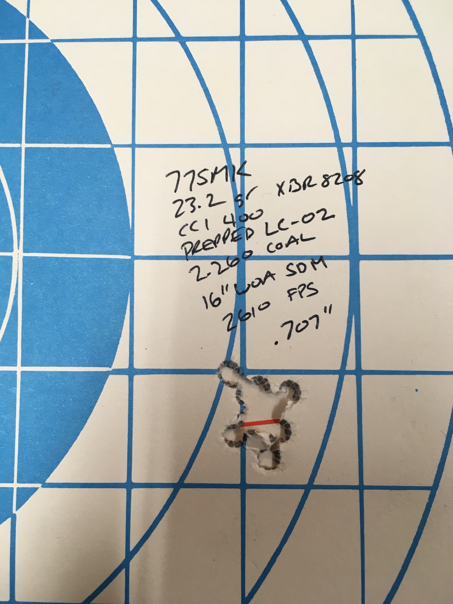

I have a 16” WOA SDM, it seems to meet your requirements, and I would recommend it. I’m not the best semi shooter but here’s 10 from finalizing load development. I found that a max charge of XBR under either an SMK or TMK edged out anything else regardless of brass (various sorted LC).
