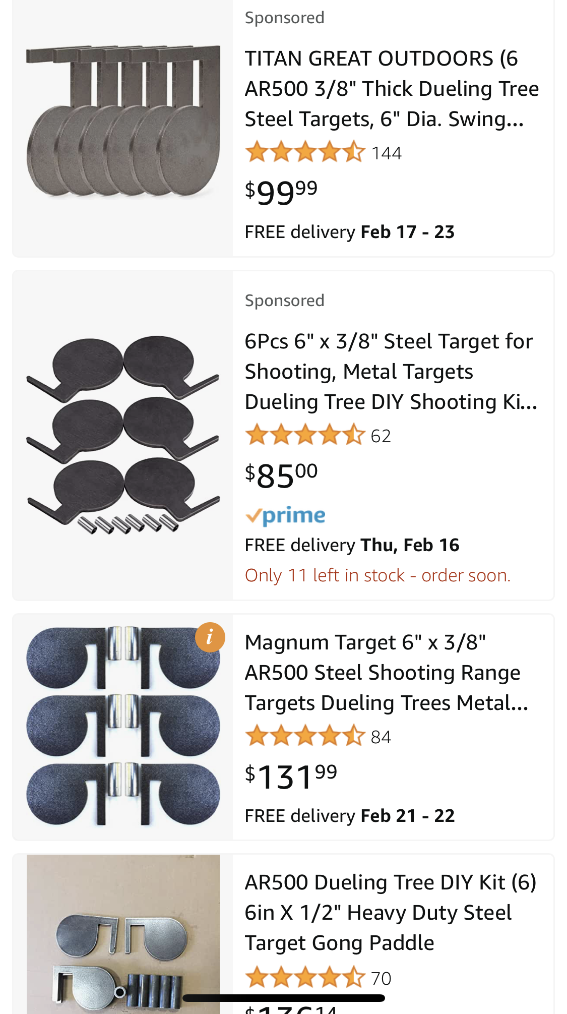

    If you have the ability , I’d say build it. There are a few sights that offer “kits” and you just do some mild welding and cutting. My tree and star were built that way

    A dueling tree is probably the lowest maintenance of them if built with plates to protect the swinging sockets. Just buy any decent set of plates from somewhere and weld up your own. A friend did that and it’s great fun. Just make sure that you angle it forward a bit so that frag goes downward.

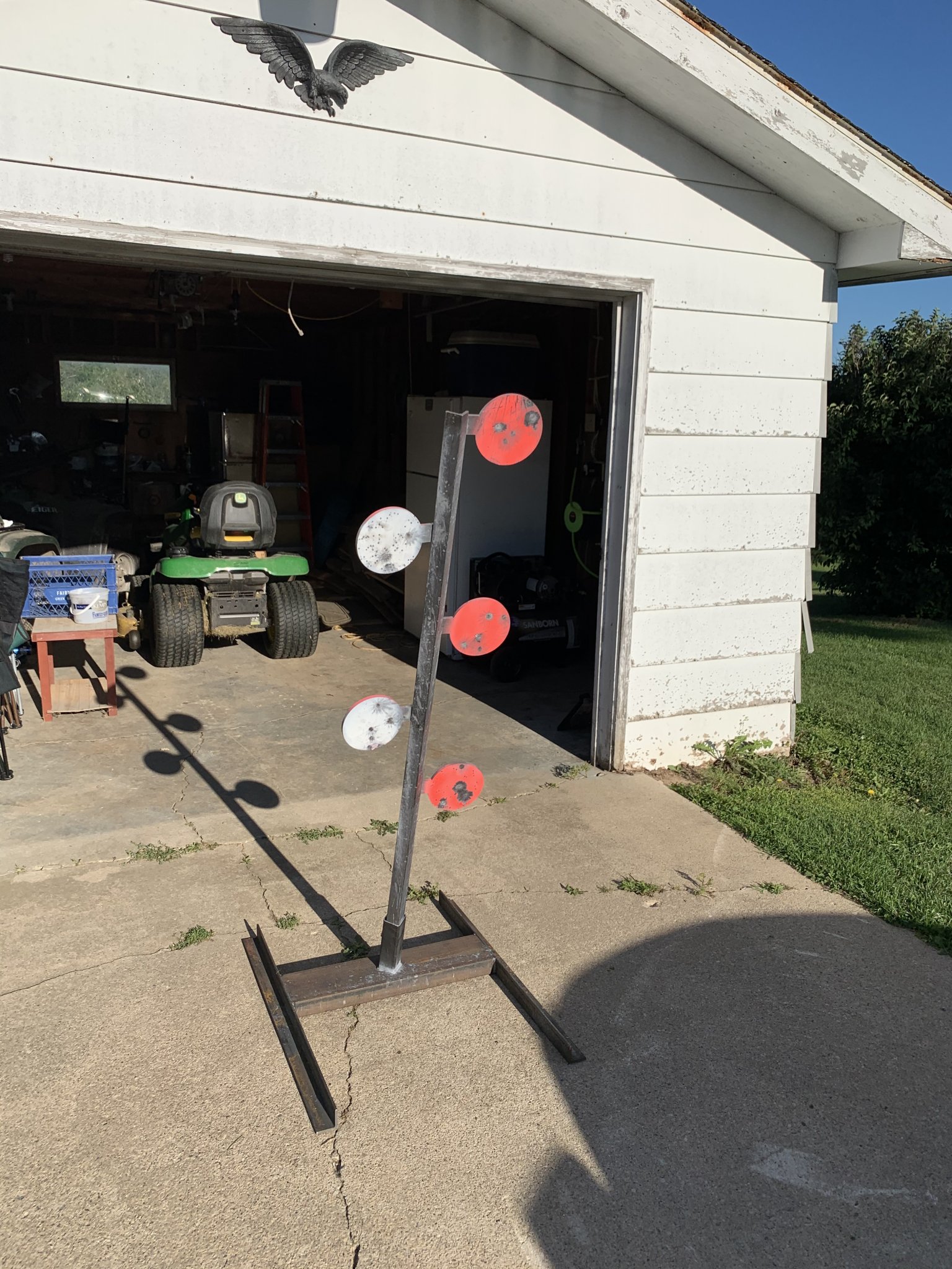

    Got the old lady a dueling tree last year for Christmas. It super fun to just be able to walk down the hill and whip her ass. Every time I win I get one less round the next time we shoot. Ive won some good favors with it, definitely got my moneys worth out of it and it has a ton of life left. Doesn't suck having a significant that wants steel instead of diamonds for Christmas. And lead, lots of copper washed lead. Woman goes through 9 like its her job. I'm pretty sure she thinks the ammo fairy comes at night to refill her ammo can.....because he does.

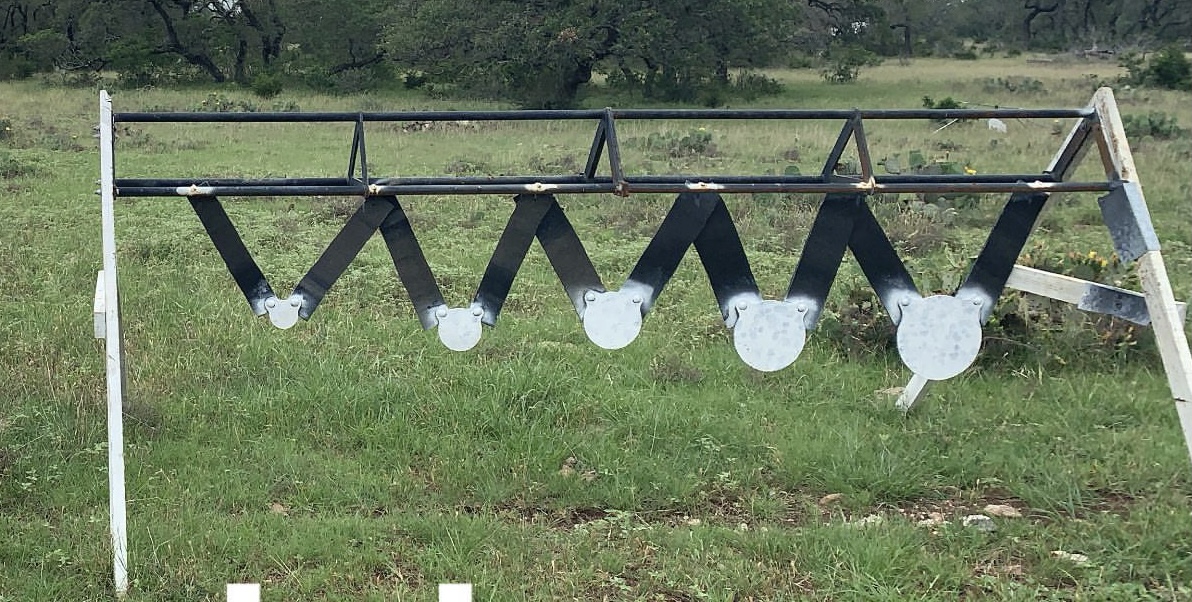

    I bought a kit of plates a while back for the dueling tree. Buddy wanted to make a setup so he asked to borrow the plates. As a thank you he welded up this entire stand and tree setup. Also made me a set of .22 plates and another full set of AR500 or 550 rifle plates
    Works awesome. Have used it with AR’s and .22. With .22 it’s an absolute blast. We’ll do timed/limited round comps with 5 rounds in 3 seconds type of thing. Ruger 10/22 and MP 15-22. You can dust a box of cheap federal bulk ammo in a hurry
    Has 6 plates. Shown here with 5 obviously
    Reactions: diverdon and lash
