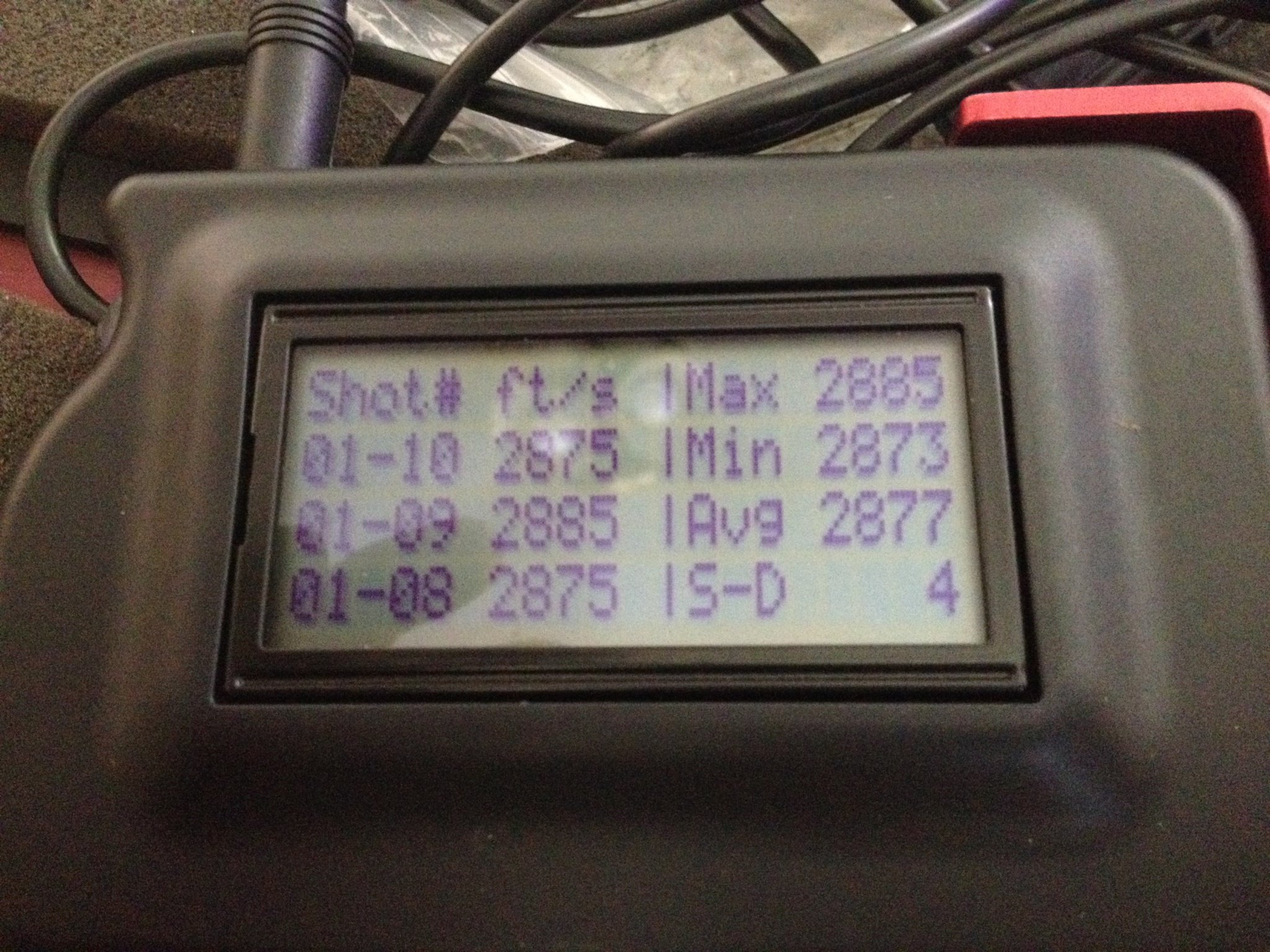

Starline LRP 6mm Creed brass. Virgin on a new barrel then once fired with 100rds down the barrel. Same load.
