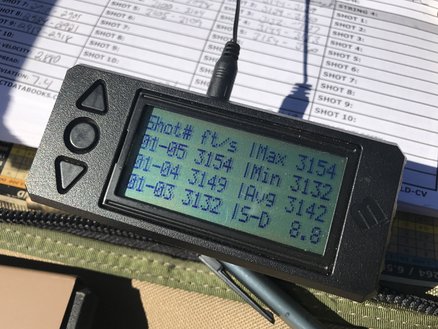

    Here is a Hint -
    4166 - Average MV 3098 / SD 8.0 D'oh!
    Varget - Average MV 3142 / SD 8.8
    H4350 - Average MV 2918 / SD 8.0
    guess i I got what I was looking for lol
    stick to the wilds of AK Old Reliable
    41.5 of 4166
    43 of Varget
    44 of H4350
    Varget load was 3.8 mils to 800 yards
    the slower H4350 was 4.4 mils and low so 4.6 maybe
    time to load em up and gonna use the 4166

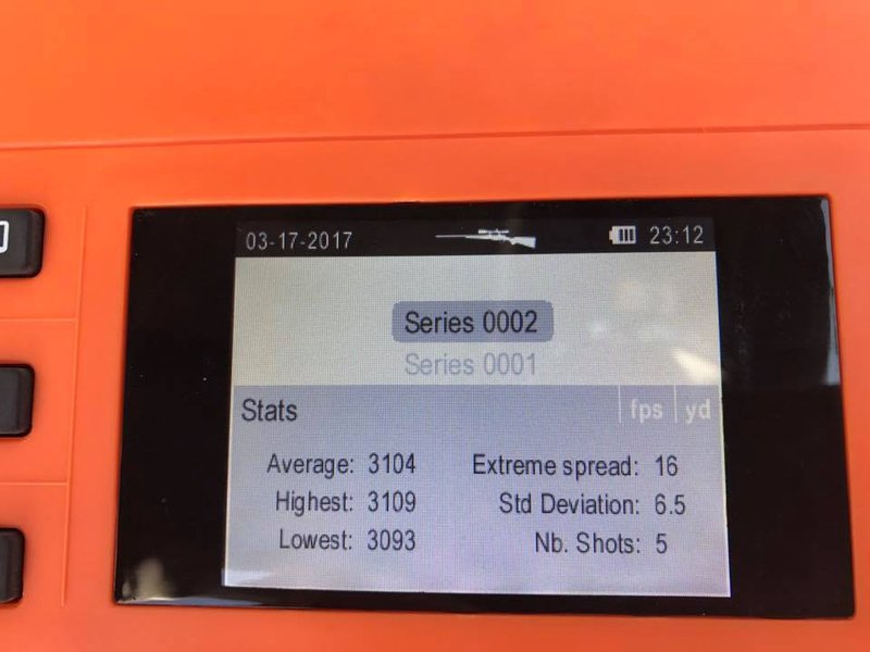

    LabRadar SD on the 4166 was 6.5fps at 3104fps ... you know that speed I was talking about along with the SD you tried preaching ...

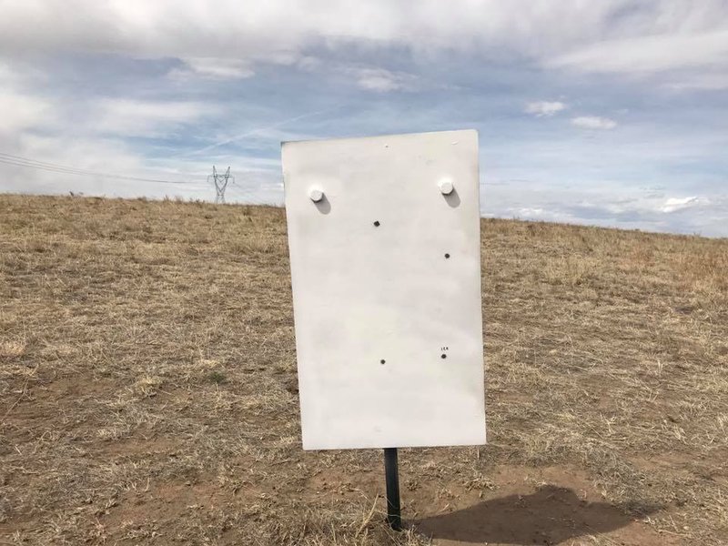

    I should be done with everything come Wednesday next week then I can announce it all ... video, details. etc...
    Now to load up 41.5gr of that too fast 4166 at 2.820" ... then take them to ask at the range out as far as the conditions will let me.
    Too many powders, so little time, next round we can try 15, I may have some in the Connex if I remember right, I know I have 17
    At least I eliminated H4350 as a viable solution. Really, Varget is plenty, 43gr at 3150fps with an SD of 8, I need to play with seating depth as the accuracy was the worst of the bunch.
    But out of the gate, the 4166 was on, and I loaded the least of them up. 3100 is plenty fast and it was sub 1/2" out of the gate.
    Solids, but the nice the thing, you can mix these with jacketed, POI was super close to the Prime 130s as I used them to zero maybe a click off.
    Tuesday is looking good to take them out, plan on hitting a Mile with them
