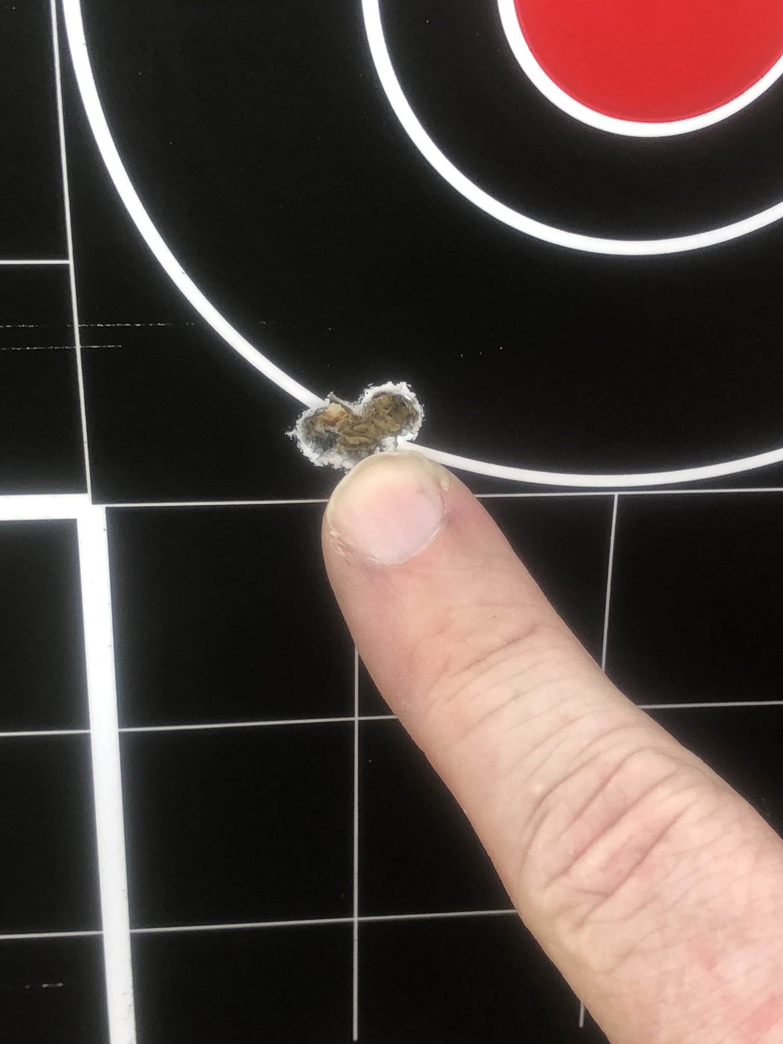

    I'd also vote to try BA. I just built a 308 AR10 using a bull barrel from Ballistic Advantage ($266) and I was able to land 2 hits in a row on torso sized steel out to 900 yards. I was mostly load testing for pressure on the first visit, ran out of ammo before I could try 1000 yards.
    It looks like it will end up being a sub MOA rifle once I get comfortable with it. The head spacing with my JP bolt is also right on.
    The feed ramp edges were razor sharp and needed a little smoothing to save my brass, but that only took a few minutes to fix.

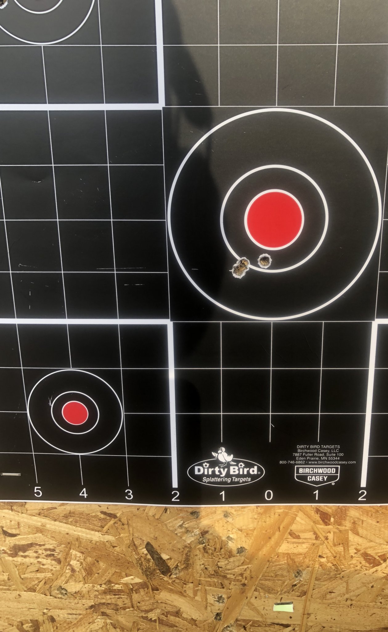

    Rainier Match or Ultramatch- I’ve got 2 of the UM’s and they can produce sub .3moa 5 shot groups with the 73eld-m bullets (Thanks Padom). The Match barrel has done great with the 75 hpbt, typically .7 moa or better.
