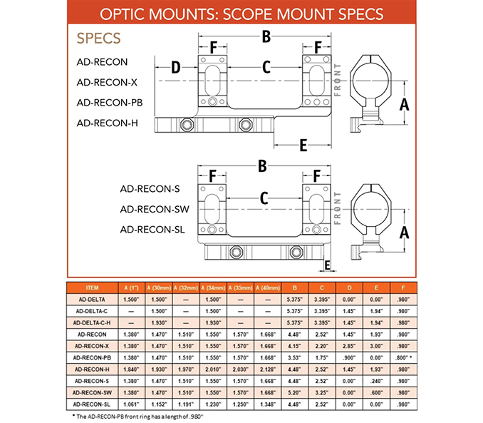

🔸 The manufacturer AD is a bit stingy with details of their mounts, but finally I found a specs sheet (the one that is really lower is not cantilevered, so no joy) (cf. image):

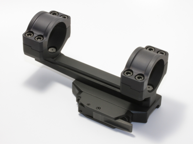

🔸 $253: Bobro Extended Precision Optic Mount (add $15 for 34 and 35mm)
1.575" low* | Cantilevered 2" | Tube sizes: 1" | 30mm | 34mm | 35mm
⭐ 0 or 20MOA**
⭐ QD (choose lever to be on left or right side)
Link: https://www.bobroengineering.com/Extended-Precision-Optic-Mount_p_20.html

* The Bobro webpage says: "Height: 1.420" from top of 1913 to tube center." For the Extended mount: 1.575" ➔ Well, for which tube size is this true? I am going to assume it is true for the most common tube, i.e., 30mm, and so 1.420 isn't bad (1.575 less so). The mount base would have to be progressively lower if this same height applied to 34 and 35mm as well.
** Careful (unless I'm thinking this wrong): If you want mount your scope further forward with a cantilever mount, the MOA cant will work for you. But, if you want to mount your scope further backward with the cantilever, the MOA will work against you, you will have 20MOA less elevation adjustment available in your turret with a mount with MOA cant. In that case better buy a 0-MOA mount. | For this latter arrangement, only the Burris AR-Signature QD P.E.P.R. Mounts allow you to increase MOA cant because the 20 MOA cant is not built into the mount but is achieved with shims.
