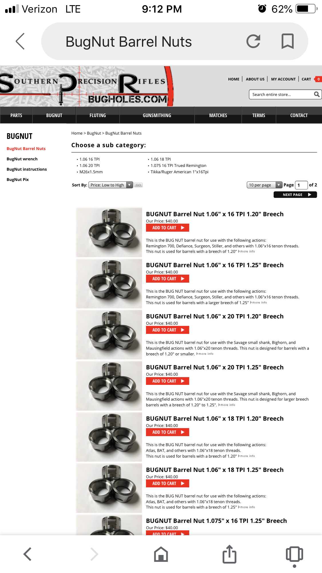

Bug Holes BUGNUT $40

I've tried the BugNut, PVA and NSS. The BugNut is nice but leaves a large gap between the shank and nut. The PVA works well and looks nice if your open-end wrench does not slip during the installation process. This tends to leave a shiny spot or at worst rounds off the corners. I ultimately went with the NSS for a few reasons. Outstanding customer service and they are the only manufactures that advertise any details on the manufacturing process i.e. squared and trued and heat treated to a range of 38 to 42 Rockwell hardness. Not to say that other manufactures don’t do this, but it’s not mentioned anywhere on there website. It’s a little more money for a wrench if you don’t have one but it will not slip like an open-ended wrench will.
