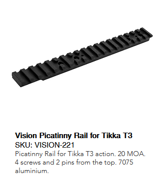

    Probably the most secure picatinny rail for Tikka is the Norwegian Vision chassis manufactured rail.
    It goes to the Tikka 17mm dovetail groove, and then you secure it with the 4 screws, ho tight is that ;)
    Hmmm ... their site says not only the 4 screws, but 2 pins as well, which is even better:
    I’ll take your 4 screw 2 pin wager and raise you 1 screw and 1 pin! See vid on page.
    (Near Mfg specs unknown, but he’ll probably make what you want)

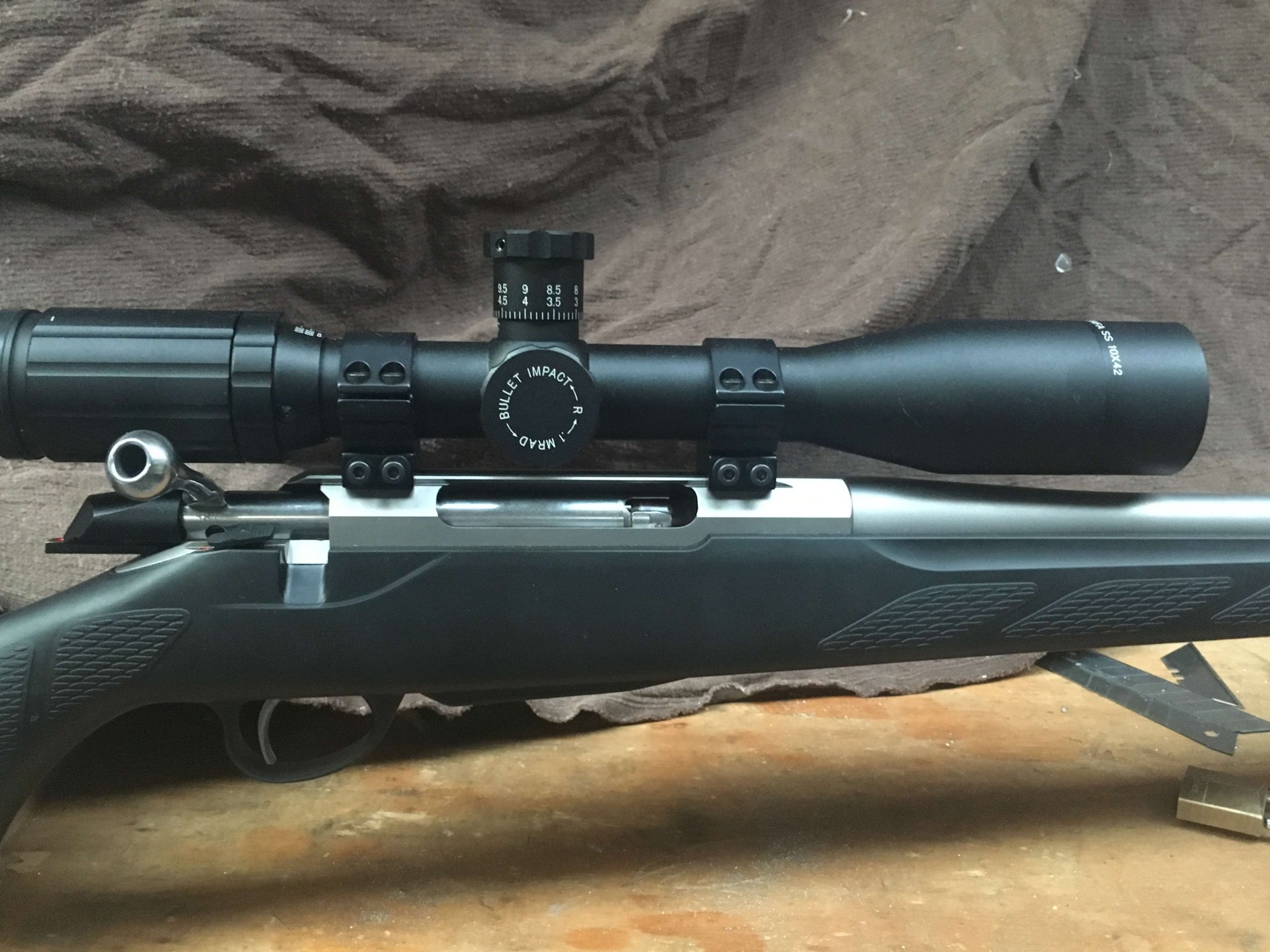

    This picture you can see the rail mounted.
    It slides over the action, and the Tikka dovetail.
    For sure the 2 pins are good to add, hold the recoil the best way.
    I might even add some lock tite, for permanent hold.
    Sliding over the dovetail is a nice detail.
    I've used Red Loctite on other Tikka rails, which has worked well.
    It's a shame that GCP's contact form is not working, nor is Chris Ritchie's email ... they're not making it easy to order this rail!
    I can’t see how the Vision attaches, but if I’m reading correctly, it sounds the same as similar ones I’ve used on Anschutz before, temporarily. The problem is that dovetails and bolts fight each other on these dual-mount rails. The dovetail needs to be pinched or pulled up to engage, while the screws are doing the opposite.
