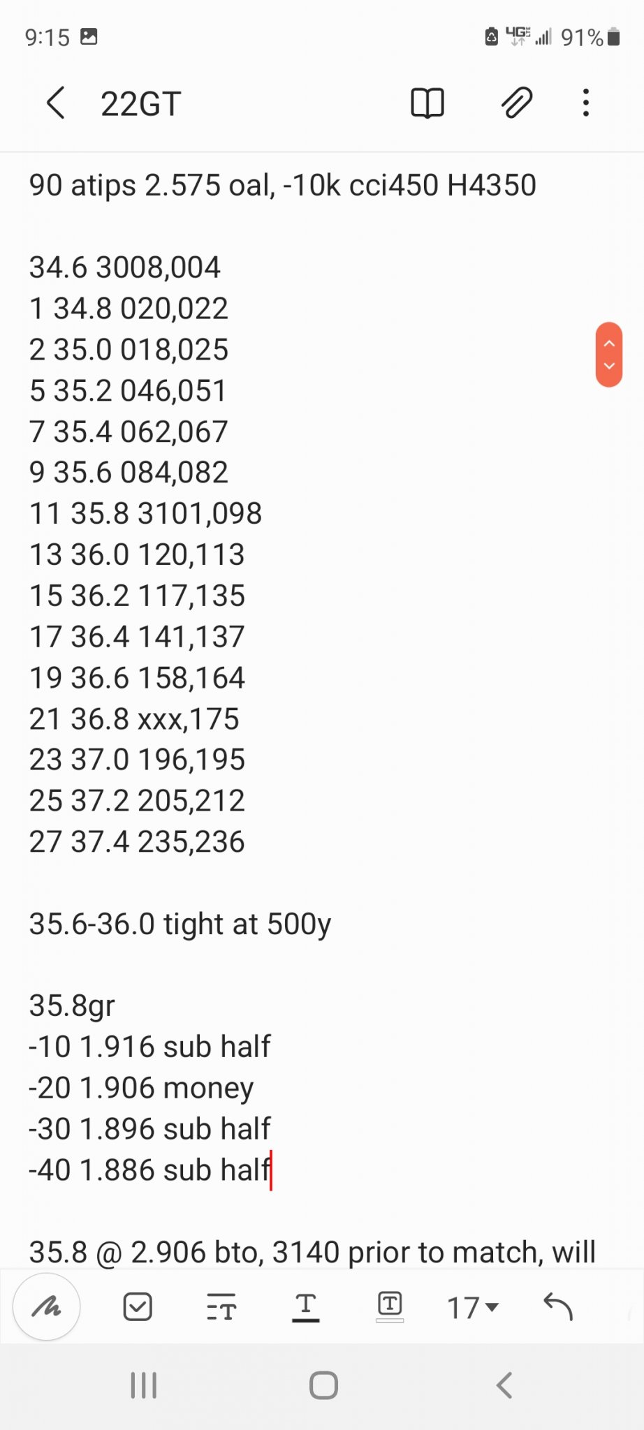

Here's my data, broke the rifle in with 100 rounds of 88eldm 34.5gr H4350. Then shot a ladder with 90 atips. 3085-3110 had like an inch of vert at 500y. Loades up at 3100fps 20k off lands was 3 shots touching at 300y. Prob easiest load development ever.

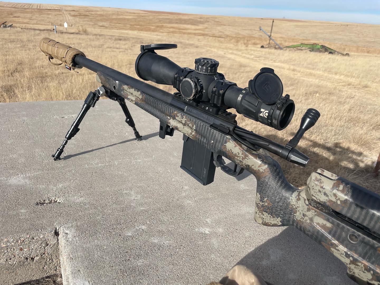

Bighorn origin
Hawkhill 7tw 219 bore hvy varm @ 26"
Gen3 fat bastard
Arc Xylo chassis
Gen3 razor 6-36x56

22inch bartlein carbon 1-8

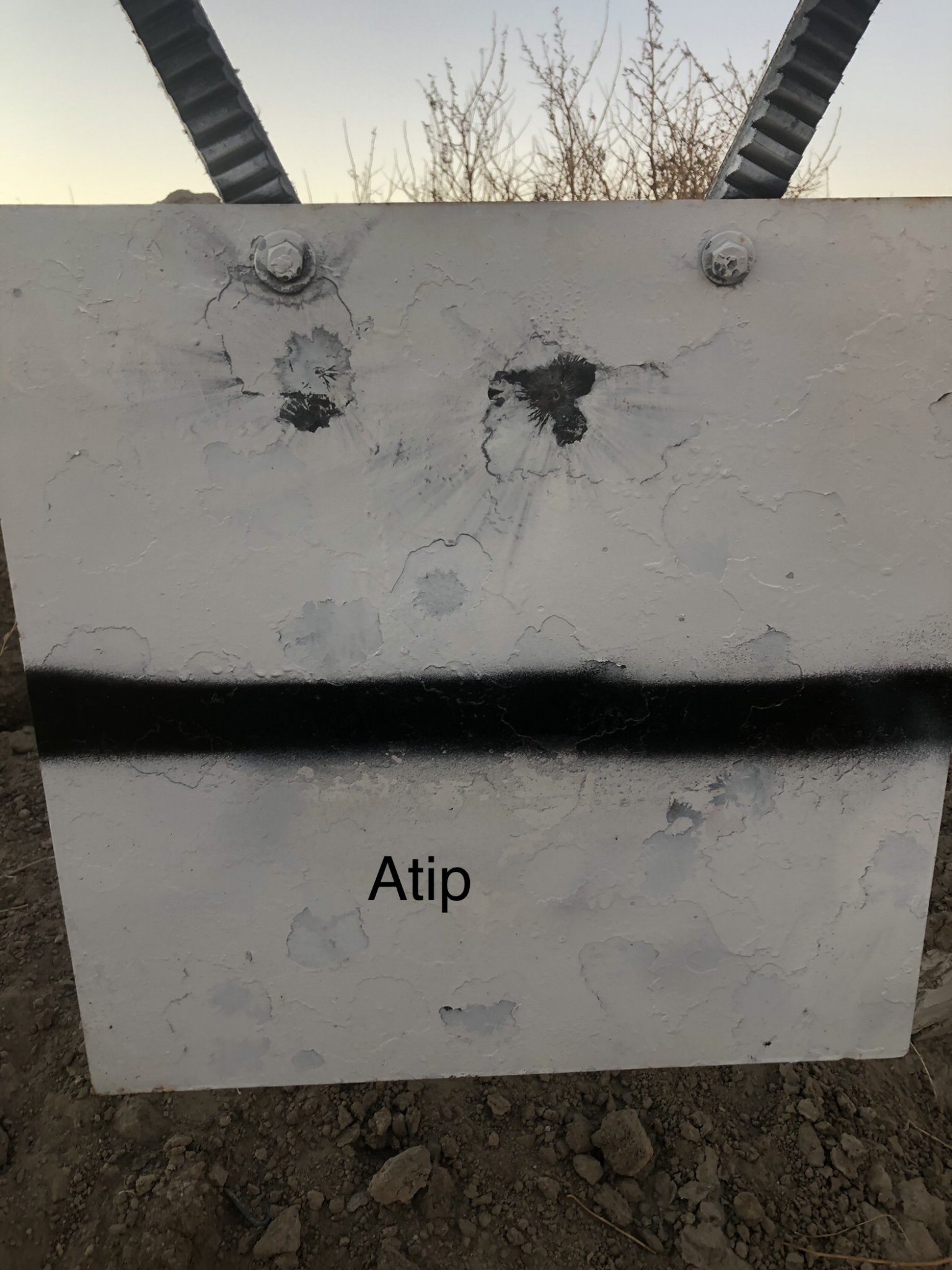

Atip is running 2950 with 38.4 rl26

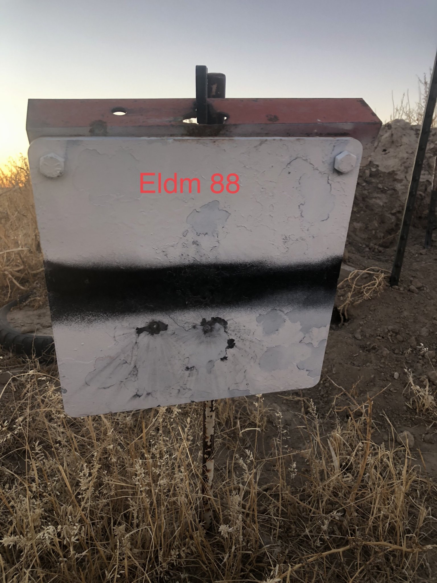

Eldm is running 3030 with 39.4 rl26
Two shots each at 980yds
Small plate is 10” for reference
For cost and availability of bullets I’m sticking with the eldms.
