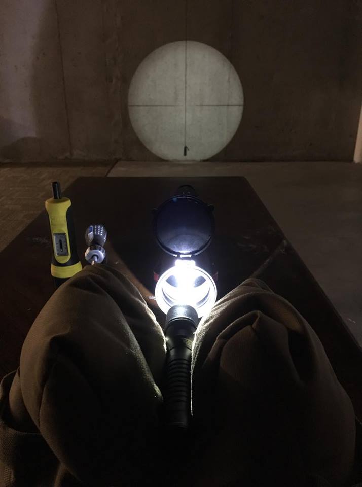

    If its always .4 you are at least consistent.
    Most likely, Cant. I can consistently mess my cant up by just going with what I think looks level. Its taken me a LONG time of comparing to my bubble level to figure out that to me, what looks like a slight cant, is actually level.
    The best way (not the cheapest) is to mount your scope in something like a Badger Dead Level, hang a line that falls true with gravity and project your reticle onto the wall and make it perfectly level. Then you can set your bubble level up on your tube and level it with the dead level or the hanging line.
    You could do the same thing if you have a really good vise that you trust to keep your rifle level once you start messing with it and the scope rings.
    For reference -
    -The other thing like people have said is your trigger control. You may be doing the same thing EVERY time, but if its wrong you'll be consistently wrong.
    -Something else that I didnt see mentioned (depending on caliber) your position could be a cause. If you dont have a good NPA and managing recoil properly, you could be consistently allowing it to recoil and move before the bullet leaves the barrel. Similar to an elevation change from prone to a compromised position.
    Reactions: ROT
