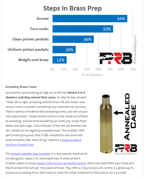

I have to say that Im surprised to hear you guys say "don't anneal". Im not saying you are wrong at all. And I will certainly give that a try. But it seems i read more of "annealing is the bees knees" so to say, and that everyone should do it.

Here's a good article on annealing:
Even with the Pro's, they all do not anneal. But it seems that has a lot to do with the custom chambers that don't work the brass so hard. If you haven't seen this article before, check it out (the pic is from that article):

Annealing is awesome when it’s needed.
It’s a waste of time when it’s not.
