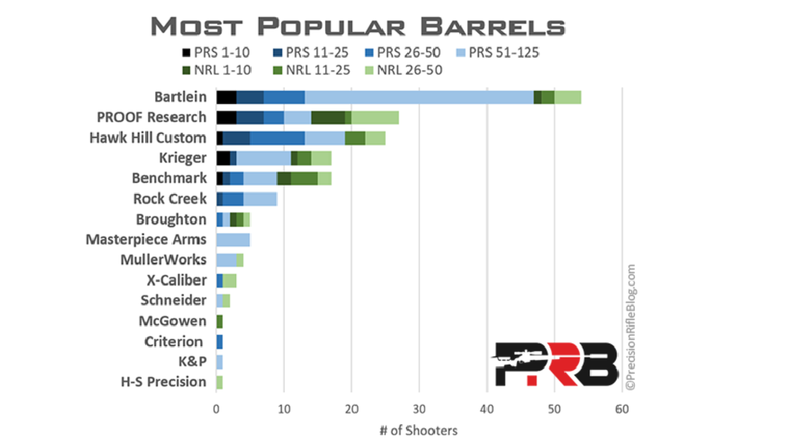

Here is an image of the most popular barrels used by precision bolt action rifle users in the NRL/PRS, and next to Bartlein at the top, and ahead of Rock Hill, Krieger, and Benchmark is Proof Research. And nowhere to be found are Dracos, BSF, or Christensen. Are these 3 other offerings just gimicky or not truly sub-moa? Not only is Proof the top carbon fiber choice for PRS/NRL, it's also the top choice amongst those spending on a high-end or light-weight AR build, and I would like to know why that is. I really want a Dracos, BSF, and Christen barrels for different builds I'm doing but what does the community think of them vs. Proof Research?
None of the top shooters are using carbon wrapped barrels, all those Proof barrels being used in PRS are the stainless steel offerings.
Also, Proof barrels are cut rifled. I don’t think any of the other CF wrapped options are.. so probably why they’re so popular. Proof makes a very high quality barrel.. as said though, very few people are using carbon fiber wrapped barrels in competition. Weight is a good thing in a match rifle, and the top shooters are burning thru barrels so fast that running CF barrels would be way too expensive for no gain in accuracy at all and a rifle which is harder to shoot due to lower weight..
Main application for CF wrapped barrels is hunting, not precision competition..
I think CF wrapped barrels are used a little bit in 3 gun though..

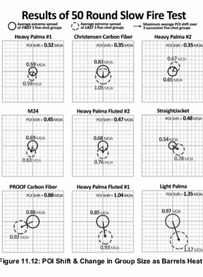

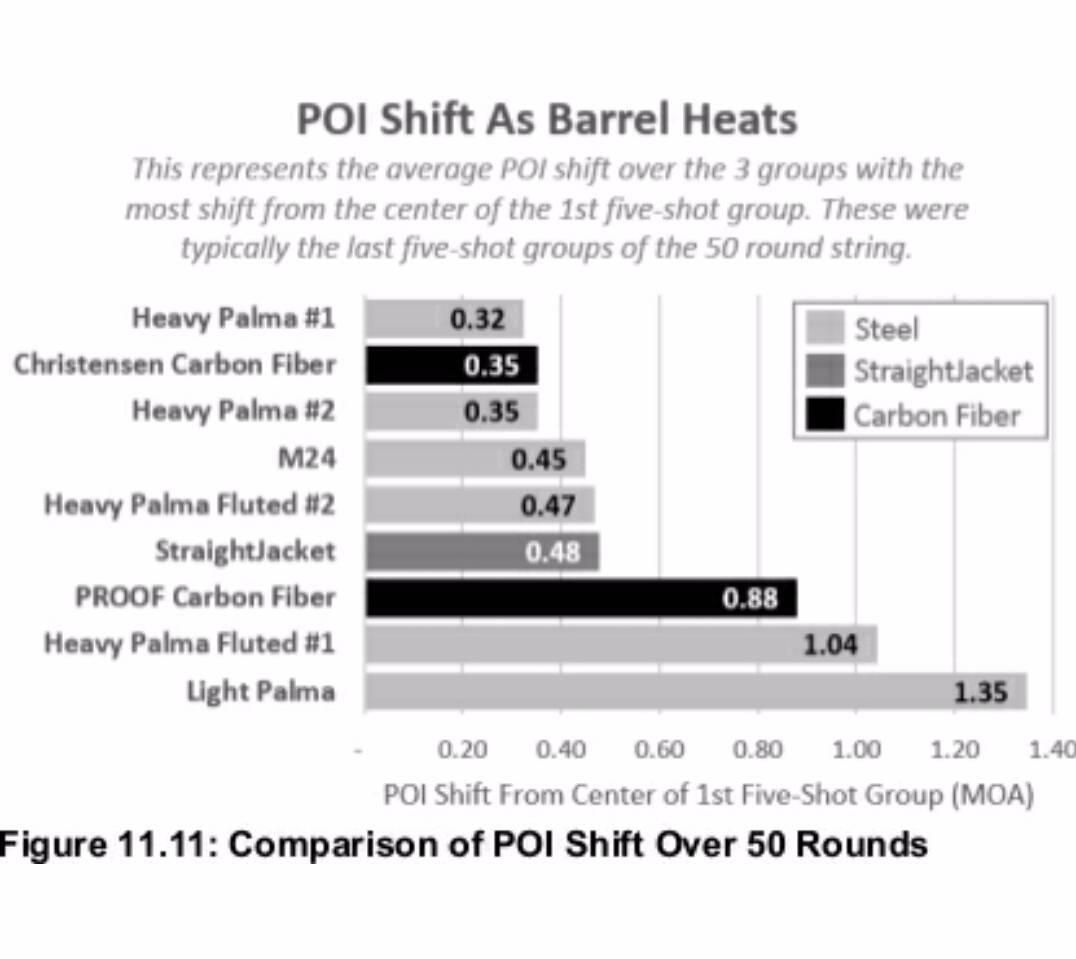

Heres the article I mentioned earlier..
https://www.gunsandammo.com/editorial/hammer-forged-rifle-barrels/328799
Results are pretty surprising to me honestly... common wisdom is that carbon fiber is an insulator. Somehow Proof has managed to figure out how to get them to cool quite quickly. Basically, while it initially gets 29 degrees hotter than a fluted SS barrel of slightly smaller contour, after 10 minutes the Proof CF wrapped barrel has caught up to only being 4 degrees hotter than the slightly smaller contour fluted SS barrel..
Impressive.
I wonder if a chrome moly barrel would have any different results..?? Chrome moly handles heat better than SS, though you won't get a barrel hot enough with a bolt action to see that difference.. it'd have to be a full auto.

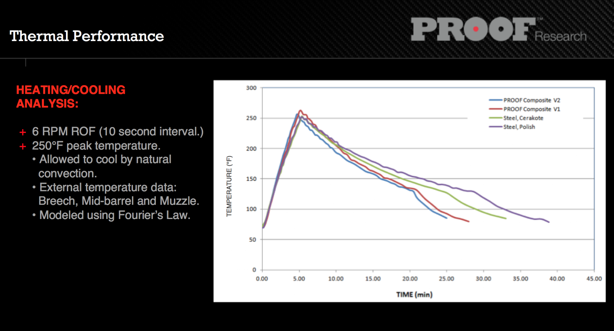

I work in the carbon composites industry,
How fast the parts cool after I pull them from the oven and separate them from the forms is amazing.
You can comfortably hold them seconds later.

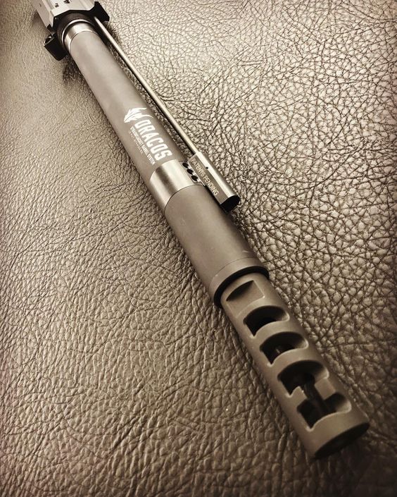

BSF is carbon sleeved with an air gap. Totally different than the others. That being said, I have a Grendel that shoots very well.
Would Dracos barrels be a better comparison to Proof and in what way is one or the other superior?

I’ll post the article when I get home. A fella did a comparison of fluted SS barrel vs unfluted vs Proof CF.. the Proof CF barrel to my surprise did seem to cool down faster than the other 2.. HOWEVER, the Proof barrel got way hotter to begin with.. 180 degrees vs 150-something for the unfluted and 160-something for the fluted. After 10 minutes, the unfluted was down to like 105, the fluted was at like 125, and the CF wrapped barrel was like 127 degrees.. so to be sure, it appears Proof has somehow turned what’s usually an insulator and got it to dissipate heat quite well, but the steel liner is so light that it gets way hotter to begin with.
I’d love to see the results of a test with just the steel liner without the CF wrapping vs the CF wrapped barrel, as well as a chrome moly barrel thrown in to see if the different steel has any effect..
Thank you for the article, and if I was doing 3 gun or active shooting at the range where I'm going through a couple of mags in short periods of time, would caron fiber not be an ideal barrel for that use?
Dracos messed up when they advertised "Lifetime warranty"
Their catch is their magic filling wicks away heat and the barrel nvr heats up and nvr wears out. Pretty funny actually...
If you fall for this, and send in a toast barrel not shooting anymore they will just say its still within their accuracy specs.
Ask me how I know.
Also they nvr had the accuracy to start with either is the shitty part. More than 3 barrels experience with them with mine and my friends. Still cant get mine to shoot and its BNIB lol...
As mentioned, and Im on the fence of all carbon barrels being snake oil, Proof is easily the best and the only reason I would say not all carbon barrels are snake oil and the only one Id own if I didn't shoot out barrels so fast...

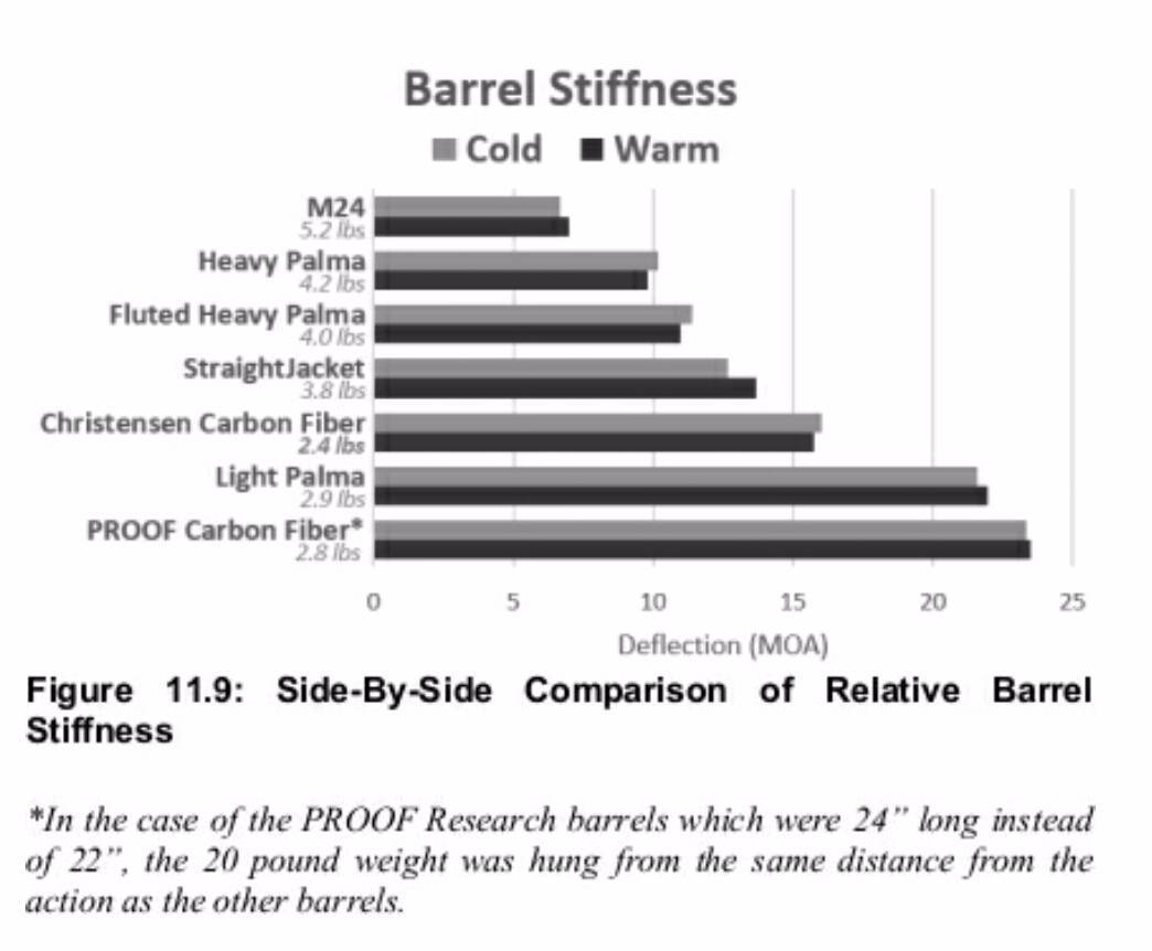

Also here's some of the testing results on these barrels from one of Bryan Litz's books.

That test was completely flawed and debunked as being BS...
The mistook mirage off the barrel for shifting or walking, they didn't know what they were doing

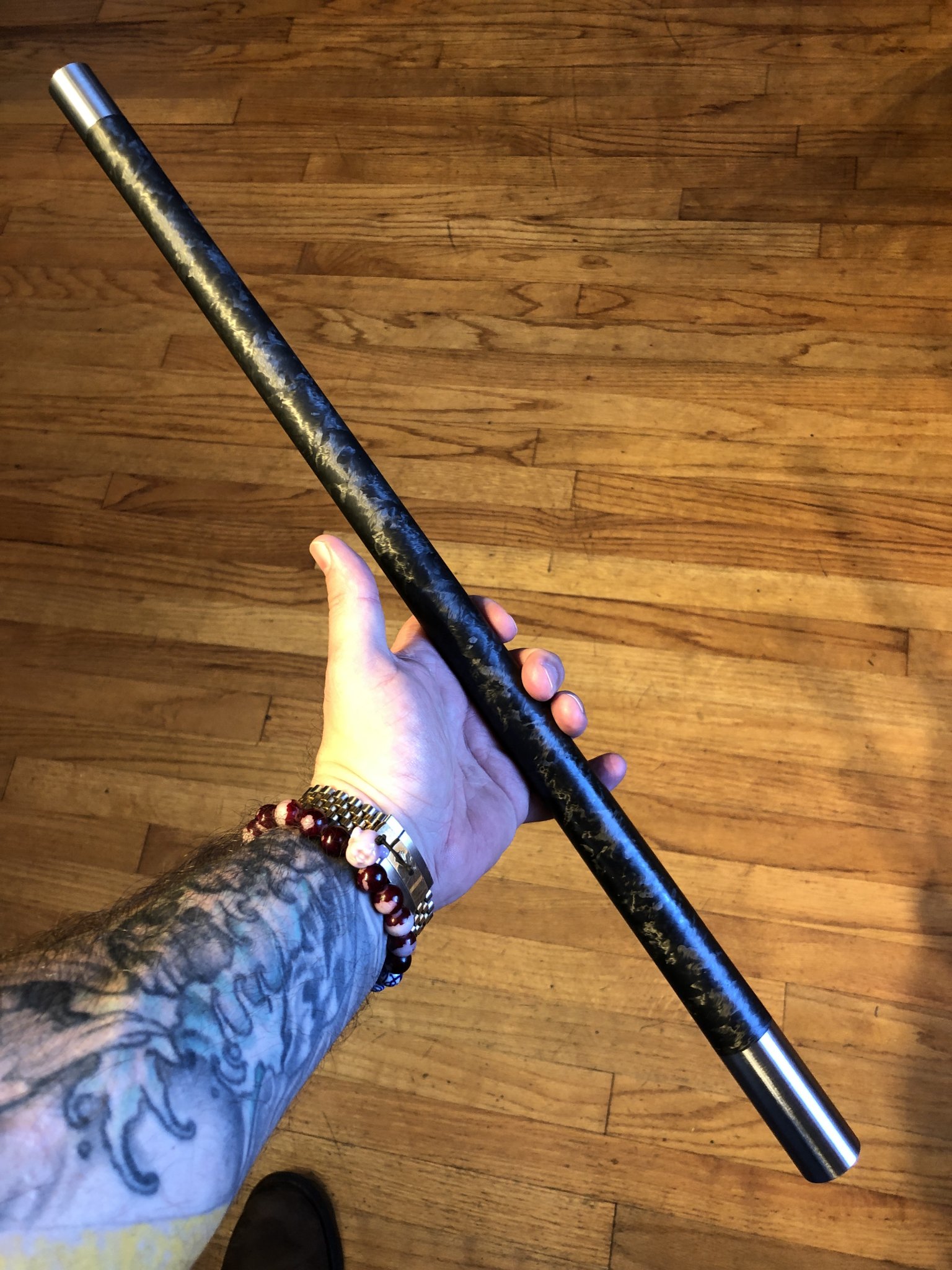

This came a few days ago.
Carbon Six in .264 @ 21”
Ordered for a Tikka action.
I’m not sure what to build.
I have had great luck with my previous CS barrel.
Hoping for the same on this one.
