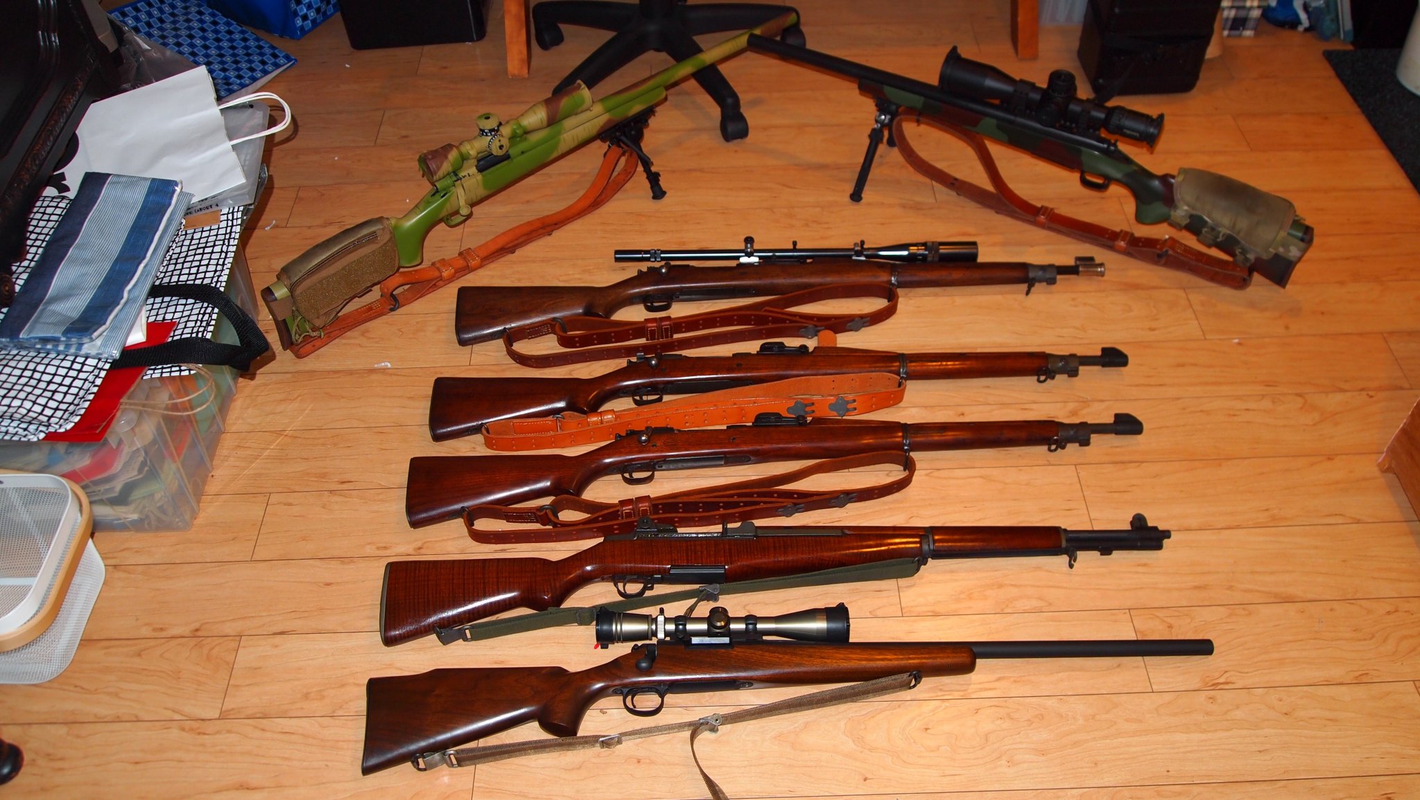

When I moved to AZ two years back, I had to divest about 2/3 of my rifles, etc. That one took some time and thought; they were going to my offspring and her offspring. They got my good hunting rifles, a priceless Win 70 30-06 Featherweight, and my Savage Predator Hunter 260. My 94AE Trapper Carbine 44mag went to the Grandson, the Cricket to the littlest Granddaughter who is now 10. My 12ga shotguns and a few rifled 20ga went to the general gaggle. Two of my three 91/30's went there too, and remain the most prolific deer harvesters among the bunch.
What I kept were the Savage heavy barrels and the Stag, my 20ga semi's, and my military rifles, a prewar Garand, a Yugo 66A1 SKS, a 92/30 in an Archangel Stock, and the Savage Scout 7.62x39. I have added second Stag Super Varminter, and another Savage heavy barrel, and acquired another three 16" uppers for the Stags since our eldest Granddaughter joined us here in AZ.
What I kept were the ones that gave me the most fun in my dotage. Cost is not a significant issue either way, nor is resale value. I won't keep a gun that won't respond to load development. Some nice ones got away when times were tight.
I've owned the others, the 700's, the 77's, and more, but I keep coming back to the Savages because their accuracy and their character suit my own quirky constitution.
