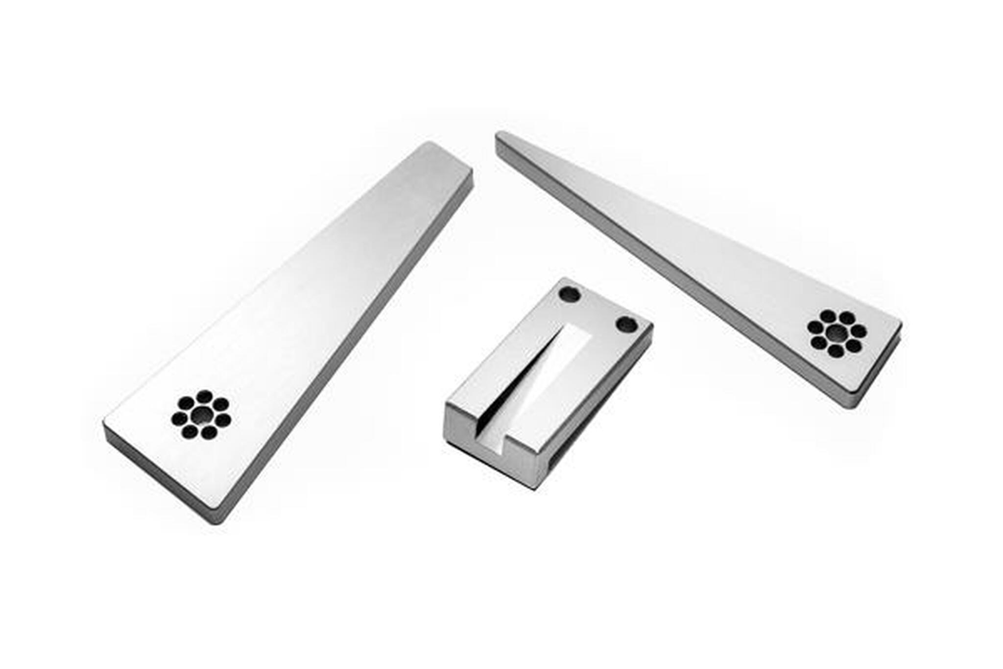

Couple of examples
Couple of examples
What would the real world advantage of that be over a smooth, known flat surface?
Assuming your mount has a flat bottom.
So, exactly what flat, smooth, completely level surface that can secure a scope and rings sufficient to hold it steady while you level and tighten the rings are you envisioning.

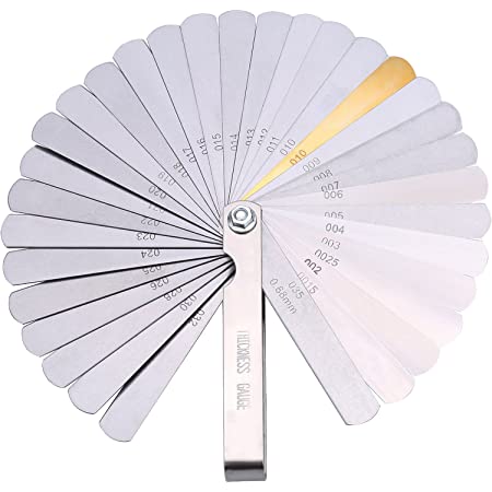

For scopes, I just stack business cards between the scope and base. It gets the scope plenty level enough. Snug up the rings, pull out a card, snug a little more, then pull out the cards and torque the screws.

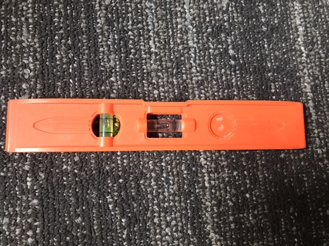

That said any of those super small differences won’t mean anything. Level the rifle rail, mount scope level to it and you are fine. Here is my super calibrated leveling device I have used for years to mount many scopes on many rifles.
