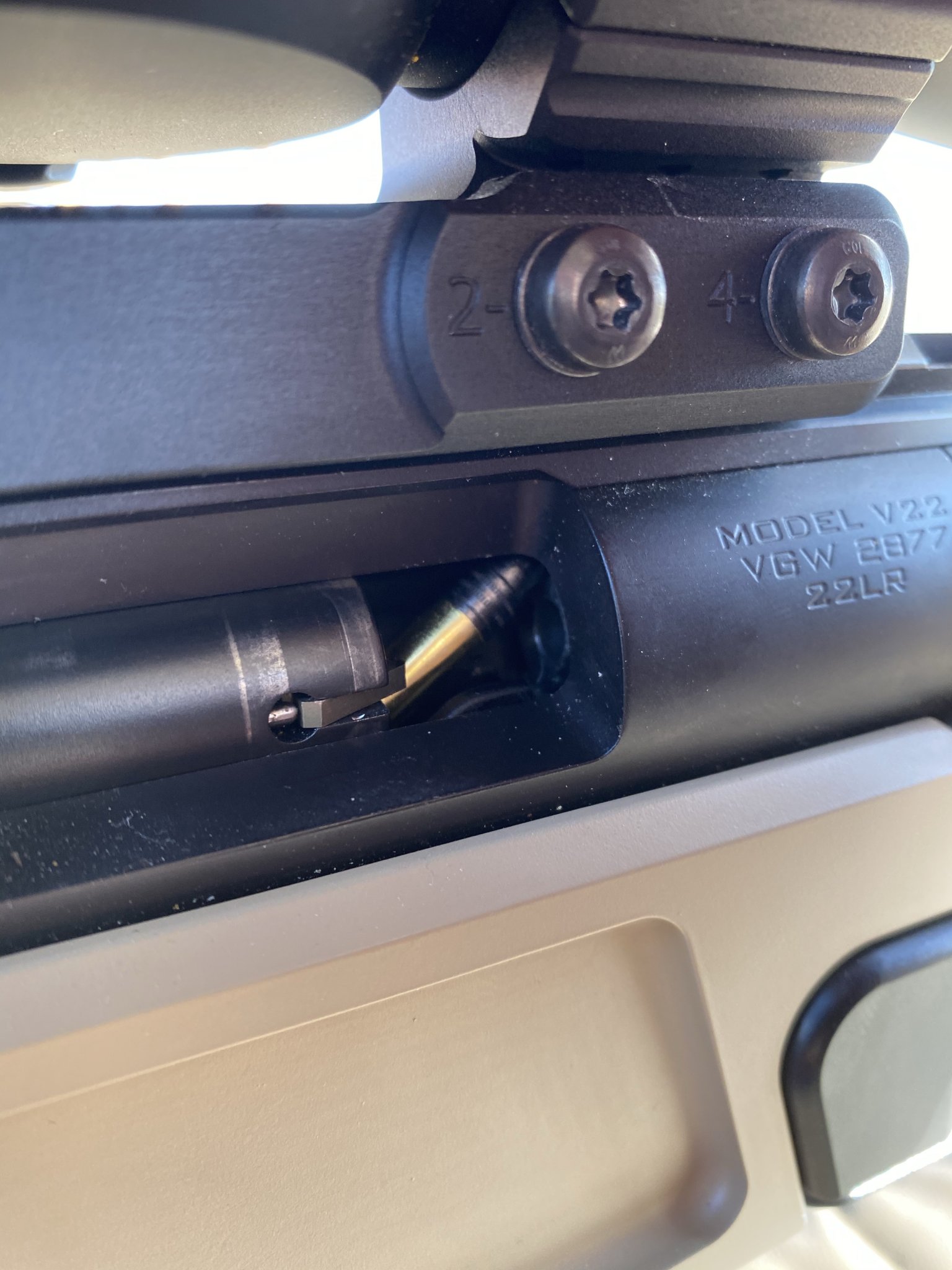

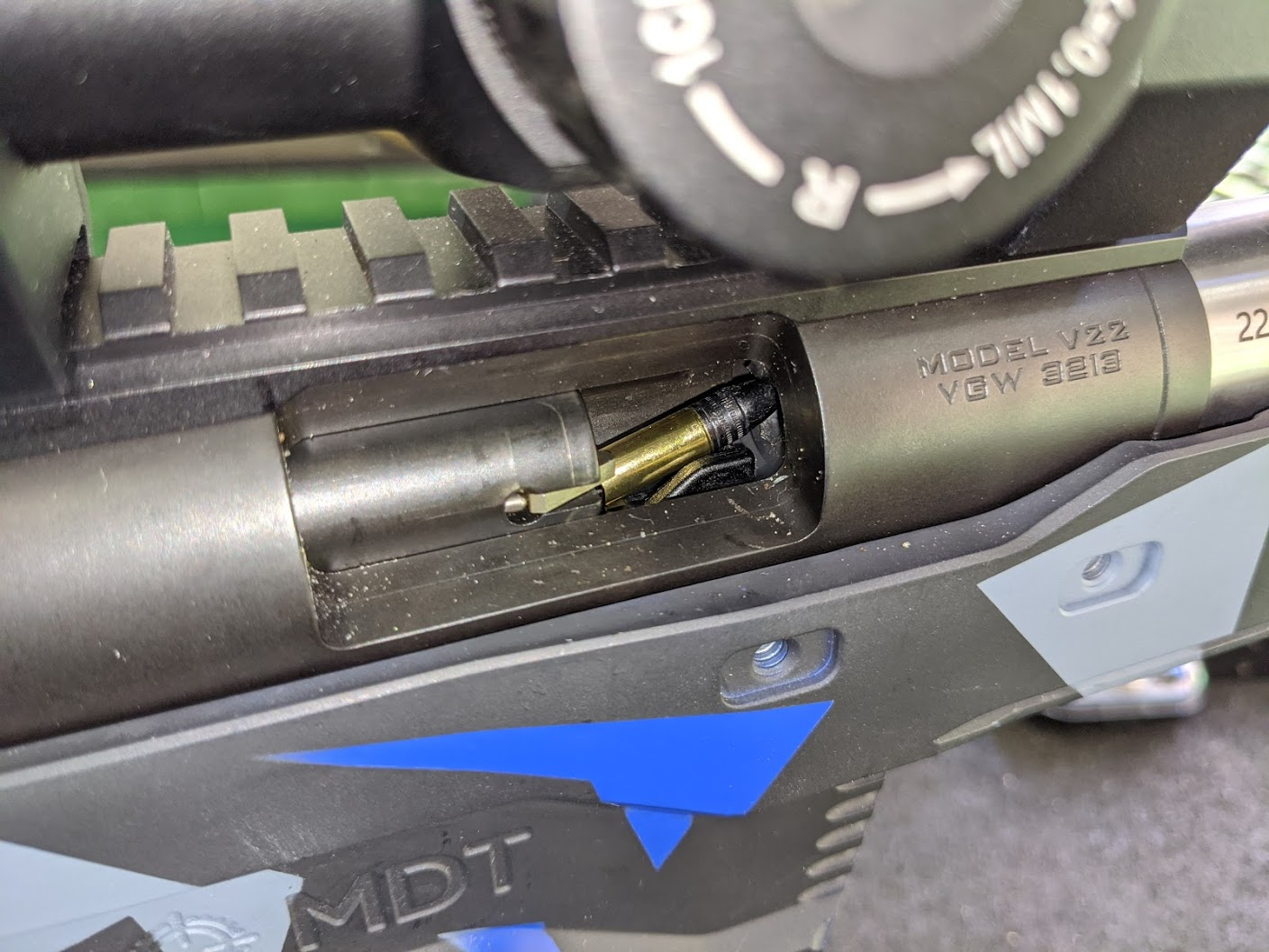

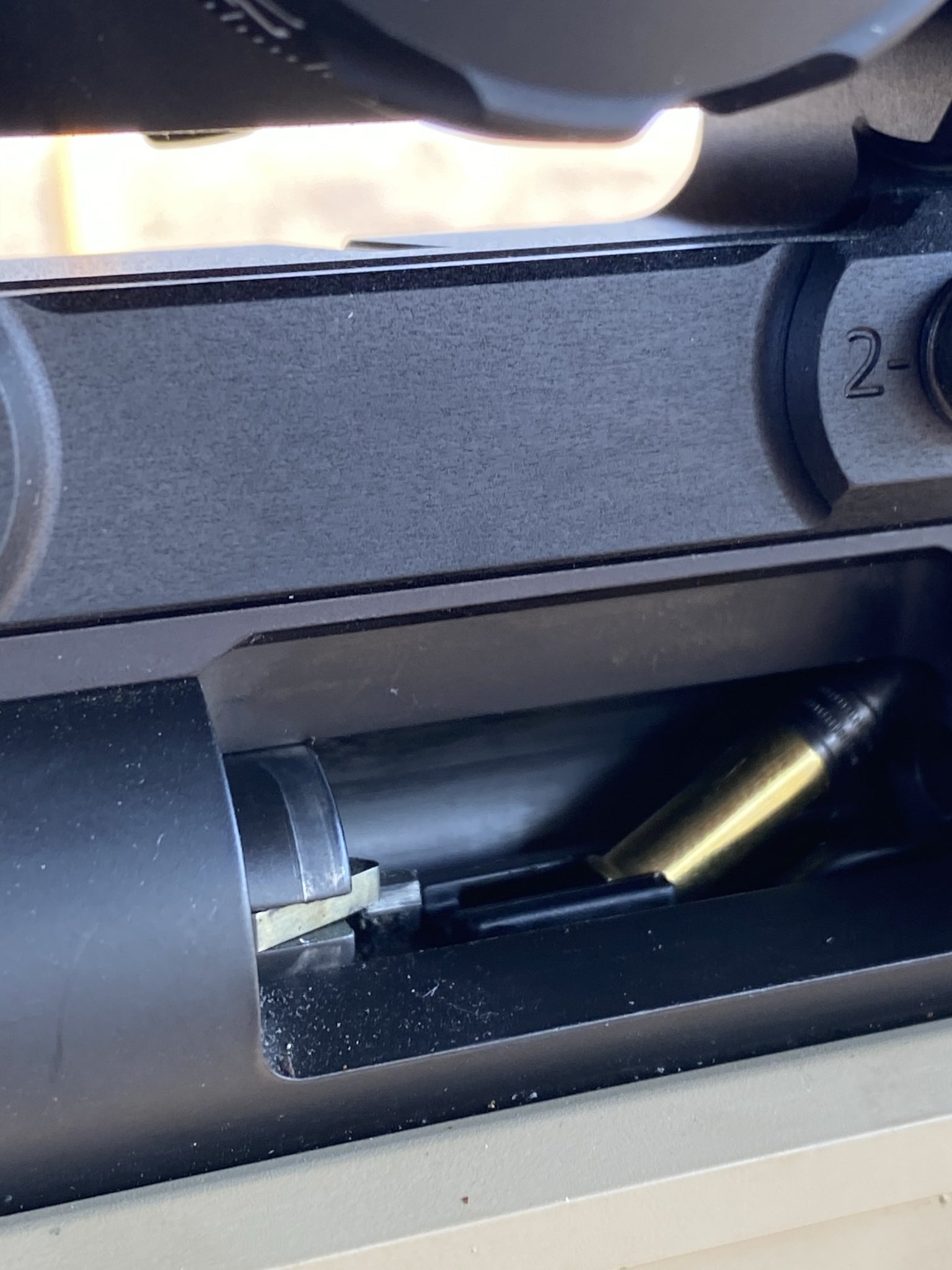

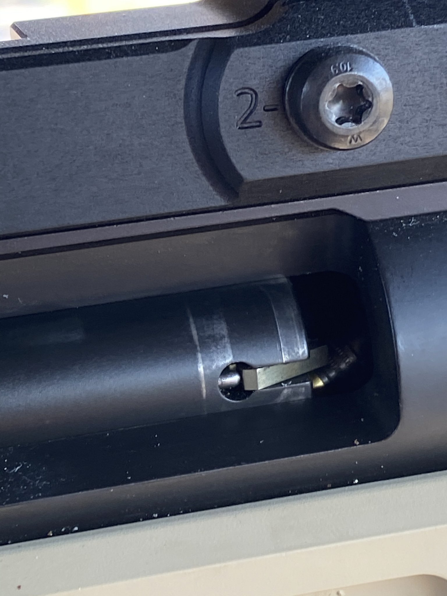

My friend, his friend, and my own all got Vudoo's in March 320x serial #'s and the polymer magazine we got had issues. Does it look like this?
Reactions: Kevin1
So you got your Vudoo when I got mine. Yes if you're having issues with your Vudoo feeding it is most likley due to the polymer magazine batch. There was an issue with the factory that made a batch of magazines where the mold got mucked with. @RAVAGE88
Yup, that looks exactly like that. To clear the round, you can't just pull the bolt back. You have to remove the mag and then manually remove the round. Mine is a 31XX number and is pretty close to yours.
Reactions: littlepod
Yep pulling back does not work. Have to drop mag to get it cleared. If you know anyone with an older mag (year+ old) borrow it and you shouldn't have any problems. I got lucky and bought a used mag from a friend, and his was flawless through my rifle but my new one was having issues which is why I diagnosed it as a mag issue.
