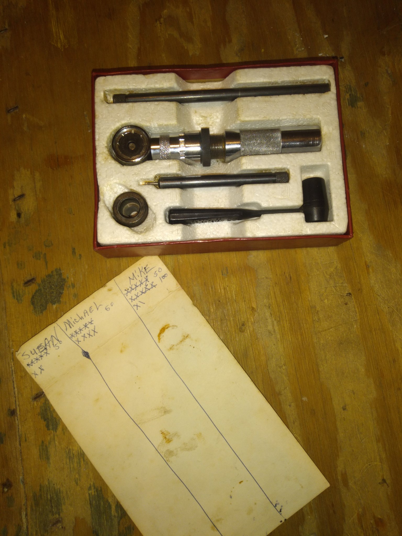

    So i was at my dads house the other day knocking back a few cold ones and he gets this look and says he has something for me. He comes back with a lee classic loader for 30-06 lol. As a kid my local gunshop sold these used for like 3 or 5 bucks apeice and i had all kinds... they fascinated me, but i never actually used one.
    This one came complete with susan, michael and mikes last game of what im guessing is dominoes. So its raining and im bored and have a twice fired case. So i load up a round.... and it was pretty fun, i noticed some big differences over this style and the press. First, you are actually hammering the case in the die to get it stuck, then tapping it out. Second, there is no chance of ripping the rim off, or shearing it. I set the height for seating using a made bullet and running it down. Im pretty pleased with the results. Running 48 grains of imr 3031 and 168 grain A max. But im gonna fire 20 new cases and work up a load using this vs a load using the rcbs press and see if the results compare. What got me most was it was something ive done uncountable times and it was brand new...
    Shot a test round and the 3031 seems a bit hot. Flattened the primer some. I have some 4831 im gonna run instead at 56 grains to start and see how that does. May work up a load around it or switch to h414...
    I loaded up 10 rds of the 4831 to test. Not doing a ladder test yet, just middle of the road... more testing how long it took to load up 10 rds with this thing. About 20 mins start to finish. Without annealing the cases this time. I annealed last loading.

    Be real interesting if you have a concentricty gauge! It'd be funny if the sized brass and loaded ammo was dead straight!

    I like to load 20-50 rifle rounds at a time. Usually just 20. I can take them by my dads and chuck them up and put them on a guage and see if there is any runout, we have guages for that. Its an interesting idea. For these longer cases like 30-06 if its as accurate i may just use this style instead of a press to keep from getting stuck cases and sheared rims. Wonder if they make one for 338 lm.... everytime ive had one of those cases get tanked it hurt my feelings....
