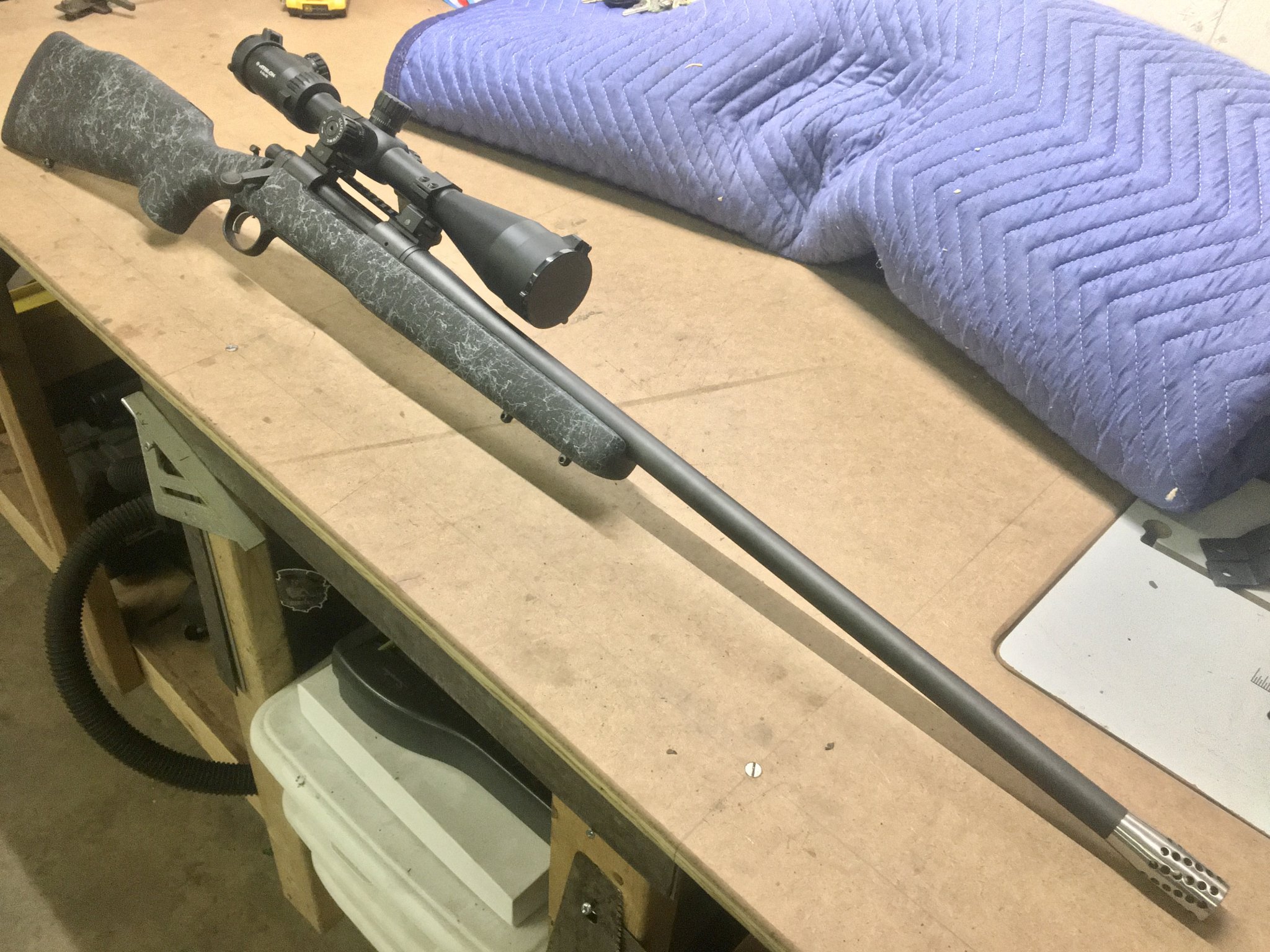

I've got 2 remington rifles. One is in stock configuration. The other has a magpul hunter stock, other than that it is in stock configuration as well. They are also old enough that they don't have that abominable trigger that is supposed to be user adjustable, but isn't. Scape off the goo they put on the screws and you have pull weight, sear engagement, and over travel adjustment at your finger tips. They open while on safe, so no they don't have THAT walker trigger. They are fine for what they were bought for- deer hunting rifles- and if you get a good one with a decent barrel they can be pretty good shooters. Both of mine are MOA with hand loads.
